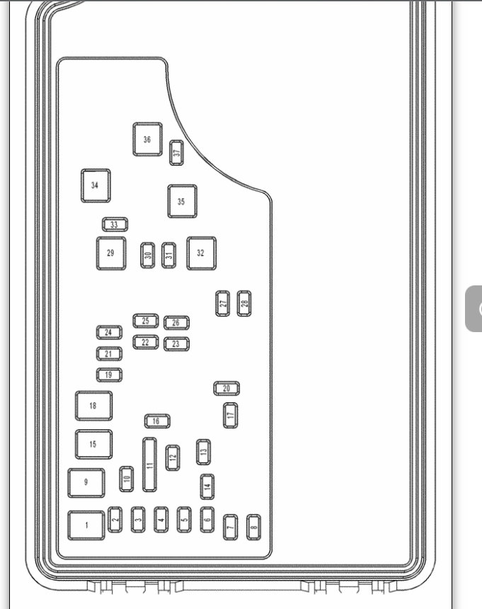

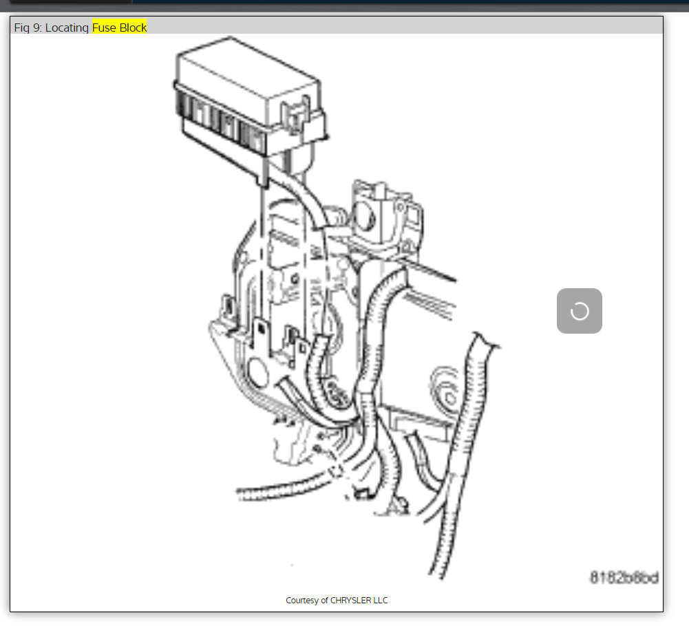

Left font light is not working no power going through I check the only fuse box I could find under the hood I think there is another fuse box some where could you tell me where?

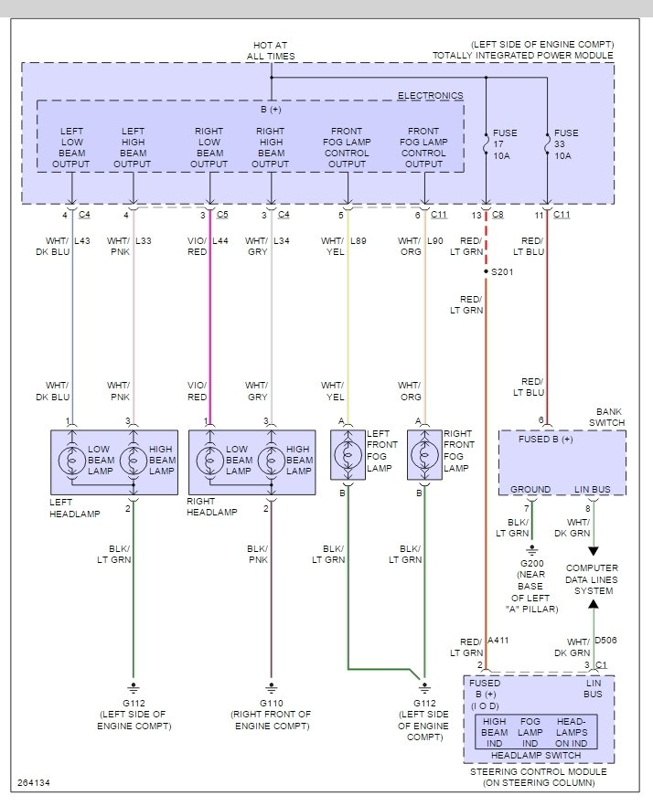

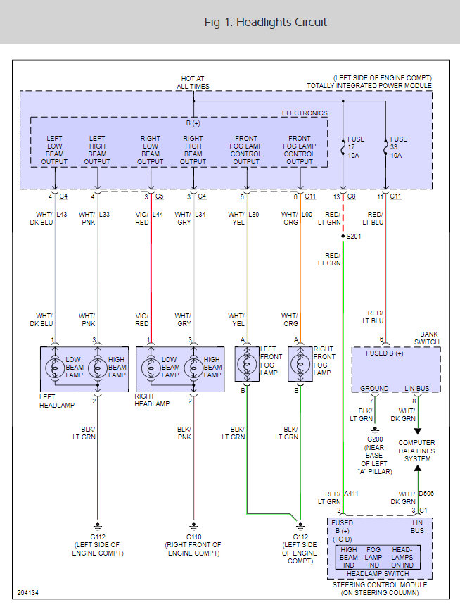

IF YOUR LIGHT WORKS ON HIGH BUT NOT ON LOW, OR VICE VERSA THEN THE PROBLEM IS MOST LIKELY A BAD HEADLIGHT BULB. If that's been ruled out, try this:
Unplug the wire connector at the left headlight assembly.
With the headlights turned ON there should be power on the
WHT/DK BLU wire with the headlights on LOW/DIM.
There should be power on the WHT/PNK wire with the headlights
on HIGH/BRIGHT.
If not, check for power on these same wires (same colors) at the
TOTALLY INTEGRATED POWER MODULE located on the left
side of the engine compartment (fuse box).
If there is power at the totally integrated power module but not at the headlight connector
then there is a open in the wire that powers the light that does not work. You'll have to trace the wire to find the open.
Let me know what you find.

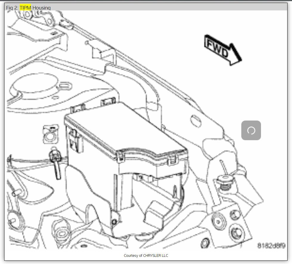

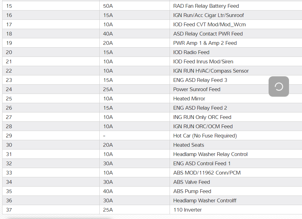

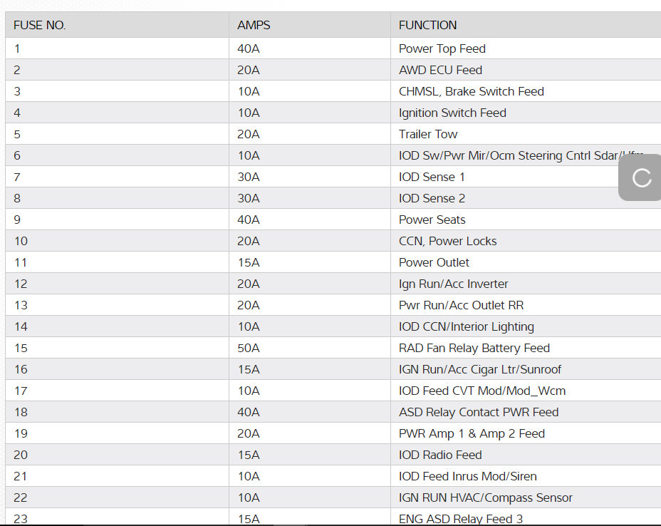

There are 2 fuses that can be out in the TIPM, here is a guide and some diagrams (below) so we can do some tests and see whats wrong.
I have a 2007 Dodge Caliber and I recently took it to the shop because I had a headlight out and the headlight was not blown so i was unlucky. They told me that I had a circuit blown in my fuse box that controls the low beam to my headlight and they would have to replace the whole box and they could not just fix the circuit that had blown. They informed me that the part would be $745.00. I have this question posted at the moment. I am waiting to hear back to see if there is a fuse for you to fix the problem.
Hope this helps you!

DANIEL FARRELL
I had the same problem with the TIPM. The reset did nothing. I cut the sockets off of the harnesses, added three inline fuses, three lighted rocker switches, three relays and ran a circuit for the low beams one for the driving lights and one for the high beams. Easy fix $25.00 (I already had the wire laying around because I am an electrician). Now I never have to worry about the lighting system circuit in the TIPM going bad again. PS. Do not pull the fuse for the headlights because the power source for the wipers comes from this circuit.
+1
Thursday, October 15th, 2020 AT 11:02 AM (Merged)

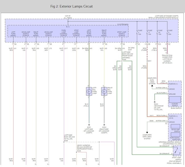

OLIVIER PANI
Hi Daniel Farrel. Can I please have the schematic of how you set up your system for it to work?
Thanks

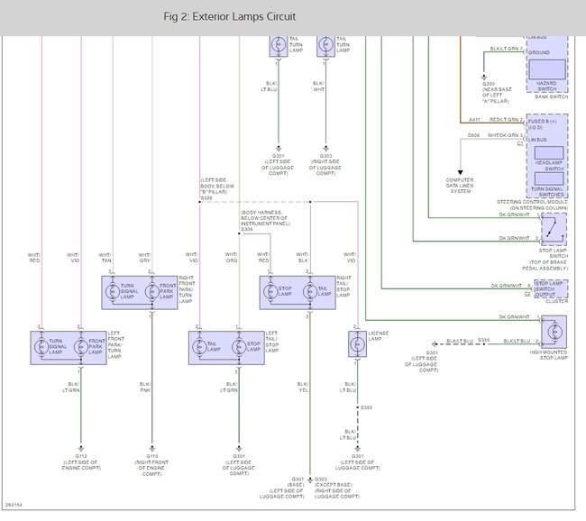

KEN L
  • MASTER CERTIFIED MECHANIC
  • 55,335 POSTS
Hey Olivier,
I have found these wiring diagrams for you, You will need to wiring in a relay which I have included the guide for. Please let me know how I can help you further.
This guide tells you what part of the relay to wire for the headlights and which to wire from the switch.
Please let us know happens so it will help others.
Best, Ken

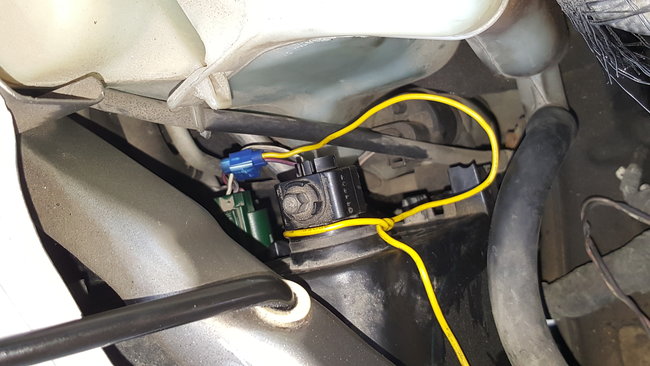

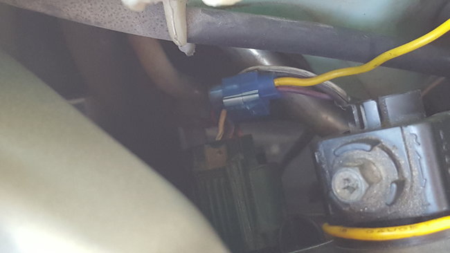

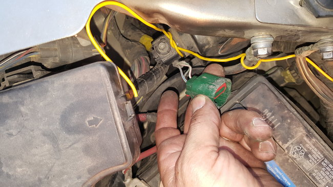

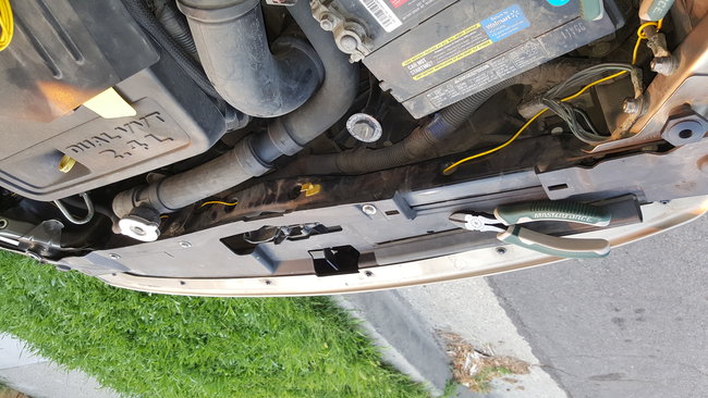

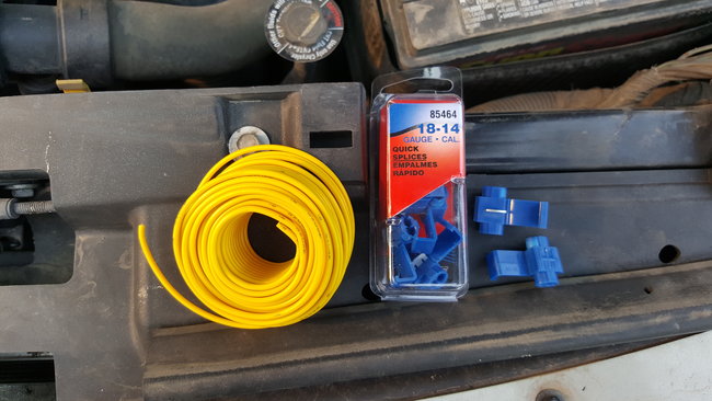

My 2007 Caliber was having the same problem as described. The passenger side headlight low-beam did not work despite changing the bulb. I first tried the OBD reset, but a) I didn't have any error codes, and b) it didn't fix my problem.
After another internet search and a couple YouTube videos later, I fixed the problem in about 30 - 45 minutes by running a jumper wire from the driver's side low-beam wire to the passenger side low-beam wire.
Things you need to know:
1) make sure it's not just a bad bulb
2) the passenger side bulb is a bee-awch to work on. The coolant reserve tank and windshield fluid tank are right in the way. The driver's side is much easier, but you have to remove the fresh air cover which is easy-peasy.
3) you'll need to buy some 18G wire and some quick splices to make this go smoothly. AutoZone had what I needed for about $10.
4) you HAVE TO KNOW what wires to splice/jump together. A) The driver's side wire is white with a blue stripe. B) The passenger side wire is violet/purple with a red stripe. Regardless of whether it's the driver's side or passenger side low-beam that's not working, you will be splicing/jumping these two wires.
You'll need wire cutters and needle-nose pliers. Thread the 18G through the front of the car. I tied off the ends to better secure the wire. I found taking the bulbs out massage working on all the wires much easier. (I tried both leaving them in and taking them out) Take you time to ensure that the jumper wire and low-beam wires are secure in the Easy Splices. You really only get 1 good shot at it.
Once your done, test it the lights! Hopefully everything works like mine did.
