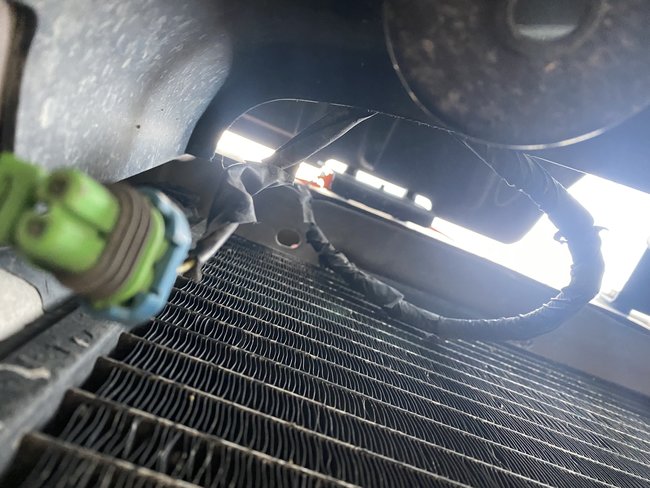

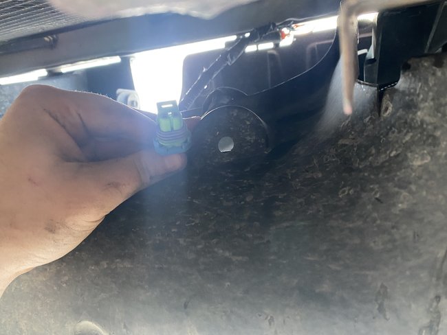

So not sure if you’d have a clue as to why this is for but was changing out some radiator hose clamps and found this connected dangling down looks like a light bulb connector, but nothing is missing a plug it’s also either wired in or tied into the same harness that runs through the front bumper that connects to the airbag sensors on the front. Only odd thing I have seen or if you know if a trailer plug could be causing these issues because I noticed my car has one hooked up.
Wednesday, October 6th, 2021 AT 2:05 PM
  • 110,192 POSTS
The trailer wiring certainly could be causing issues. I don't believe this vehicle came with one from the factory. So, someone must have added it.
As far as the plug in the pic, can you tell me what color the wires are going to it? Also, are there two wires?
Let me know,
Wednesday, October 6th, 2021 AT 7:15 PM
ASTRORIP
  • 28 POSTS
From what I could see one is definitely yellow the other one might be black. I’d have to take another look to confirm but should only be two wires.
Wednesday, October 6th, 2021 AT 7:16 PM
ASTRORIP
  • 28 POSTS
And just did some looking and my bad not a trailer cable it’s just the block heater cord that runs across the whole engine looked different at first.

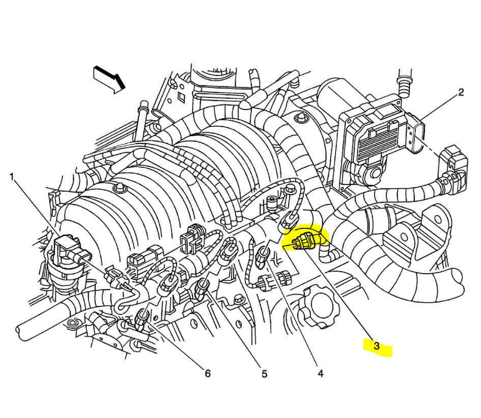

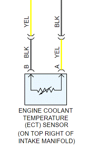

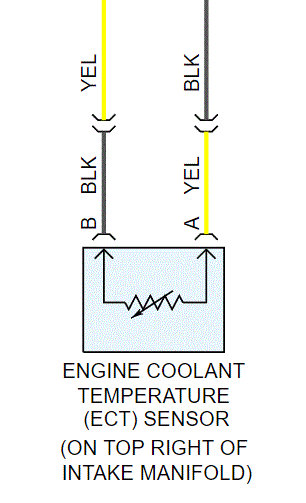

Confirm the wires are solid yellow and solid black. I looked through everything I could find and the only two-pin connector with a yellow and a black wire is the engine coolant temperature sensor. I attached two pics below. One shows the wiring to the sensor, and one shows the coolant temperature sensor location.
See if that helps.
Wednesday, October 6th, 2021 AT 7:41 PM
ASTRORIP
  • 28 POSTS
Okay, it is solid yellow and green with black stripe.
Wednesday, October 6th, 2021 AT 7:45 PM
  • 110,192 POSTS
I went through every schematic I can find and there are several green with a white stripe, but I can't find any that green with a black stripe.
Are you certain that is the color?
Thursday, October 7th, 2021 AT 3:24 PM
ASTRORIP
  • 28 POSTS
Yes, definitely the color which makes me think it’s not factory wiring, and the previous owner must have done some wiring into the loom themselves.
Thursday, October 7th, 2021 AT 3:29 PM
  • 110,192 POSTS
The only green with a black tracer that I was able is for the ambient light sensor, which shouldn't be in that location.
