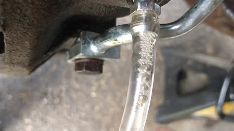

  • 112 POSTS

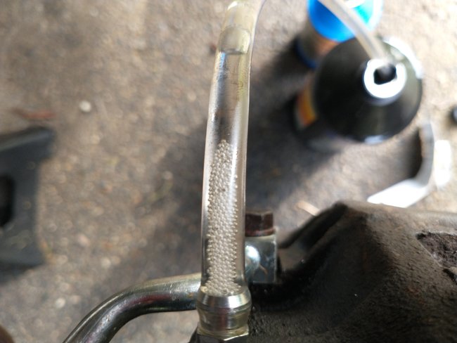

Hi Joe. Just to keep you up to date. Today I replaced the bleeder screws on both front calipers because they had become rounded. I did make sure the pedal was pressed to the floor before replacing the screws.
That being said I've attempted again to bleed the front brakes and all that happens is what you will see in the video I've included. I continually topped the master cylinder off with close to 24 ounces of DOT3 before I tightened the bleeder screw. 24 ounces is enough to fill the entire line plus some, yet all it did for 20 minutes straight is what you see in the video. I did, once again check for leaks and couldn't find any. I just cannot comprehend any way that much air could be in that one line.
Thursday, August 26th, 2021 AT 2:17 PM

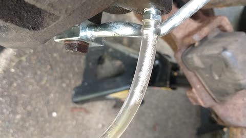

SWILSON3828
  • 112 POSTS
Sorry, not sure why that video I initially uploaded is playing like it is. Here is a better video for you:
Thursday, August 26th, 2021 AT 2:38 PM
SWILSON3828
  • 112 POSTS
Here is a picture since the videos aren't showing properly:
Thursday, August 26th, 2021 AT 2:51 PM

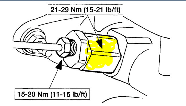

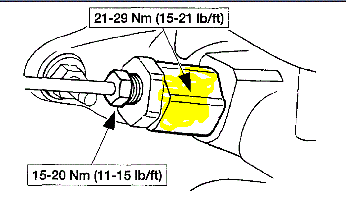

  • 110,194 POSTS
When you tell me the one caliper's pistons come out slow, that sounds like either a pressure issue or a bad caliper.
Was there any change when you installed the new master cylinder? Is the brake master cylinder fluid control valve still installed?
See pic below.
+1
Friday, August 27th, 2021 AT 7:45 PM

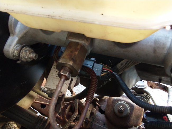

SWILSON3828
  • 112 POSTS
Good morning.

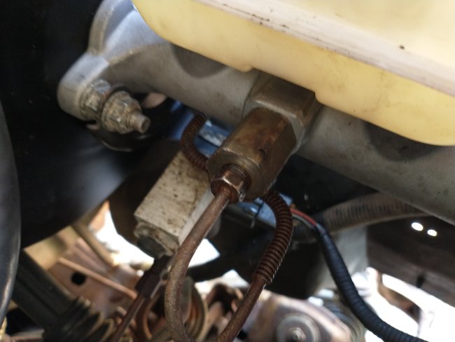

No, no change at all with the new master cylinder installed. Pressure builds when engine is off, but pedal straight to the floor when engine is running. I do think the front calipers are working properly now since I replaced the left front caliper. System was re-bled per rear wheel ABS instructions. Yes, the FPV is installed. Also, I noticed there was some sort of hydraulic mechanism that sits right under the master cylinder and is actually attached, along with the master cylinder to the two bolts that attach the MN to the BB. Is that the ABS hydraulic mechanism? Thanks
Saturday, August 28th, 2021 AT 8:27 AM

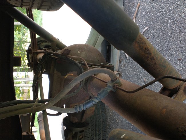

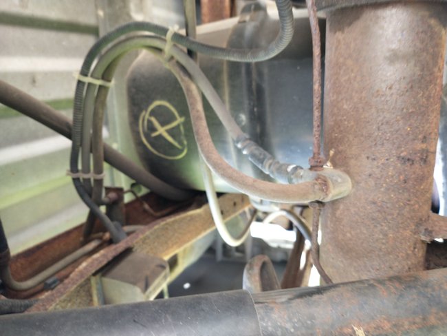

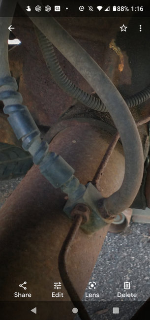

SWILSON3828
  • 112 POSTS
Also, I know you said the ABS module for my truck is behind the glove box, but I can tell you I've looked and looked and looked some more and do not see any type of brake line coming from anywhere other than the master cylinder and the contraption underneath it that I mentioned in the previous message. I have searched the entire vehicle for the brake lines coming off the ABS pump and I see none anywhere. Noe under the hood, and none underneath the truck in the front or back. Now I do know that this was a wrecked vehicle when I bought it in 1998 so I'm not sure if there was anything changed on it or not because I've never needed to do anything with the brakes other than changing the pads and shoes. On none of the wheels is there an additional line going to the back of the wheel that you would normally see with ABS. The only lines are the brake lines going to the front wheels, and the brakes lines and parking brake cable going to both rear wheels. There is a contraption that is sitting to the left of the hogs head that has both rear brake lines running from it and what appears to be electrical connections coming from it, so this may be associated with the rear ABS, but I'm not certain. I do know the ABS light is flashing rapidly, but that could be because there is an issue with the braking system itself, and there have been a couple of times where I've brakes a little hard and felt what feels like the abs kicking in. Not sure if it being a 4WD manual trans has any bearing on the issue. I've included a two pics to explain what I'm talking about. Thanks
Saturday, August 28th, 2021 AT 10:23 AM
SWILSON3828
  • 112 POSTS
Also wanted to include these images of the master cylinder, along with the contraption underneath it.
Saturday, August 28th, 2021 AT 12:04 PM

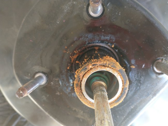

Thought I would share this photo with you of the old BB.
Monday, August 30th, 2021 AT 6:48 PM
  • 110,194 POSTS
That doesn't look too healthy. LOL Did you have any issues replacing it?
Monday, August 30th, 2021 AT 8:35 PM
SWILSON3828
  • 112 POSTS
Haha. A ring of pure rust that looked like a huge washer fell off when I pulled it out, but no, no problems replacing it at all. A very easy repair.

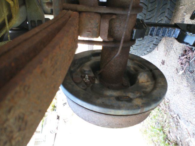

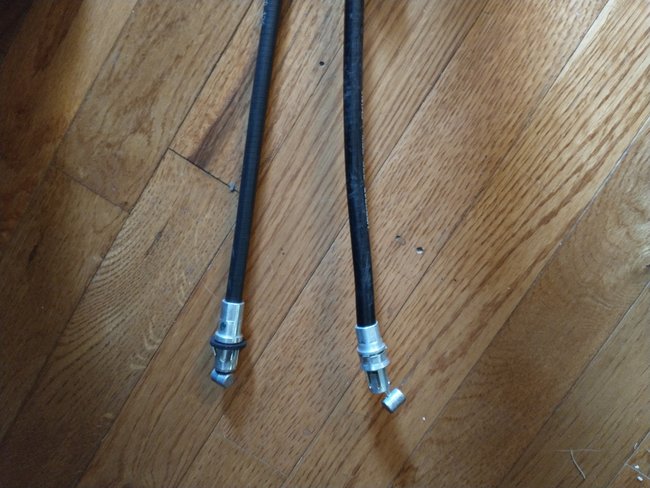

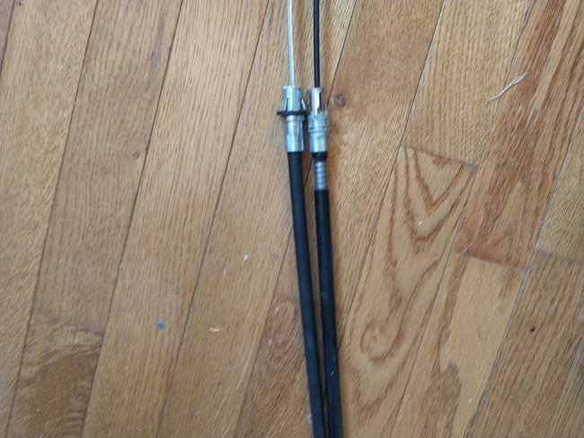

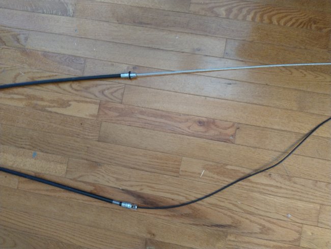

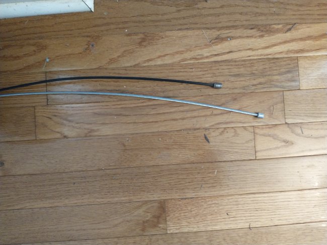

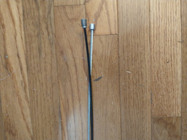

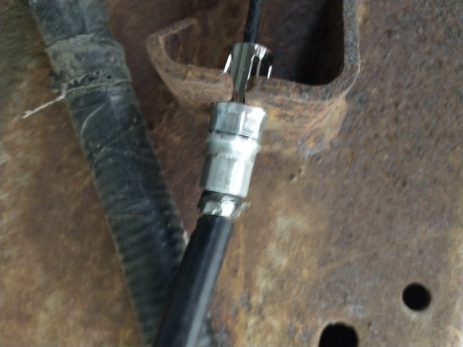

Now, as far as the parking brake cable goes. I'd hoped the first cable was just a wrong part sold by accident, but the new cable I just got is identical in length as far as the cable and the shroud are concerned. Not exactly sure how it make it fit as there really isn't anything different I would or could do compared to the first time. I'd hoped the new cable would be about an inch longer, but no luck.
Thursday, September 2nd, 2021 AT 5:04 PM
  • 110,194 POSTS
By any chance, have you confirmed that the part number of the product crosses to the OEM part number I provided? Also, is it the same brand as the first one?
