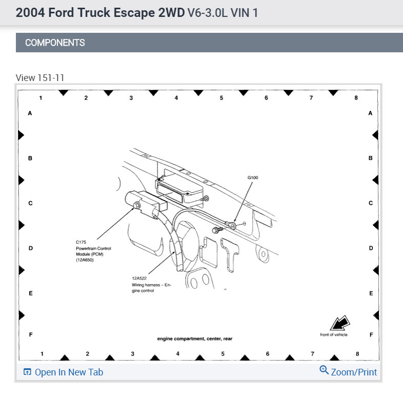

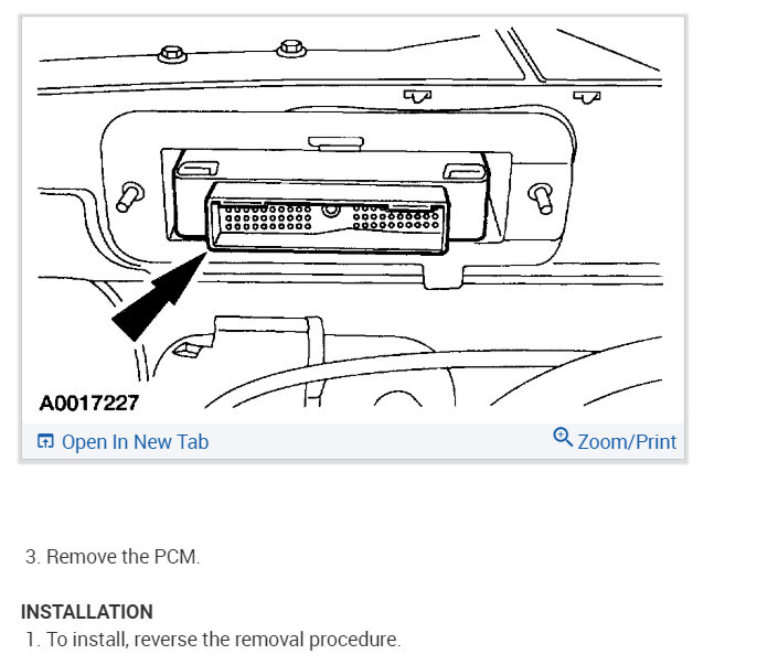

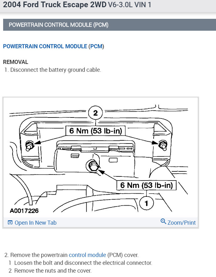

Codes P2195 and P2197
KEN L
  • MASTER CERTIFIED MECHANIC
  • 55,266 POSTS
If fuel pressure is okay and you have a new MAF and the engine runs okay you have a bad PCM I would try getting a rebuilt/used one and plug it in to see what happens. Here is the location you might need it to be programmed if you get a used one.
