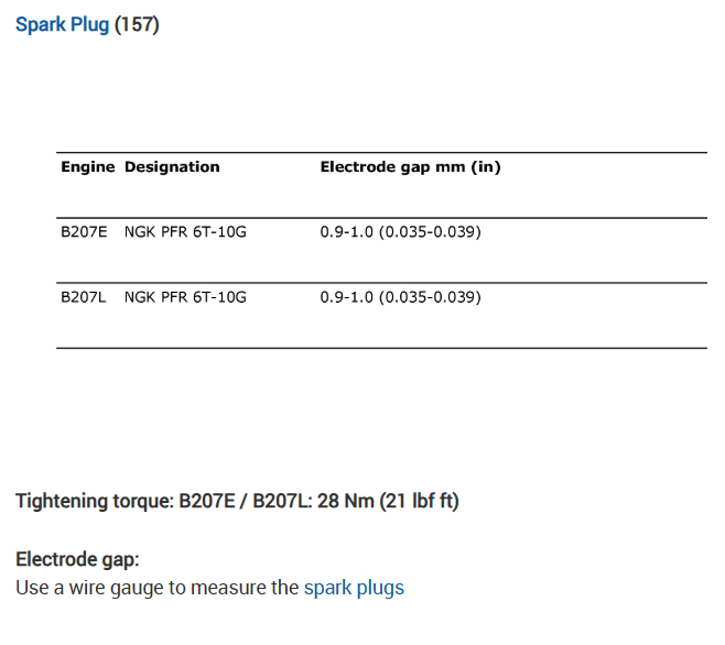

The P1301 code is related to Ignition Coil #1 Open Circuit or Short to B+. This code generally indicates a misfire or ignition-related issue.

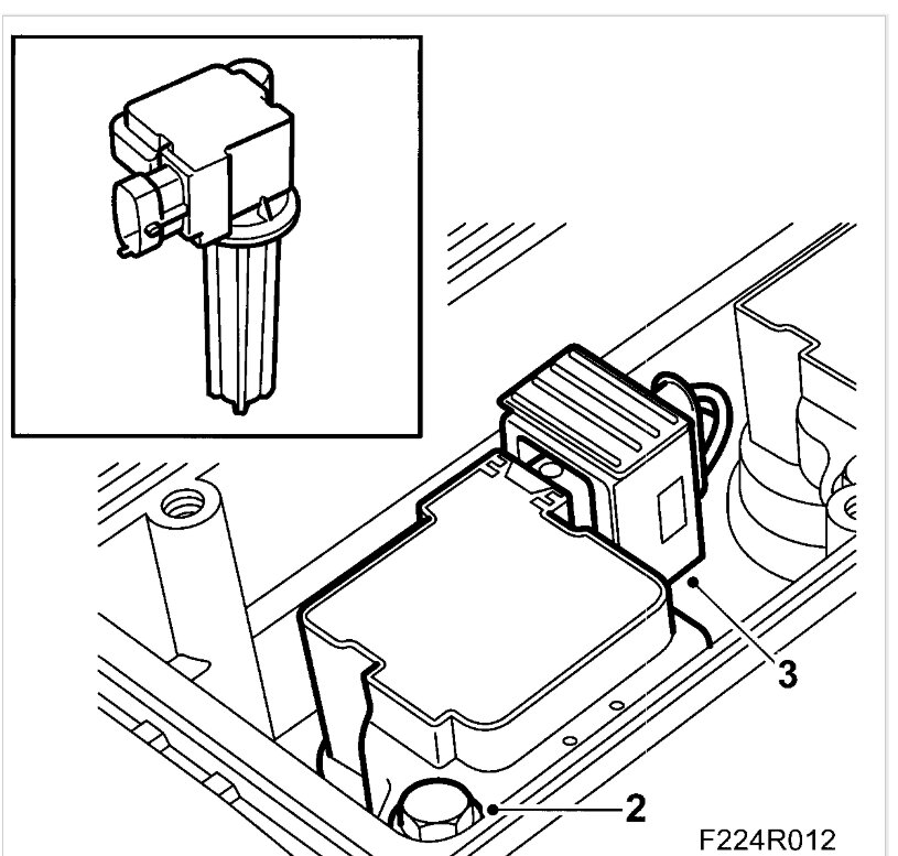

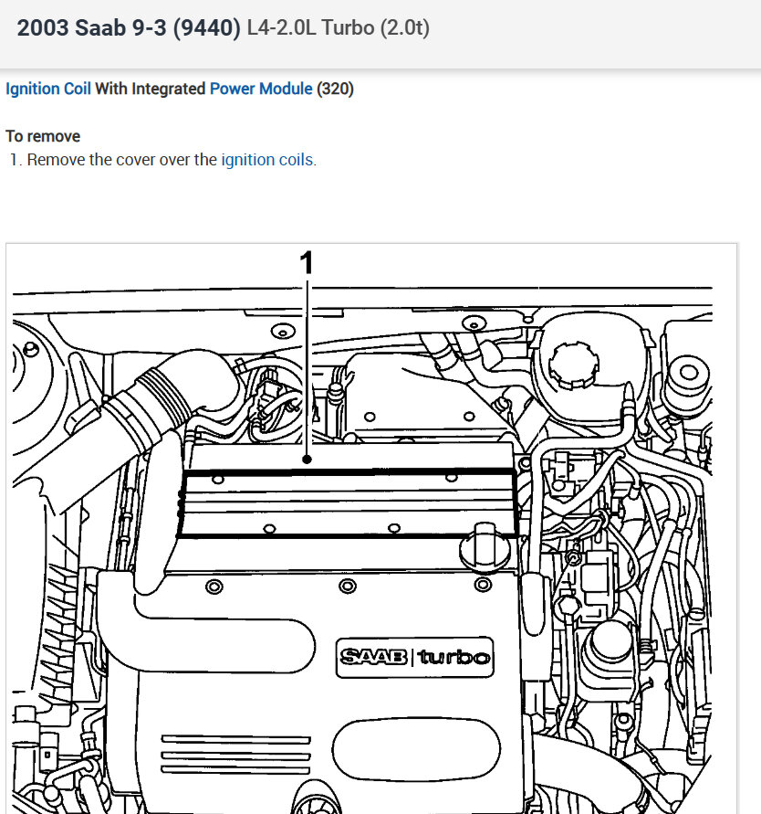

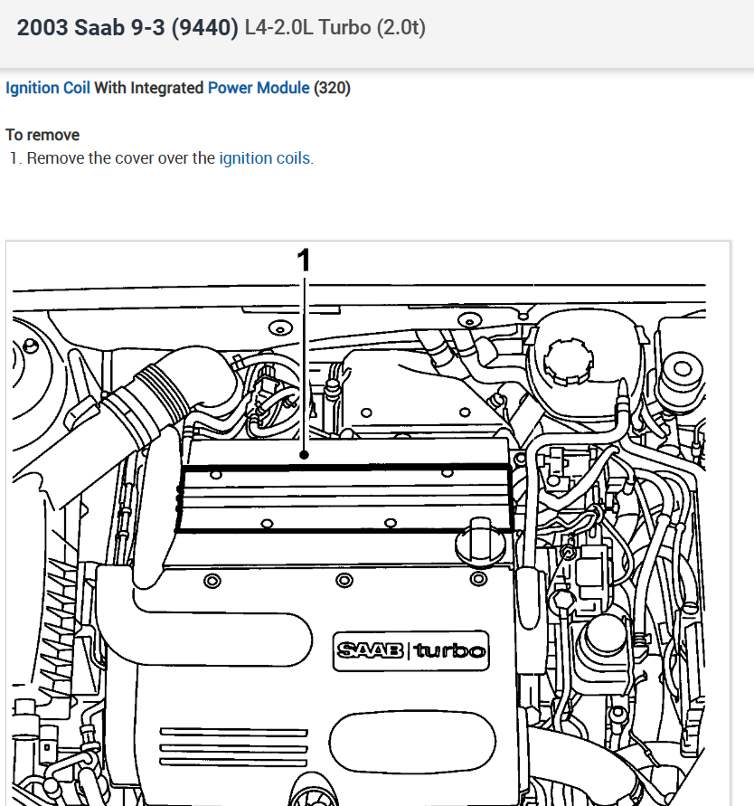

So, I would replace the spark plugs and coils for all four cylinders if it passes the compression test which this guide can help with:
Here is how to change the coils out with the spark plugs. Clear the codes once completed. Check out the images (below). Please let us know what happens.

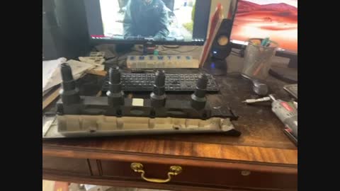

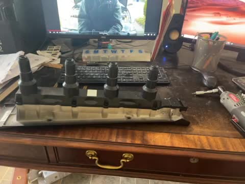

Okay I checked the compression dry and wet, solid readings. Switched out the plugs. Here’s my question: do I need to replace the entire DIC? Attached is a video of the part.
Mar 10, 2025 at 9:00 AM
  • 54,503 POSTS
Yep, the DIC has a high failure rate and is a common replacement. Let, me know how it goes please. Clear the codes once completed.

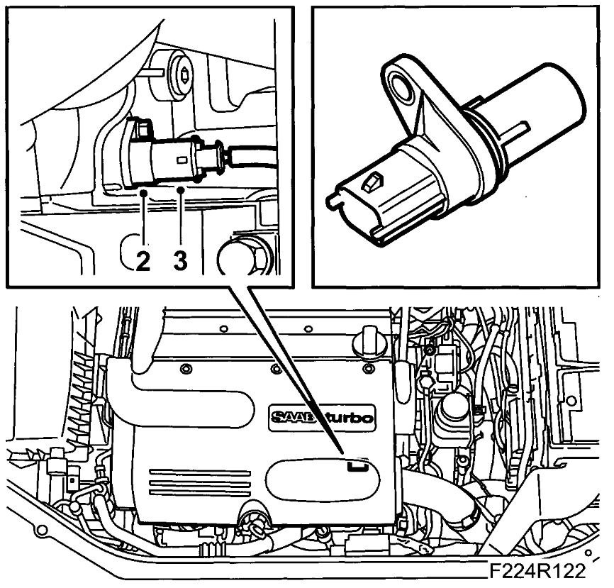

Hmm, yep, maybe the sensor is weak, and it causes false codes, here is the location of the sensor. Be sure to clear the codes once completed. Check out the images (below).
