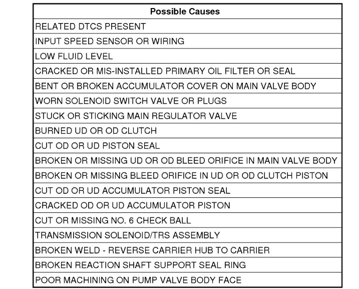

I think my vehicle went into limp mode.
The check engine light was on with p0733 code. I cleared it and it has not come back on.
We changed the oil, but realized we had the wrong filter so put old one back on.
Drove it fine for two days.
Filled gas tank up and immediately check engine light turned on and it started to shift hard between second and third.
I drove about thirty five miles, then parked at home.
Next morning had my husband change front caliper as I was told it needed replaced due to sticking and bad gas mileage.
We loaded up the vehicle to head to Missouri for Thanksgiving and could not get it to shift.
I can put it in drive but it will not go out of first. If I shift manually (I have the +/- on my gear shift allows me to shift gears manually) I can get to third gear about forty five mph. It is chirping/squeaking from passenger rear side. It feels unstable when driving, like brakes are locked but no ABS lights or codes.
We changed coolant temperature sensor and thermostat. Alternator was tested as was battery. I got a new oil filter and changed it. Transmission fluid is good. Added coolant.
Any suggestions?

Good morning,
It sounds like you have an internal issue with the transmission. I attached possible causes below as well as a flow chart that someone needs to follow to find the failure.
Most of the time, gear ratio codes are internal failures in the transmission.
Here is an article on transmission issues:
P0733-Gear ratio error in third

17. LIST OF POSSIBLE CAUSES
If any other DTCs set during the road test, refer to the appropriate procedure in the Transmission category.
If no other DTCs set during the road test, below is a list of possible causes, but not strictly limited to those.
Check for:
- Excessive debris in the Transmission Oil pan, plugged, cracked, or mis-installed Primary Transmission Oil Filter and/or seal.
- Cut or missing No. 6 check ball in the main valve body.
- OD and UD accumulator pistons and seals and bleed orifices, and the Solenoid Switch Valve and Plugs in the main valve body.
- OD and UD clutch piston seals, reaction shaft support seal rings and dribbler assemblies, and the flatness of the pump valve body and pump housing faces.
- Main regulator valve for sticking in its bore.

Nov 30, 2018 at 11:57 AM
No, nothing to do with the ABS. I suggest you change the brake hose on the side you replaced the caliper. It sounds like it is still sticking.
Nov 30, 2018 at 12:00 PM
