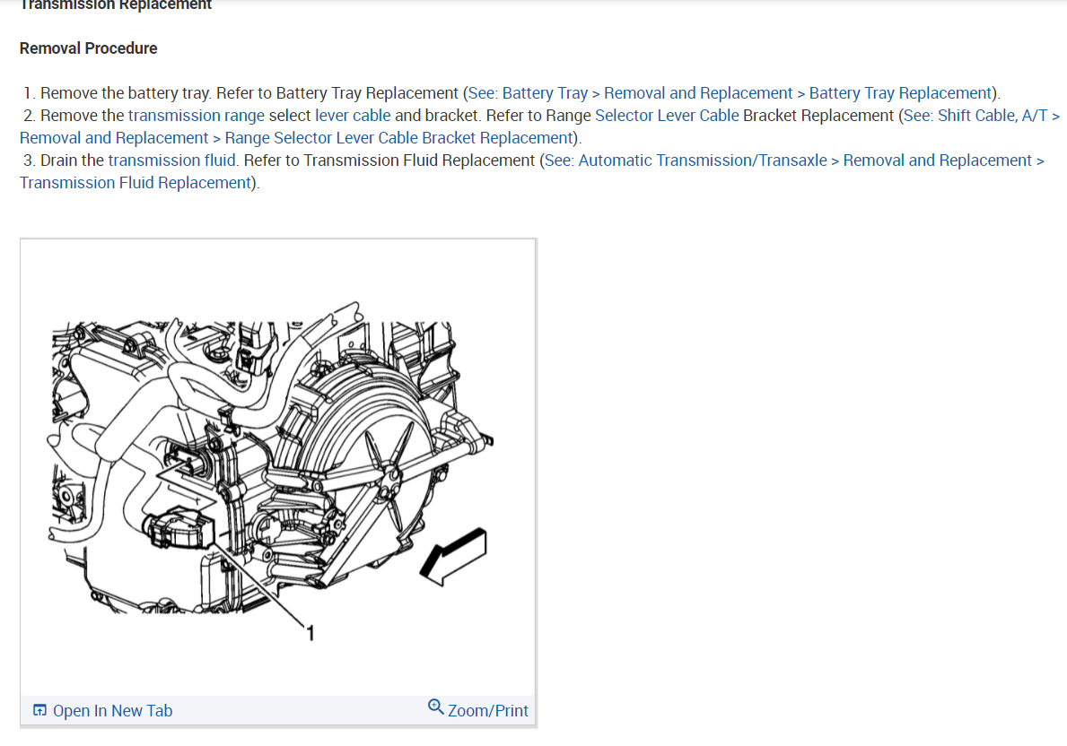

Codes P0700 and P0752

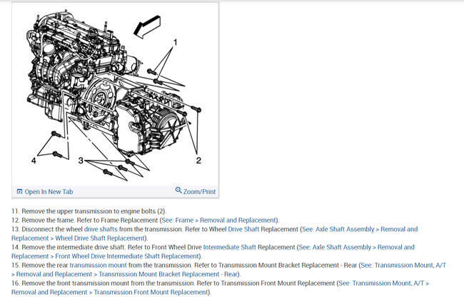

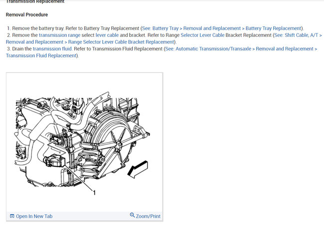

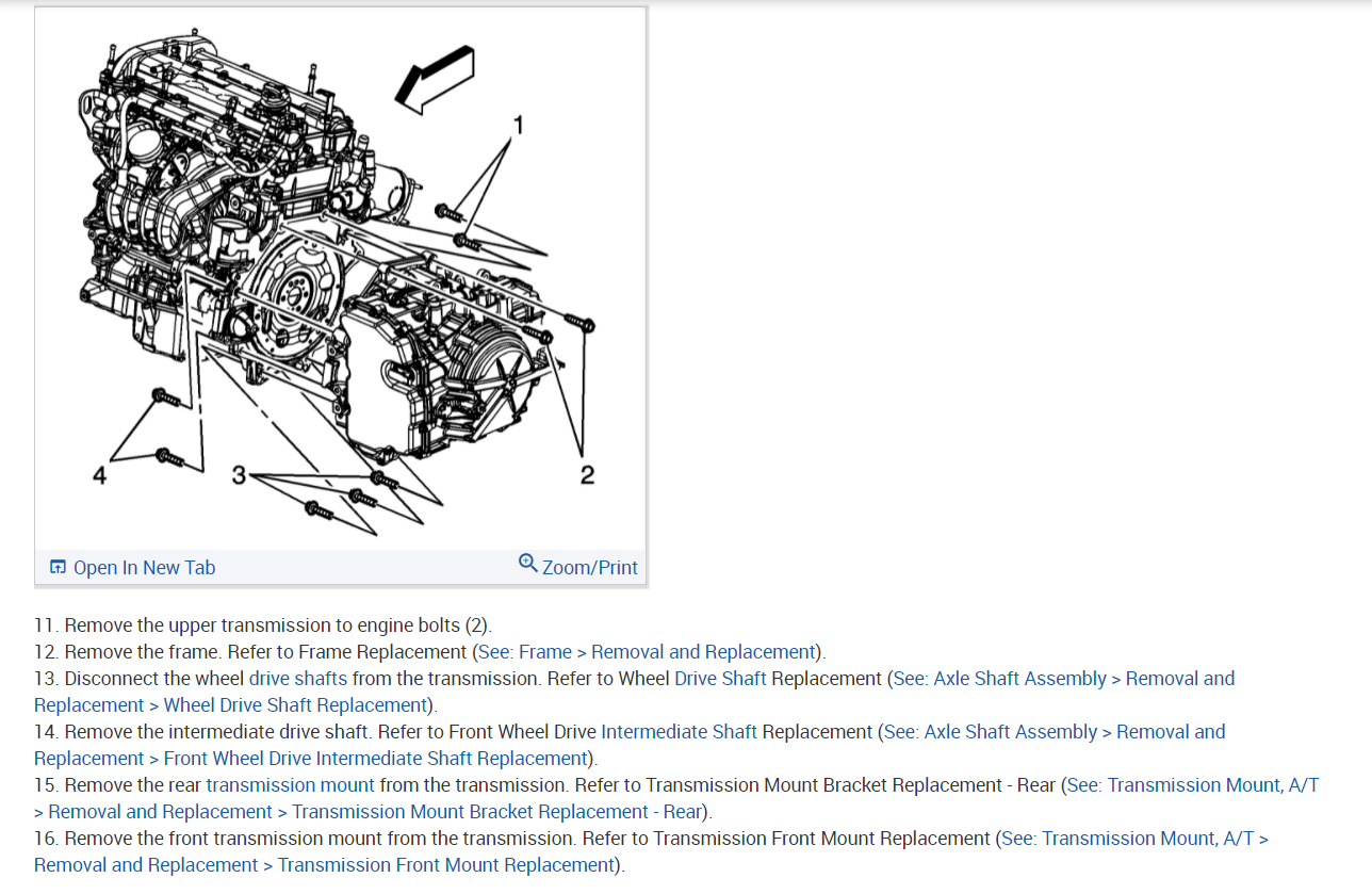

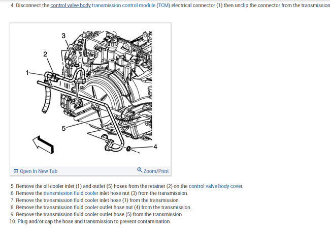

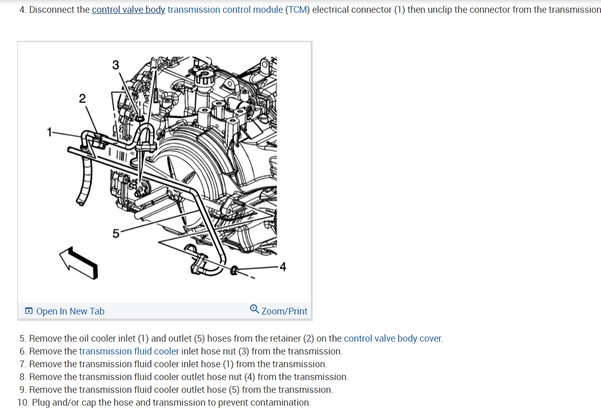

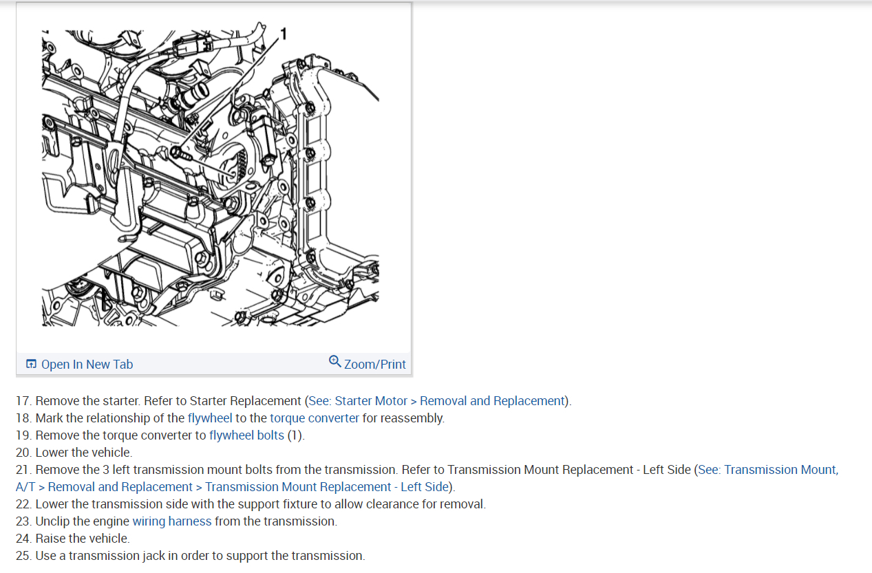

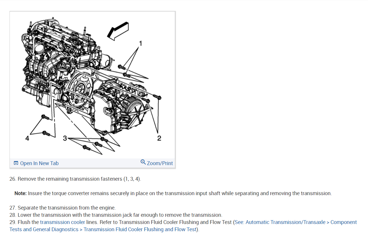

I attached the procedure for you for the removal of the transmission. The book pays 10 hours which means it will take you at least 2 times that.
No, it does not say to drop the subframe at all.
