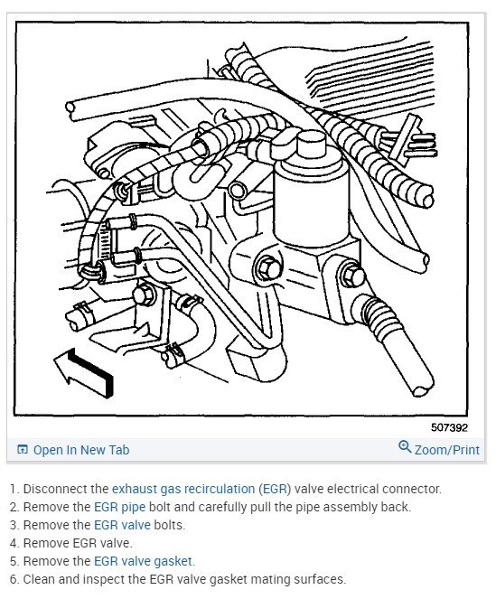

Okay, a P0300 is a random multiple misfire. So, it is something that affects more than a single cylinder. The first thing would be to look at the live misfire data and see which cylinders are showing misfires. Then think about which items affect those cylinders. 99% of the time it won't be plugs or wires (unless something damaged them like oil leaks or rodent damage) If the vehicle has a single coil that could affect it, as could a bad twin output coil if the misfires were on the cylinders thar coil served. Not likely injector related unless it is something affecting all of them, a single injector would instead set a P0301-P0312 single cylinder misfire.
Most of the time it will be caused by either a fuel supply problem like low or very high pressure. Or some type of air intake issue like a manifold gasket or vacuum leak or another system that allows air into the system. In your case the EGR is possible and likely given the symptoms you state, plus they like to fail and usually stick open. The easy way to test them is using a scan tool to open/close it and see what effect it has and if it actually does work. For the average DIYer that can be difficult as most don't have a scan tool that has bi-directional controls to do that. Without that swapping the EGR is about the only test you have as it is a PWM controlled item with position feedback that isn't easy to monitor without a scope. Attached are the directions to change it. If you wanted to see if it was the issue there is a test you could try, unbolt the EGR and use some thick foil to block the port and bolt it back on. If the problem goes away, you have an answer. Just don't drive it that way or it will cause problems.

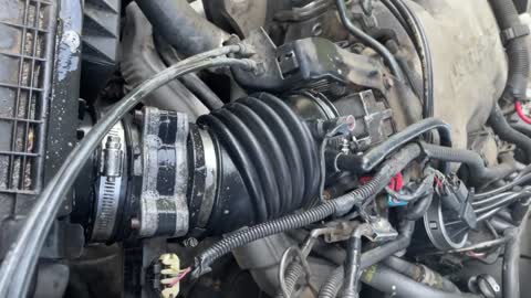

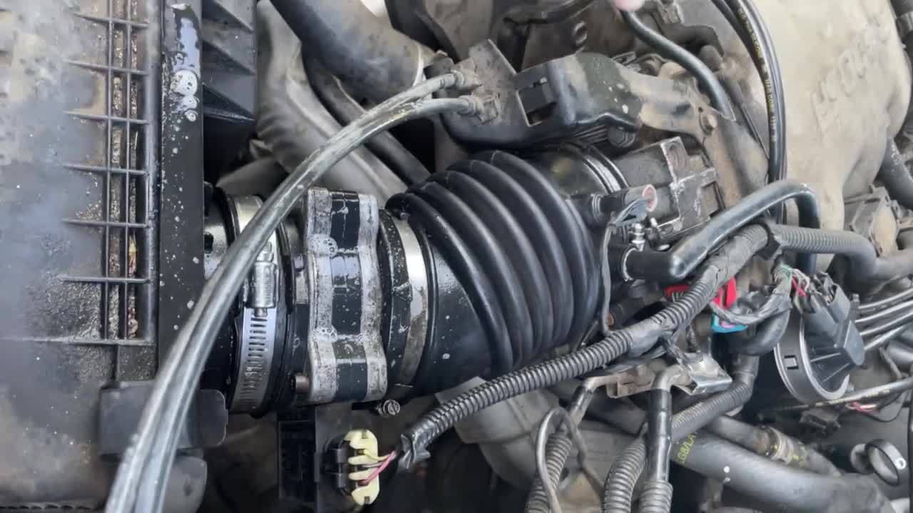

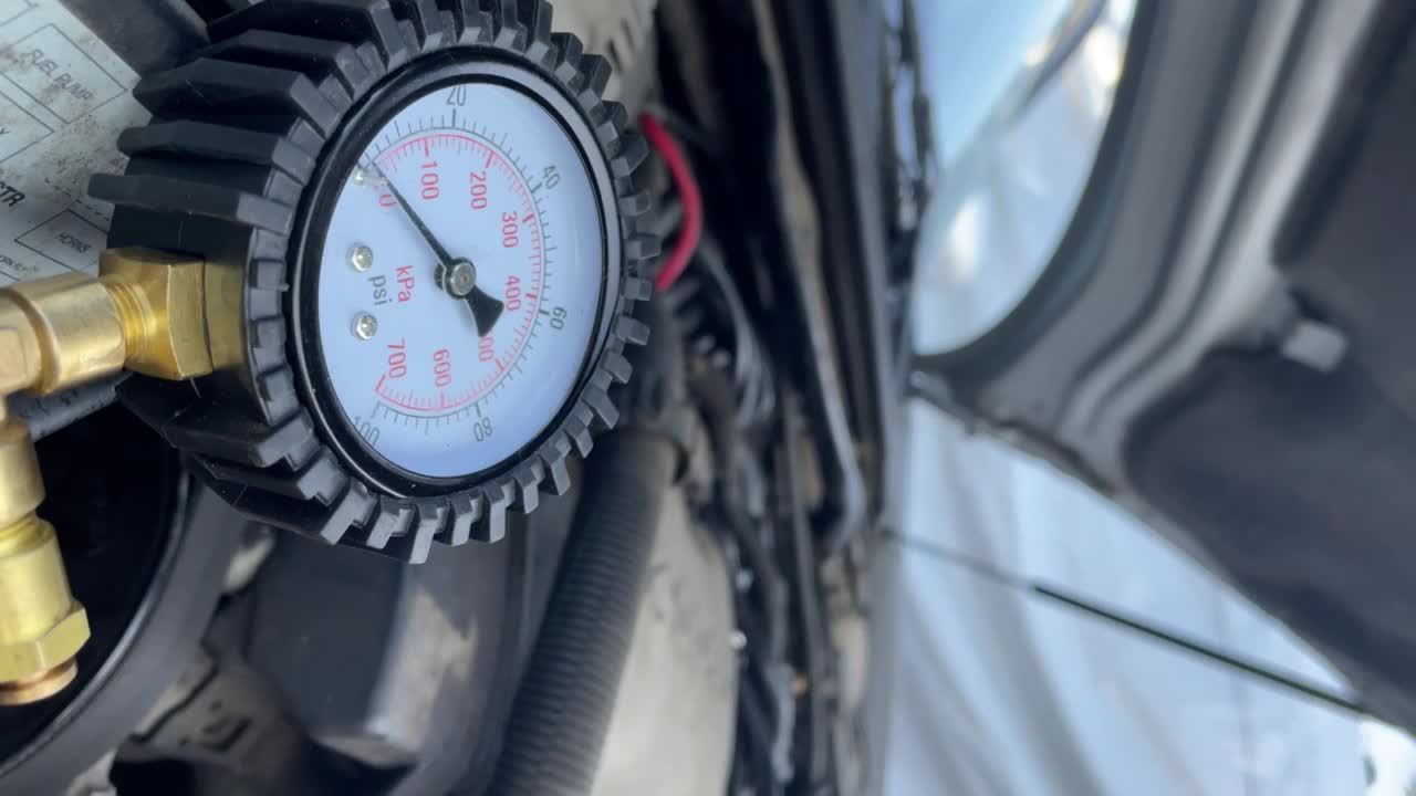

Okay. So, I did the soap method since I’ve seen it’s a little safer down their line for rubber parts. I could find any vacuum leaks and I sprayed at the base of the head gaskets and the engine didn’t idle any faster. I tested the fuel pressure regulator from the Shrader valve on the fuel rail and got 60PSI right when I turned it to the on position but immediately after the pressure drops to zero. I didn’t even bother trying to start or load it because I think that’s an indication of a weak pump, clogged fuel filter or line, correct? I’m still getting a random misfire p0300 though so do I have multiple issues, or do you think the misfire is caused by the lack of fuel? It’s also idling fine now, not rough at all unless I give it gas which makes sense with the fuel pump. I still have the test kit and can test the fuel pressure with the engine running and also loaded if you think I still should. I attached a video of the psi gauge as well as when I had it idling without the fuel pressure gauge attached. You can see me rev the engine from the throttle body and a small amount of smoke coming from the new EGR valve I put in. You should also be able to hear how it struggles after giving it some gas.

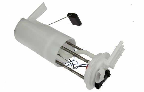

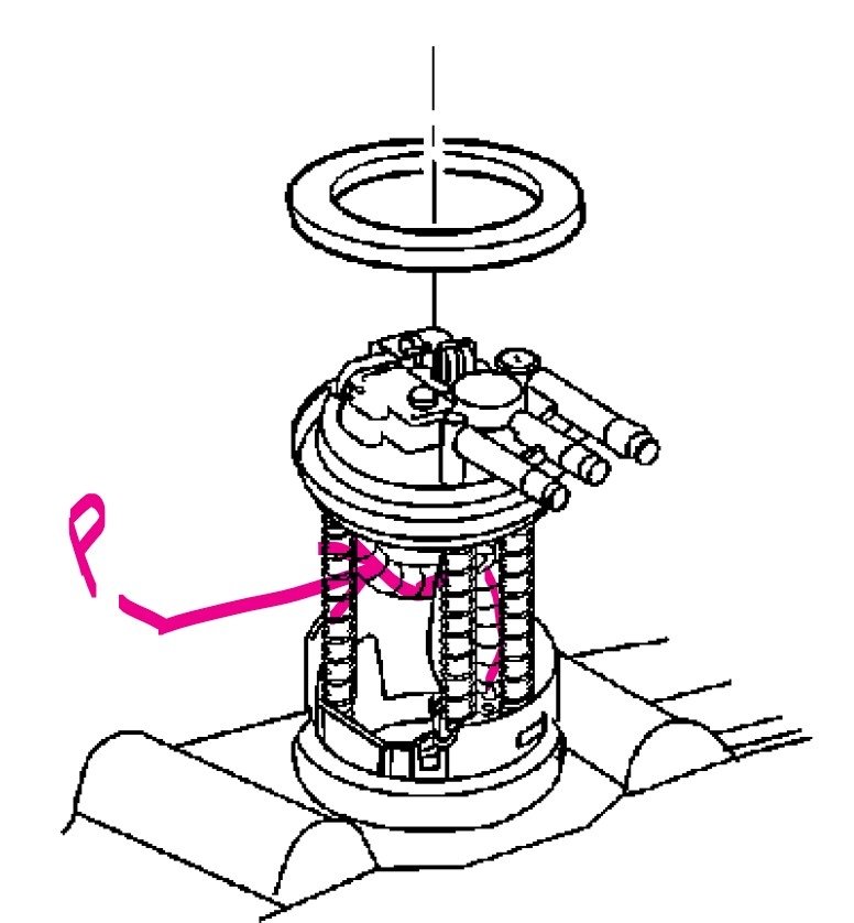

If it dropped instantly then the issue is the check valve in the pump or more likely a leak internal to the fuel tank. I have seen cracked lines between the pump and external connections do that. Both will cause low fuel pressure because the fuel pump can't maintain pressure. From the testing I would say to pull the pump assembly out and replace it. That pump can be accessed through the trunk area, remove the trim panel that is behind the seat, and you will see the access panel to the pump. Remove the nuts and use a bar to pry it up, they usually goop it pretty good to seal it in place. Blow all the crud away and spray it down with some cleaner and let it dry. Remove the harness connector, then the fuel lines disconnect. Now release the retainer ring and the pump should pop up. Pull it and check the white accordion line between it and the external pressure connection for a crack or missing clamp. Both are possible. At one time you could get the pipe from a dealer, but I believe they are off the shelves now. To install the replacement just reverse the process, spray the inside of the rubber ring with a shot of silicone so the pump will seat easily and replace the ring. Reconnect and enjoy your car.

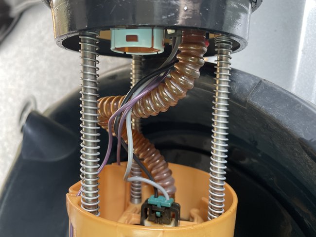

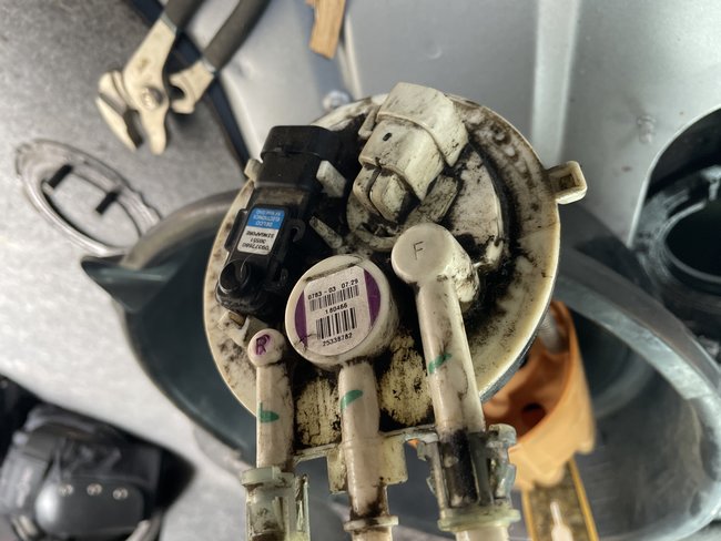

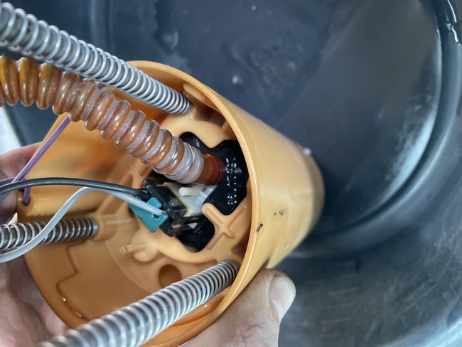

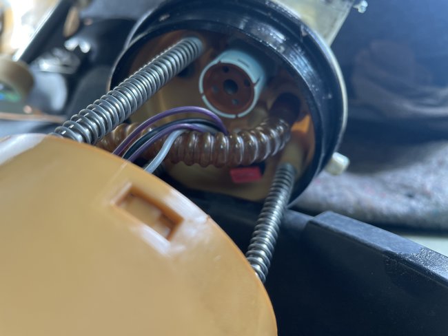

All right, so, I’ve got the fuel pump pulled but I don’t see any cracks or damage at all. Could it just be going out? I don't want to replace it and it’s something else, but I have had fuel pumps just go out on me, however, I couldn’t even start the car at that point. I was able to turn my car around today, so I had enough consistent fuel pressure to do that, but it was struggling still. Maybe it’s a bad fuel pressure regulator? Is there a way to test both parts individually without replacing them? I pulled the fuel pump relay and the fuel pump fuse with the car running to depressurize the fuel system before starting and the car kept idling but wouldn’t stall. When I did that to replace the fuel filter it stalled after a few seconds. I’m not sure if you can explain that but that has me confused as well. Pulled both the relay and the 15-amp fuse for the fuel pump and waited about 20-30 seconds. The connections to the fuel pump looked out, no cracked wires or loose connections. The white accordion/corrugated tube still has fuel in it that I can see and has no visible damage either. Same with the external connections for the wiring harnesses and fuel line connectors. Let me know if you see something I don’t though. I’ve only replaced a fuel pump once in my life. Haha

My bad I’ll just order a cheaper version instead of Ac Delco or OEM so it’s no big deal if it’s something else.

Connect the power to it and run a tube from the output back into the tank and power it on. See if it leaks when it's trying to pump. You can also use an adapter to test the pressure right at the pump.
