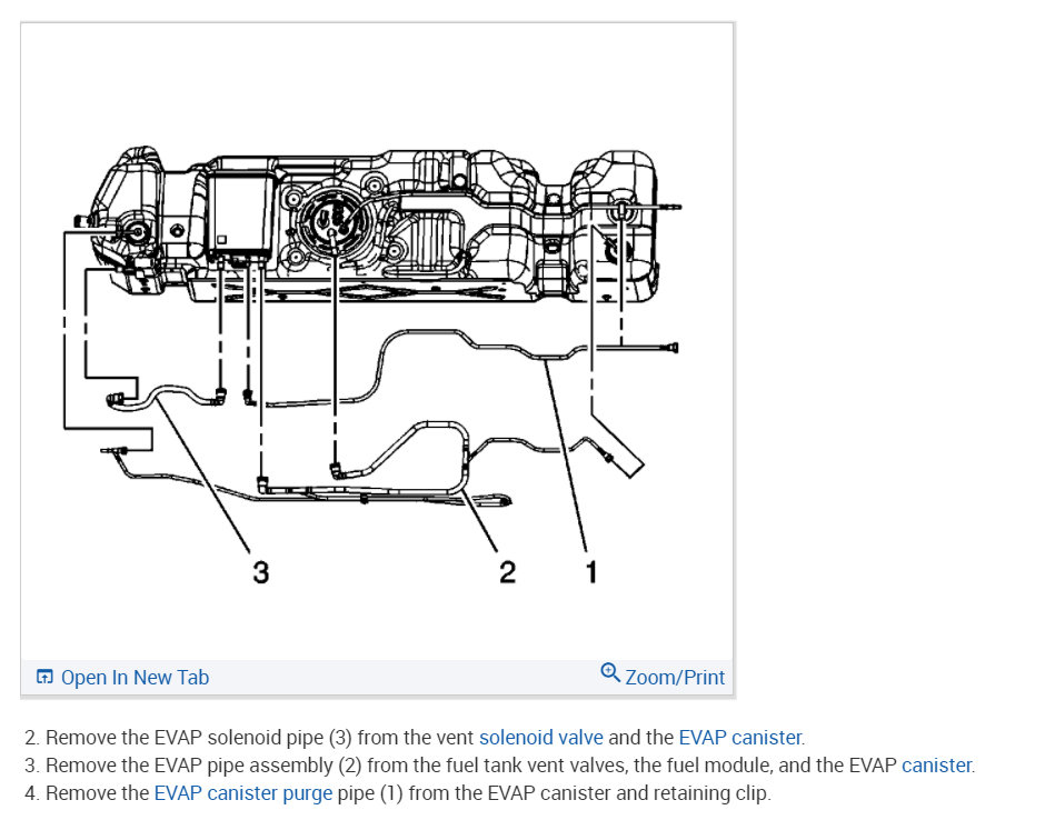

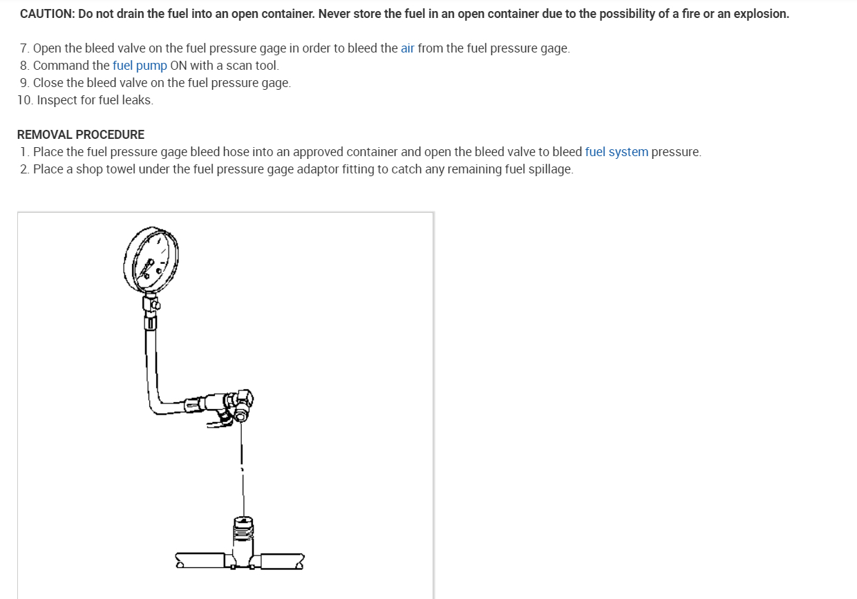

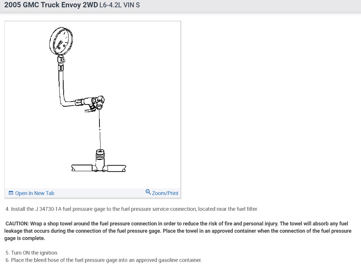

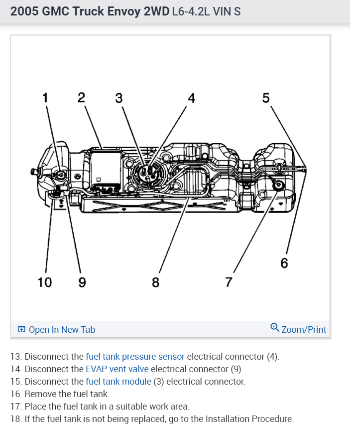

This sounds like two separate problems, the code P0256 Injection Pump Fuel Metering Control B Malfunction (Cam/Rotor/Injector) which I have seen the fuel pump that is going out can cause the issue because the computer can control the fuel pressure but to be sure here is how to check the fuel pressure in general with specific instruction in the diagrams below. Please re-post the overheating and A/C issue which should be related.
Fuel Pressure (Key "on", Engine "off") .................... 345-395 kpa (50-57 psi)
+1
Wednesday, April 6th, 2022 AT 10:19 AM
KEN L
  • MASTER CERTIFIED MECHANIC
  • 55,278 POSTS

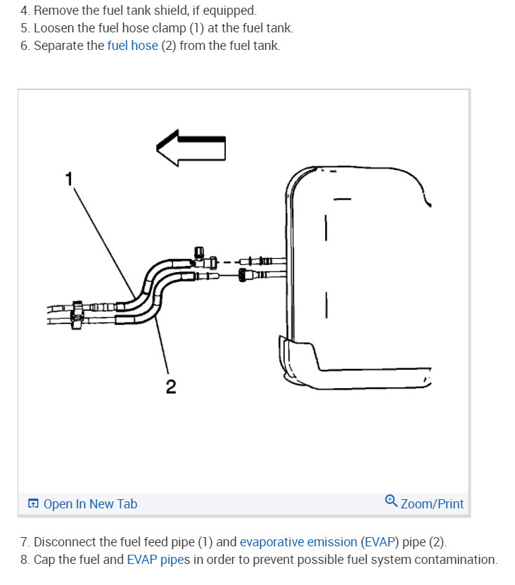

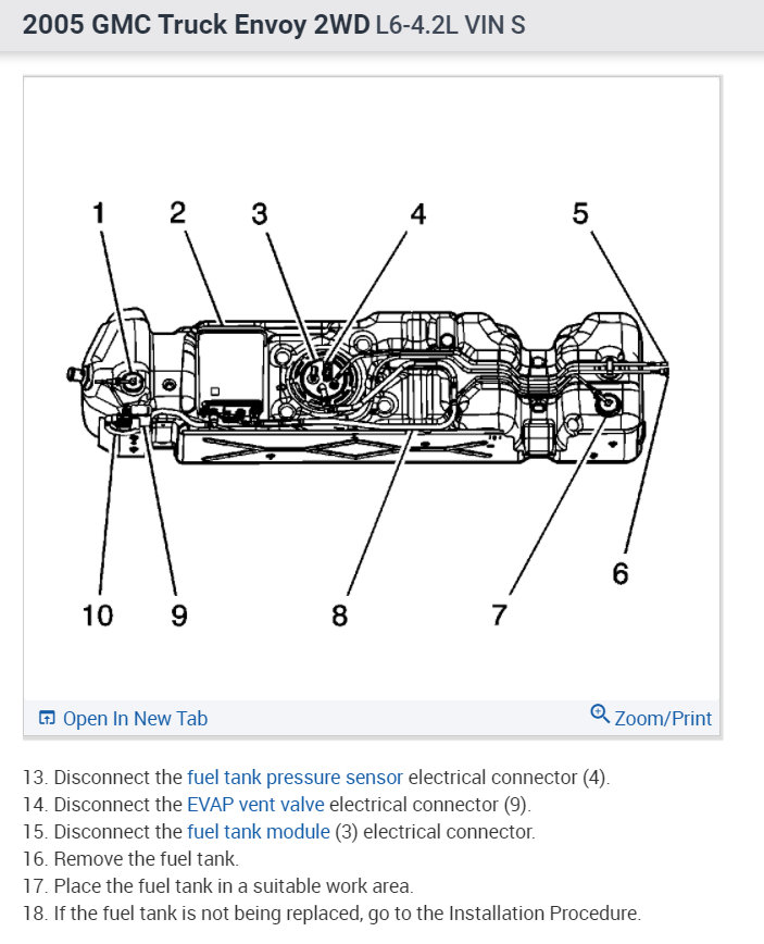

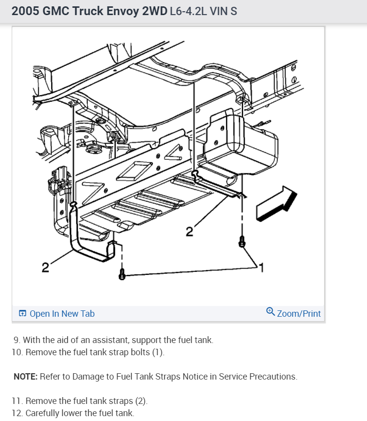

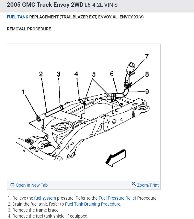

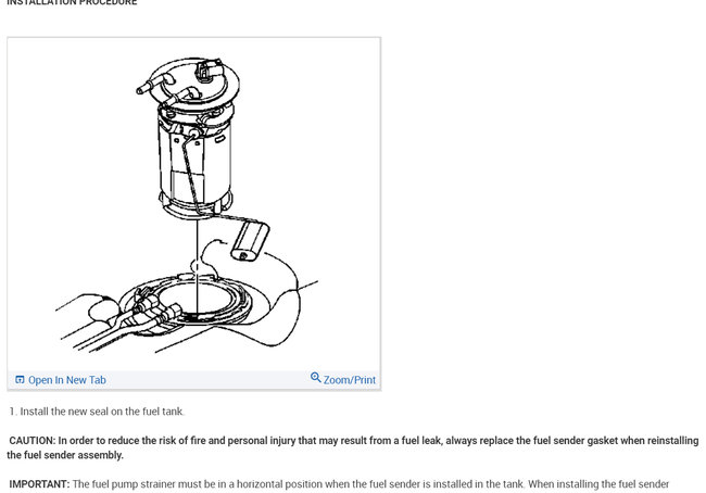

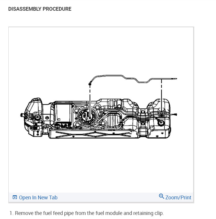

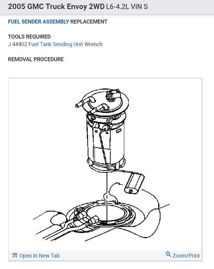

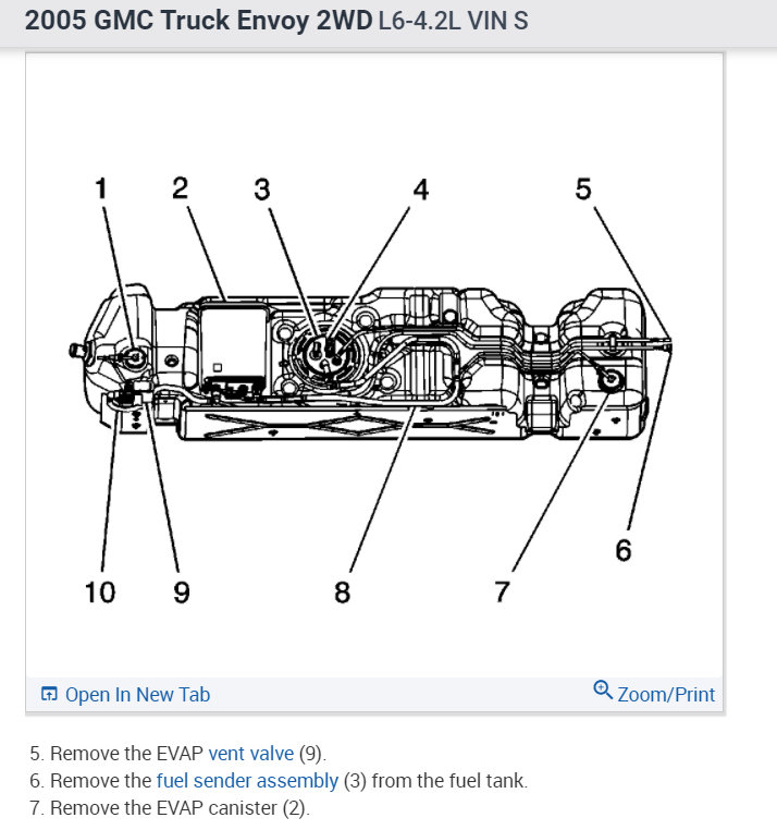

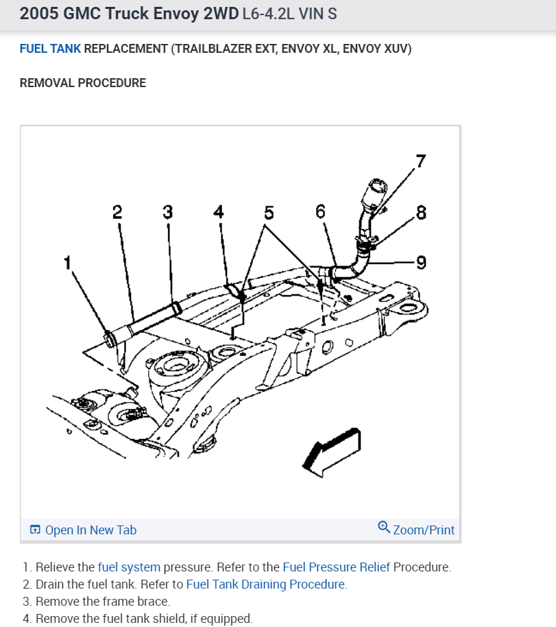

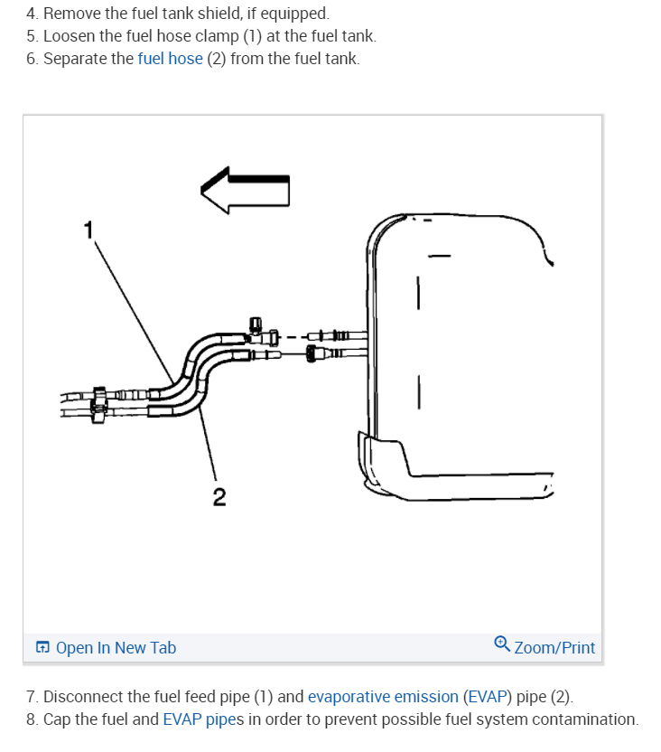

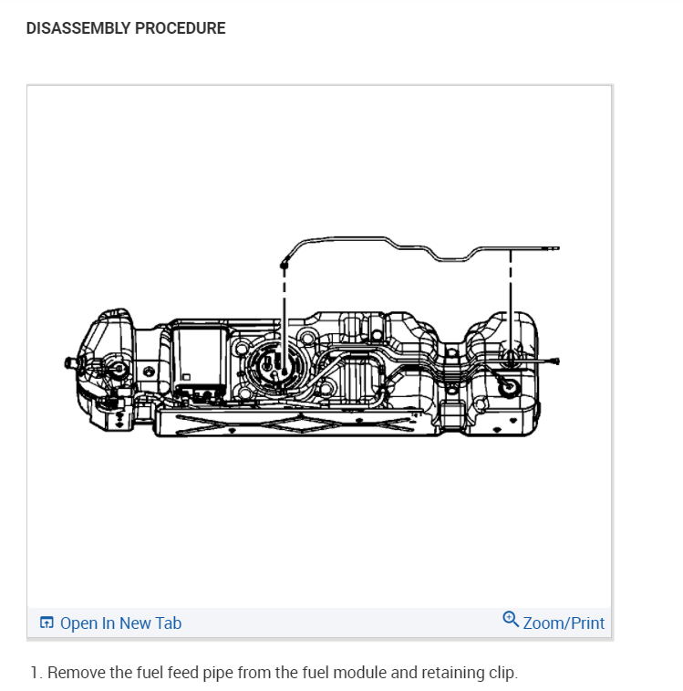

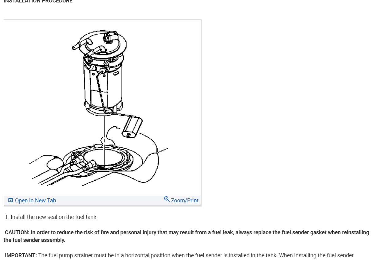

Here is how you can change the fuel pump out in general with a guide below to show you how on your car:
https://www.2carpros.com/articles/how-to-replace-an-electric-fuel-pump
+1
Wednesday, April 6th, 2022 AT 10:25 AM

I’ll be checking fuel pressure today.

Update: fuel pressure below spec got new fuel pump ordered. Thanks for the help.
