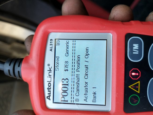

Code P0013 B camshaft positioning actuator circuit/ open bank 1
2014 DODGE JOURNEY
100,000 MILES • 4 CYL
MGSIL
  • 20 POSTS

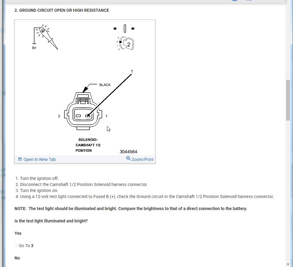

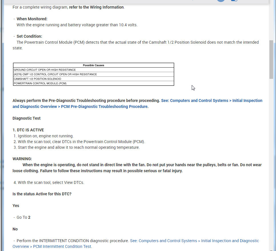

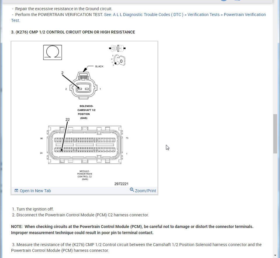

I recently had my motor swapped out since the old one overheated and blew the head gaskets. when the mechanic swapped it i got my car back with a p0013. I tried swapping out the rear camshaft positioning sensor but nothing. What else could be triggering this??
Mar 4, 2021 at 4:20 PM
  • CAR REPAIR CONTRIBUTOR

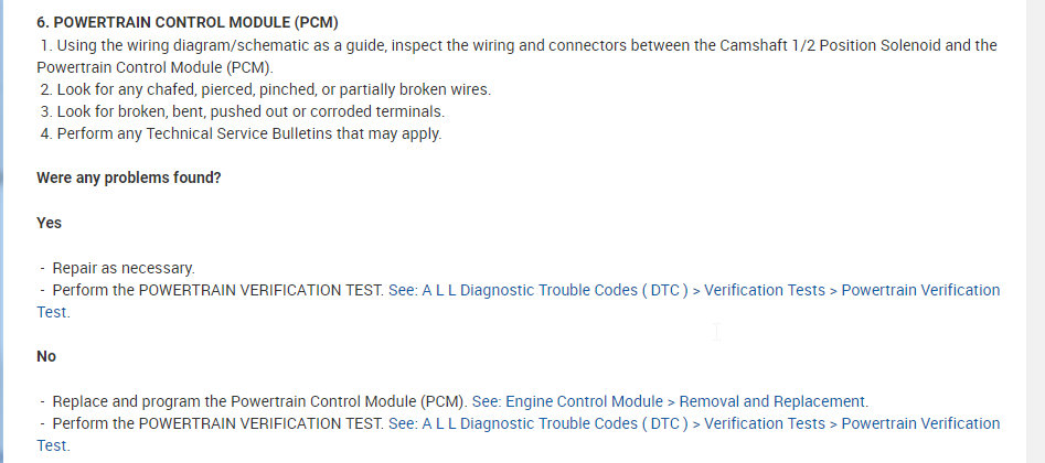

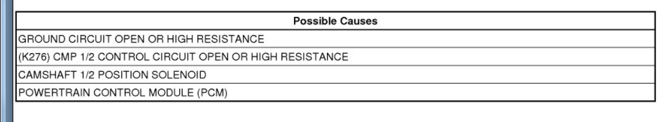

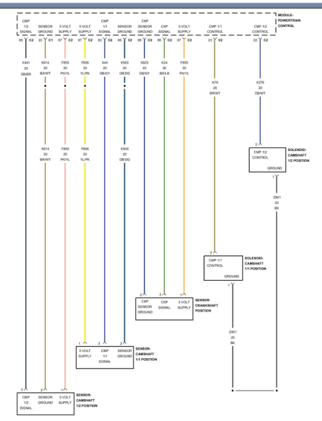

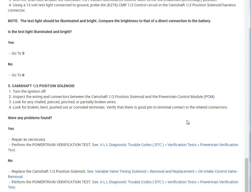

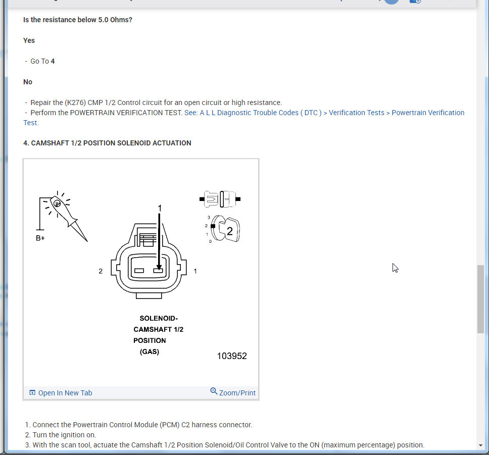

This could be a number of things but if you swapped out the sensor then the most likely cause is a wiring or terminal pin fitment issue.
Please take a look at the testing and let's run through this to determine what the issue is.
Let me know if you have questions. Here is a guide that will help with some of this testing:
Below is the testing. Thanks
