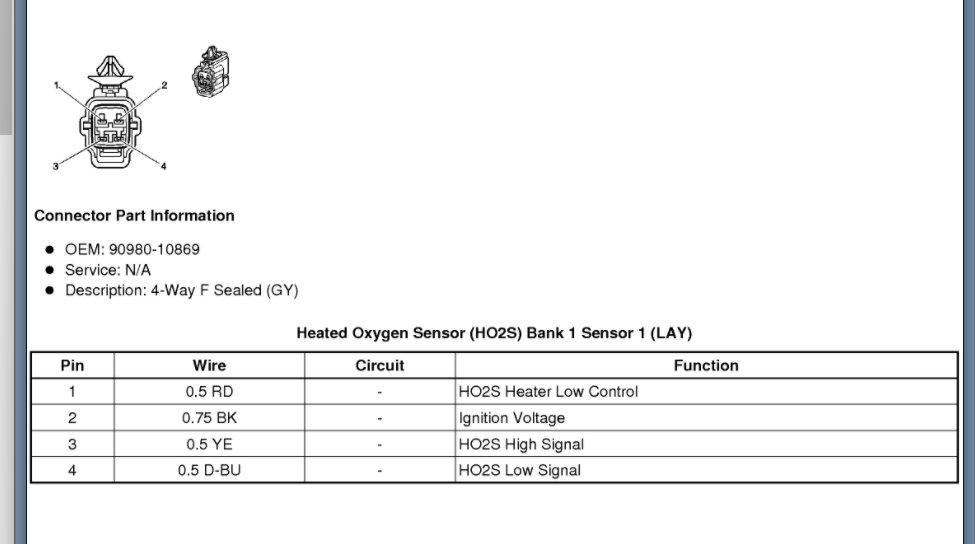

See the diagram below of the connector for pins and let me know what you find. Thanks

Pontiac vibe o2 sensor reads on the ohms meter 24.0 ohms, on sensor side of harness. It is supposed to be 50 to 60 ohms, is it not? Perhaps this normal reading?
Voltage reading on ECM side of harness, reads on the four wire o2 upstream: first reading with voltmeter was 0.5, top right wire, this is the 5-volt reference telling me computer is alive.
Bottom right reads 9.389 volts, this is a voltage drop. The third wire is next wire, it reads 9.08 volts, another voltage drop from ECM, this one confused me, it appears there are two power wires dropping in voltage.
the fourth wire top left reads 0.0 volts there must be the ground wire. I was afraid to use the test light on battery positive to test the ground did not want to burn a transistor inside ECM.
The diagnostic tool reads on O2, 3.89 volts fluctuate but never goes down to 01.00 volts or 0.8 volts.
When performing o2 sensor test upstream OBD tool, says it passes, I do not know what to make of it.

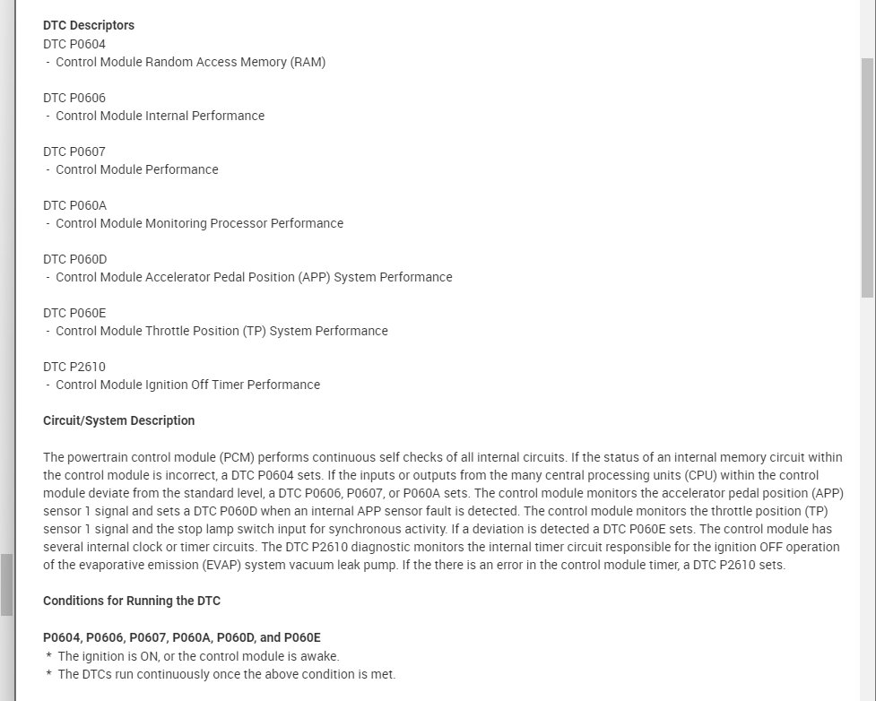

The Pontiac vibe repeats a false code po607 computer performance undefined nonspecific.
Even though I have checked for vacuum leaks with soap and water and clean the throttle body and PCV this code repeats every two months. The 5 volt reference is present in throttle body circuit computer is not dead that is why it is a false code PO607 or 601, I cant remember well.

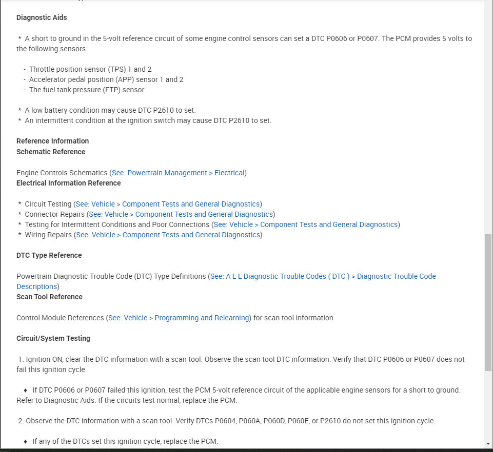

This code is not going to be related to the o2 sensor issue unless you find an issue with the 5 volts. However, you would need to have this code active in order to find and issue with it.
I doubt it is a false code. I suspect it is an active code, but the issue happens quickly and then stops and so the code goes to stored. So, when you test the issue there is nothing wrong with it because it is not active.
So, I would suggest trying to test the 5-volt signal for a short to ground and if if you don't find one then the PCM needs to be replaced.
See the testing below. However, if we need to go more on this code then we need to get a new post started because this would not be related to this issue.

I would check the 5-volt reference at any of the sensors that use it or the sensor that is setting the code.
The ECM sends the 5-volt reference to all sensors so if you have codes for only one sensor then more than likely the ECM is not the issue.
Let's get a new post started on that and we can go from there. Thanks

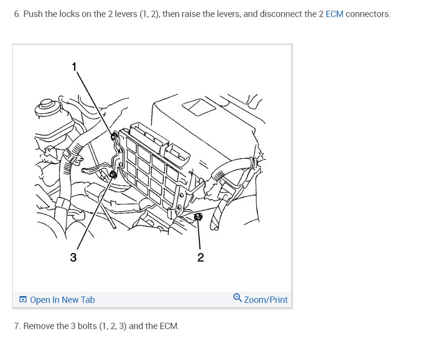

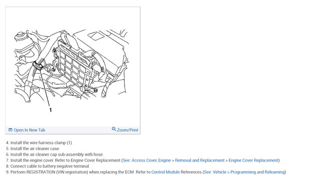

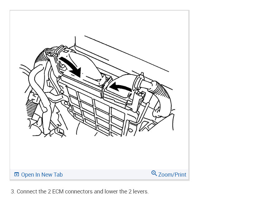

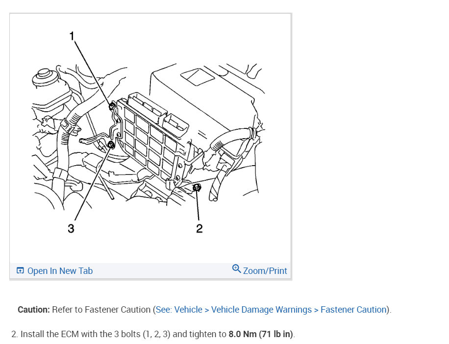

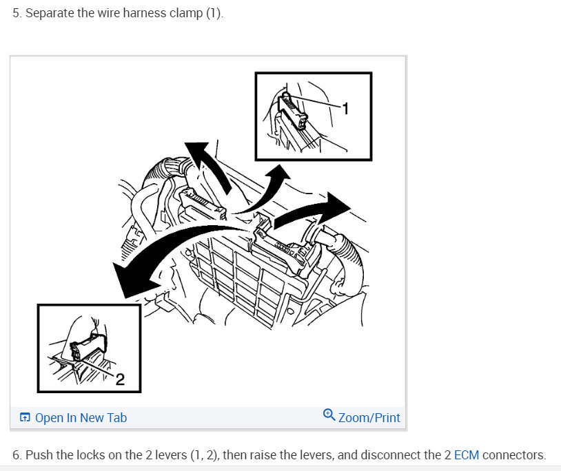

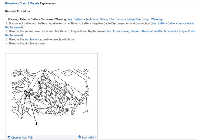

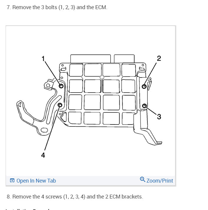

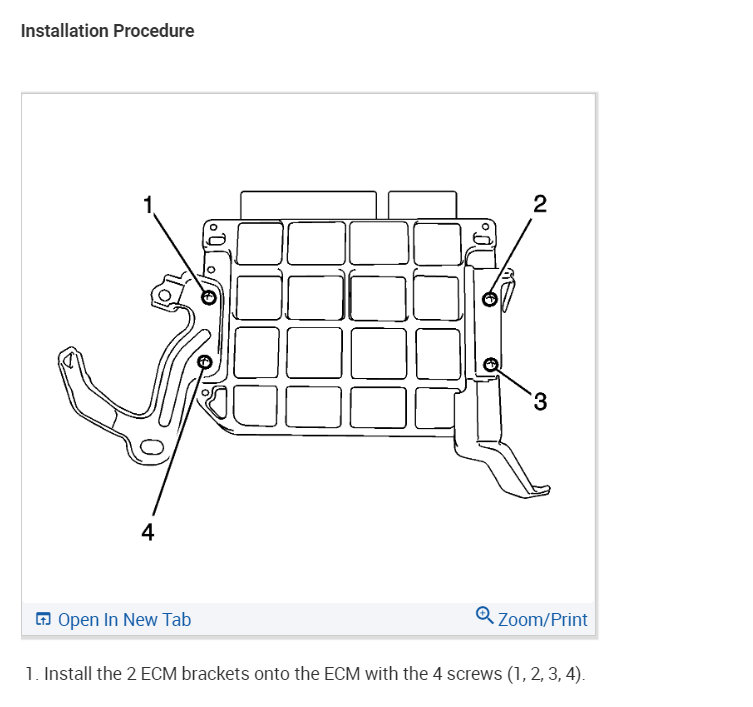

With the PO607 code it says the ECM is working correctly and it needs to be replaced. Here is how, check the images below.
Powertrain Control Module Programming and Setup
PCM Replacement
Note:
- Replacement control modules are preprogrammed at the factory, and only require the VIN to be programmed. The VIN write procedure can only be performed with TIS 2 Web (SPS) using the MDI. Do not program a control module unless you are directed by a service procedure or by a General Motors Service Bulletin.
- Be advised that the Vibe Programming Application itself DOES NOT contain any calibrations. They are downloaded separately AFTER the Programming Application has been downloaded and installed on your PC.
If the PCM requires replacement, perform the following:
1. Ignition ON with a currently learned master key
2. Access Service Programming System (SPS). On the Select Diagnostic Tool and Programming Process screen, select J2534 Tech 2. Follow all on-screen instructions.
3. On the SPS Supported Controllers screen, select VIN-Write VIN to PCM (J2534). Follow the on-screen instructions.
Clear all codes and cycle the ignition OFF for at least 30 seconds.
4. Remove the scan tool and install a 3A fused jumper wire between terminal 4 and terminal 13 at the DLC.
5. Ignition ON for 30minutes.
6. After the 30 minute time period has elapsed, disconnect the jumper wire .
7. Start the vehicle and verify that the Security Light is not illuminated.
8. Clear all codes.
