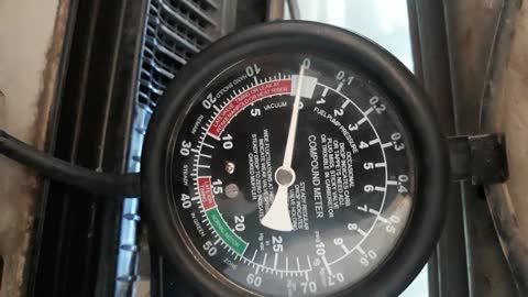

  • 52,797 POSTS
Okay, that is good.
Remove the oil fill cap while the engine is running and see if you feel vacuum over the hole. You should feel positive pressure coming out, not a vacuum.
Friday, May 15th, 2020 AT 3:11 PM
MARIOC68
  • 120 POSTS
I did the test in the oil filler hole, I feel blow and suction. I did it with a piece of paper.
Friday, May 15th, 2020 AT 5:47 PM
  • 52,797 POSTS
If you feel suction, you have a leaking intake manifold gasket. There should be no vacuum at the fill for the oil.

I'll try smoking it, to see where it vacuum I will start by applying a clean carburetor. Are these techniques valid?
Saturday, May 16th, 2020 AT 5:45 AM
  • 52,797 POSTS
Not for an internal vacuum leak. If it were external, yes.
If you smoke it and you see some smoke come out of the oil fill, then yes, it is bad.
Saturday, May 16th, 2020 AT 5:58 AM
MARIOC68
  • 120 POSTS
There is no smoke output from the oil filler cap.
Saturday, May 16th, 2020 AT 9:28 AM
  • 52,797 POSTS
The fact that you have vacuum says that the intake manifold is leaking into the crankcase.

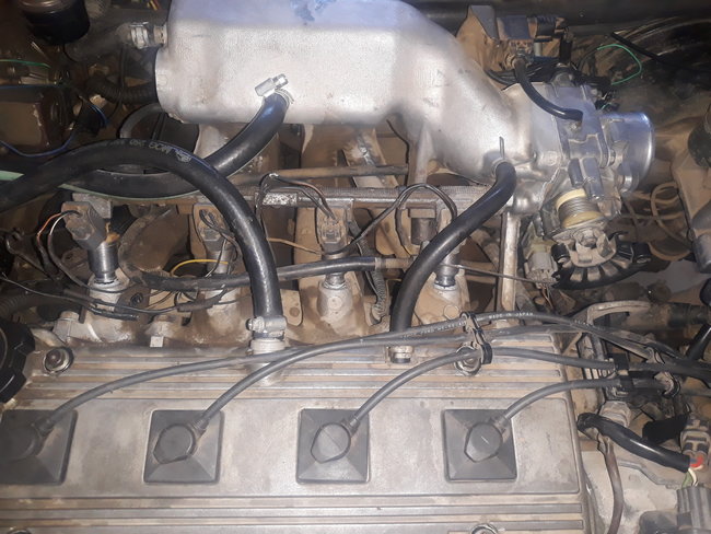

MARIOC68
  • 120 POSTS
The left (thick) hose is the PCV valve and the right (thin) hose is a direct connection from the valve cover to the intake manifold. This hose is the one that made me empty in the oil filling mouth. Plug both sides of this hose. I retested with a running engine no longer generates vacuum.
Saturday, May 16th, 2020 AT 12:18 PM
  • 52,797 POSTS
Okay, then you are good. Back to the catalytic converter testing.

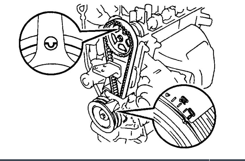

  • 52,797 POSTS
The next thing I would check is the timing. Check the valve timing on the belt and make sure the marks are correct.
I attached a diagram of the marks for you to check.
Tuesday, May 19th, 2020 AT 8:01 AM
MARIOC68
  • 120 POSTS
I check the timing of the distribution chain, it is correct.
Tuesday, May 19th, 2020 AT 12:03 PM
  • 52,797 POSTS
The reason I asked is the compression was very high. That tells me that maybe the chain is advanced from the normal setting.
Tuesday, May 19th, 2020 AT 12:42 PM
MARIOC68
  • 120 POSTS
Could the high compression be caused by char in the combustion chamber or perhaps the cylinder cover has already been rectified?
Tuesday, May 19th, 2020 AT 12:55 PM
  • 52,797 POSTS
If you are talking about carbon, yes it could.
