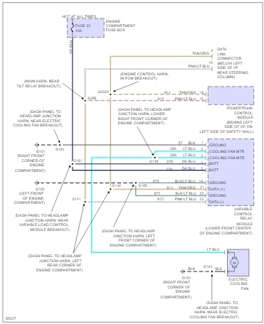

1997 LINCOLN MARK VIII
4.6L
V8
2WD
AUTOMATIC
56,000 MILES
Fan comes on when connected direct power.
Saturday, September 16th, 2017 AT 9:40 AM
CJ MEDEVAC
MECHANIC
11,005 POSTS
Got you a diagram of the cooling fan system.
Click on it below.
Let us know if it helps.
