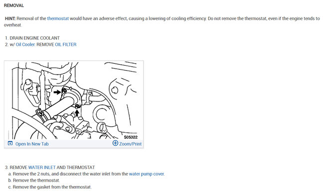

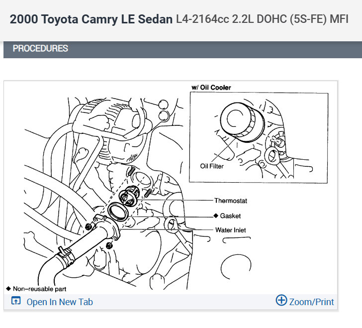

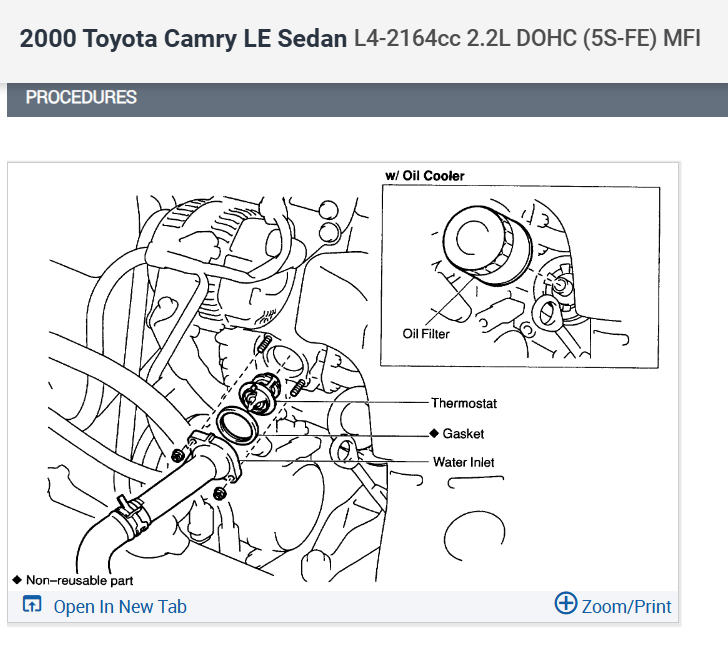

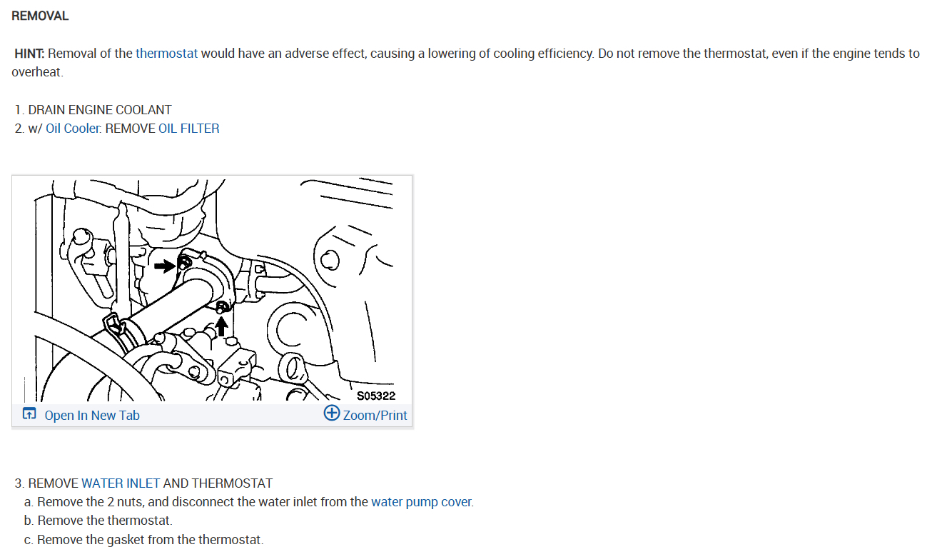

few minutes of driving it starts to overheat?
2000 TOYOTA CAMRY
271,009 MILES
BERRY7
I put coolant in the car and after a few minutes of driving it starts to overheat. No sign of leaking anywhere.
Oct 24, 2024 at 2:12 PM
  • 54,520 POSTS
This can be caused by a stuck thermostat which is typical. Can I ask if you hear the cooling fans when the engine is overheating? If so, I would replace the thermostat. Here is how in the images below.
This guide can help as well:
And this can help you as well:
