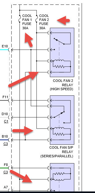

Fans not coming on, fuses are good. I need to know where the temperature sending unit. Is located. Anything else that might be the problem.

Check fuses and relay under hood for cooling fans. The temperature sending unit is at rear of motor under the egr valve. If coolant level is low have pressure checked for coolant leak.
