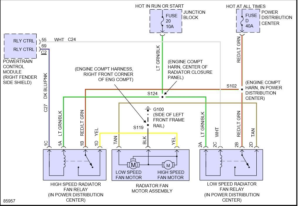

Hello my name is Justin Shockley I have a car that overheats. I have recently replaced my head gaskets, thermostat, thermostat housing, water pump, radiator, and multiple hoses but it still overheats and comes out the overflow hose on the reservoir. I have flushed the system more than once and running out of options. Any suggestions?
Tuesday, June 5th, 2018 AT 9:26 AM
PATENTED_REPAIR_PRO
  • 1,853 POSTS
Is the cooling fan running when the engine gets hot, before it overheats and also run even when cool, if the AC is turned on?
If not check the fuses and relays.
