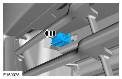

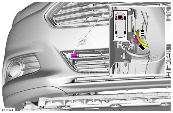

That sounds like a missing sensor or bad wiring. The sensor is on the right side just behind the bumper cover area. The common issue is that the sensor wiring gets damaged and not repaired in a collision. The repair is usually to get a new sensor harness and sensor and replace the parts.

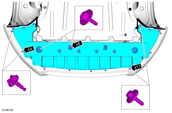

To replace it you remove the lower trim closure under the front end, the sensor wire and the sensor. Reverse to install the new one.
The harness is a bit harder as it snakes around, but you should be able to follow it and find any damage.

I should just be able to take the bottom access cover off under the engine and have the room to see what the situation is that is how I am seeing it anyway? I am planning on looking at it Friday morning to see what I can see. Sorry I think I am repeating myself or making you repeat yourself.

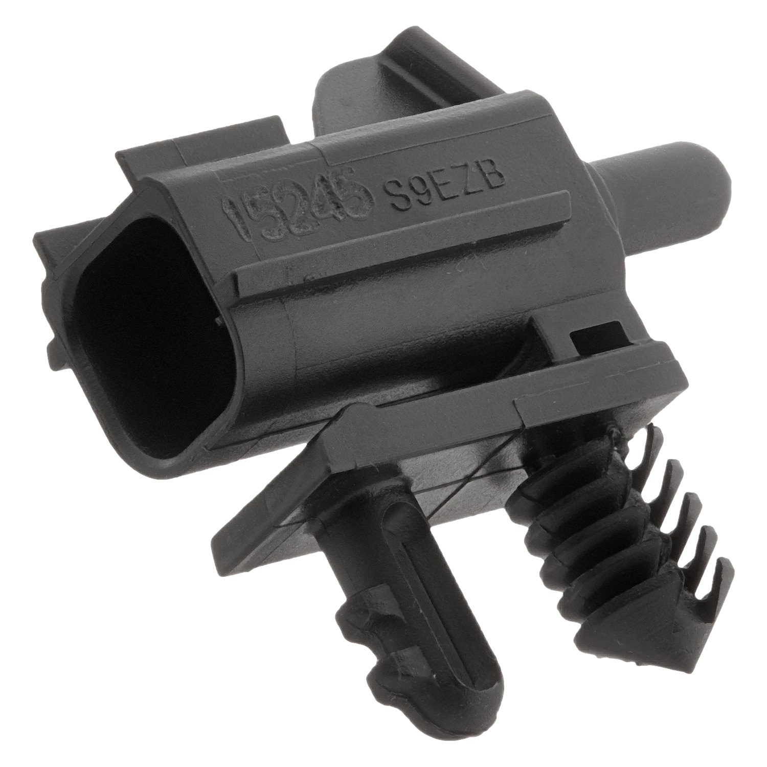

Do you know where I can get a bracket for the sensor? The sensor was missing but I do not have a mounting bracket. I have the sensor Bit not a bracket.
Saturday, June 23rd, 2018 AT 8:48 PM
STEVE W.
  • 15,691 POSTS
That would be a dealer or salvage yard part. Or just make something to hold it in position until you can locate the proper part. From looking at the sensor it just pushes into a couple holes. Probably in the bumper support. As long as it is in the general location it should be fine.
