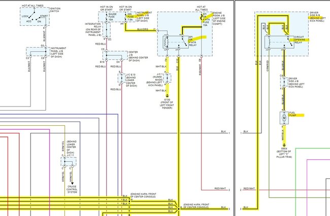

Cranks no start. The ECU was by passed 4 years ago ran the car with jumper wire at the open circuit relay control side power to control side ground the car ran for 4 years however now there is no control side power to start car fuel pump not supplying gas to engine.
I have not taken the pm meter to check both control side ground and power. The wire reaching the fuel pump is black and white.
Did I blow out EVU?

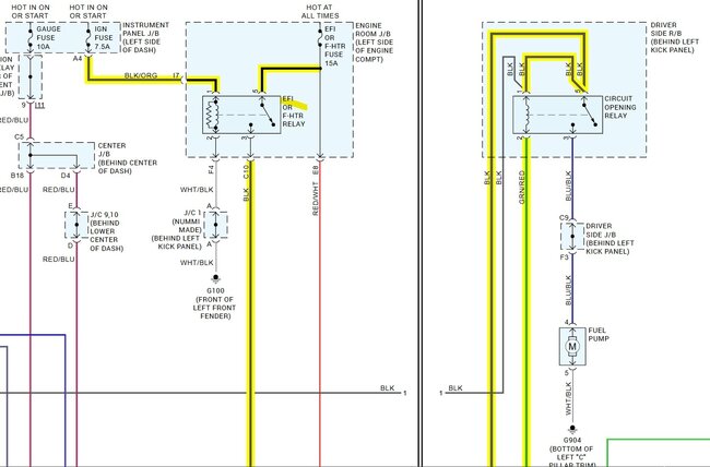

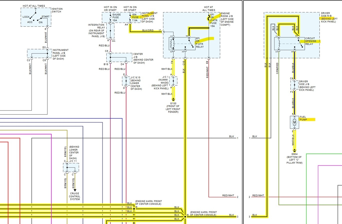

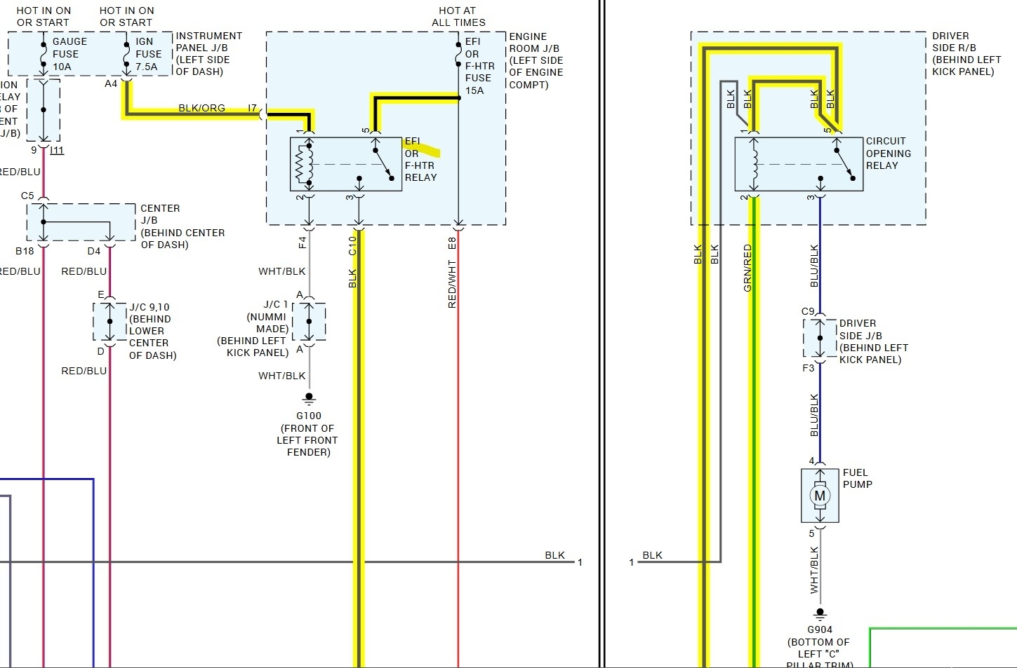

Hello, the Circuit Opening relay gets power on both the Load and the Control side of the relay from the EFI OR F-HTR Relay then from the EFI OR F_HTR Fuse 15amp and the IGN Fuse 7.5amp which is on the ignition switch, I'll post the wiring diagrams, but I would start with checking fuses with a test light in the engine compartment and the Dash fuse panel.

Start by checking for power at the 2 fuses that feed those relays, the second fuse should be Hot at all times, the other is with the key on.

I'm not sure about your wording there, but power for the Circuit Opening relay does not come from the ECM, it comes from the EFI relay, the ECM controls the Opening relay by grounding the Green/Red wire. The EFI relay is power side controlled from the Ignition switch. So, if you take the EFI relay out, with the key On, you should have power on 2 of the 4 pins in the socket location where the relay sits. If that's okay, then remove the Opening Relay and with the key On, you should have power on 2 of the 4 pins at that relay location as well. Use a test light hooked to battery negative to check it.
Checking resistance will not tell you if the wire can carry any current, because it's not a loaded circuit test.
