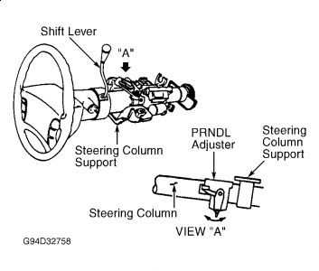

When trying to place the car in park, the gear shift goes into possiion but will not "click". The key will not come out and you can pull it right out of park without the car running. Not very safe. Do you think there is something wrong with the linkage or the gear shift itself.
Thanks
Dan
Tuesday, August 25th, 2009 AT 10:42 AM
3 Replies
DOCFIXIT
  • 18,828 POSTS
May need adjustment remover coluumn covers place shifter in neutral adjust at A so taht both dots above N fill indicator
https://www.2carpros.com/forum/automotive_pictures/198357_Graphic_101.jpg
If this doesn't do it may need to adjust at trans
Tuesday, August 25th, 2009 AT 11:01 AM

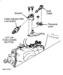

DANO19068
The gear shift is on the floor. Anything different I need to do?
+3
Tuesday, August 25th, 2009 AT 11:06 AM
DOCFIXIT
  • 18,828 POSTS

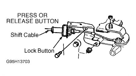

O.K. sending shift adjustment for cutlas FWD
Place in neutral press lock button place transaxle in neutral release lock.
https://www.2carpros.com/forum/automotive_pictures/198357_Graphic_103.jpg
https://www.2carpros.com/forum/automotive_pictures/198357_Grafic_3_28.jpg
