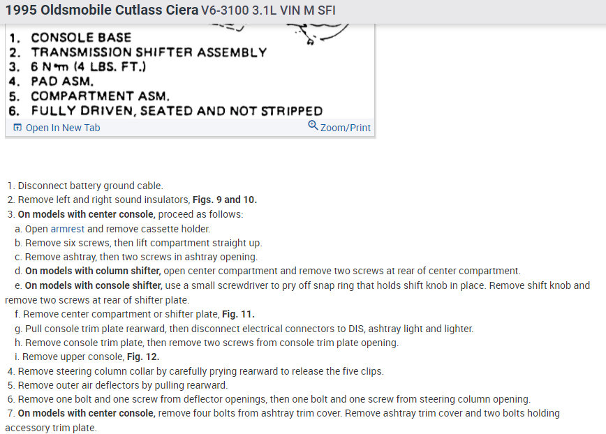

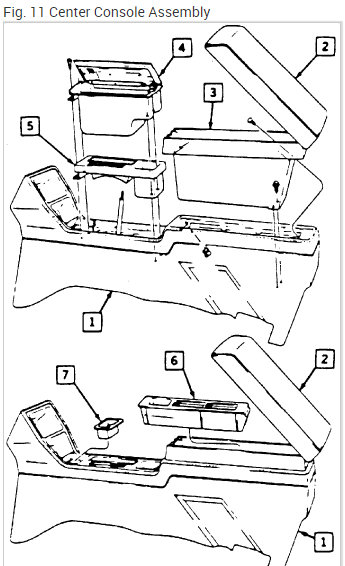

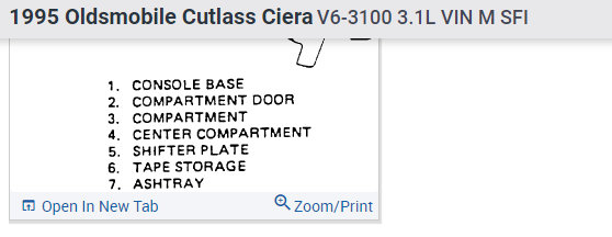

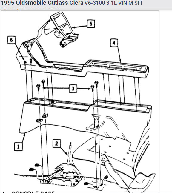

How do I remove gear shifter?
Saturday, July 10th, 2010 AT 5:15 PM
SQM
MECHANIC
6,383 POSTS
See attached for the shifter replacement procedure. Let me know if you have any questions. Check out the diagrams (Below). Let us know what happens and please upload pictures or videos of the problem.
