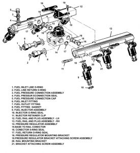

Use PB Blaster on connections that will break loose the rust so you can change filter but I would like to know what the pressure is at the fuel rail before you change filter and after you can go to autozone and they will loan you a fuel pressure guage and you can test this your self the location is on top of fuel rail no. 3,4,5 on diagram
https://www.2carpros.com/forum/automotive_pictures/52960_0900c15280067f3c_1.jpg

That is one of the few details I left out of my original message but I have already sprayed the fuel filter nut with PB Blaster several times with no improvement. I will try once more but honestly at this point, I don't believe I will be able to break it loose without damaging the fuel line. I have already been told that my only source for a replacement line would be at a junk yard.
What will the pressure readings tell you?

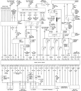

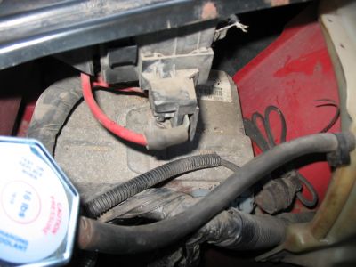

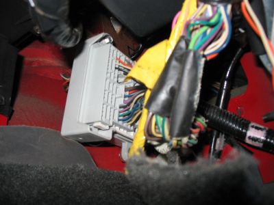

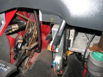

Ok now let's check vo;tage on pin A6 and A8 om the engine control modual
https://www.2carpros.com/forum/automotive_pictures/52960_0900c152800680d0_1.jpg
Locate the computer control module. If not readily visible on the right side of the engine compartment, it is probably mounted inside the passenger compartment, under the dash.
If equipped with a passenger compartment mounted module, remove the interior access panel/right side hush panel.
If equipped with an engine compartment mounted module, one or all of the following steps may be necessary:
Remove the coolant tank reservoir.
Remove the air cleaner intake duct.
Remove the right side splash shield.
Remove the plastic ECM cover.
