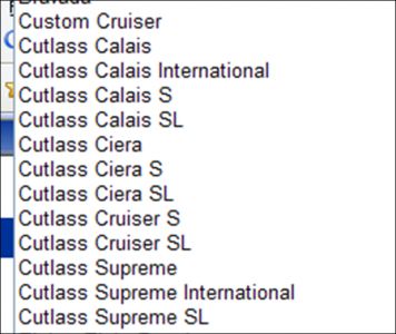

To better assist you please tell me the size of your engine in liter. Also, I have attached a pic below with the various models. . .. . ..please let me know which one is yours.
