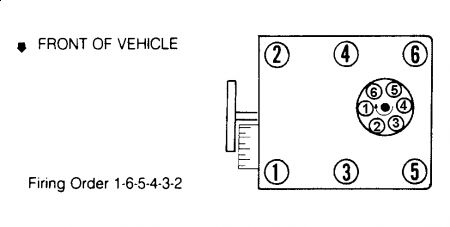

Am not sure where the relay is but I was wondering if you could tell me what way the rotar bug should be facing when the timing is right. And could the distributor possible be bad. There seems to be plenty of gas getting into the throttle body injectors.
Friday, March 13th, 2009 AT 5:10 PM
  • 110,194 POSTS
Here is a diagram of the timing and rotor.
https://www.2carpros.com/forum/automotive_pictures/249084_fire_1.jpg
It could be the distributor, but I doubt it. I would be more focused on the ignition module in the distributor.
Friday, March 13th, 2009 AT 11:34 PM
