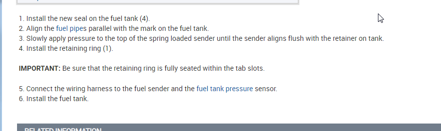

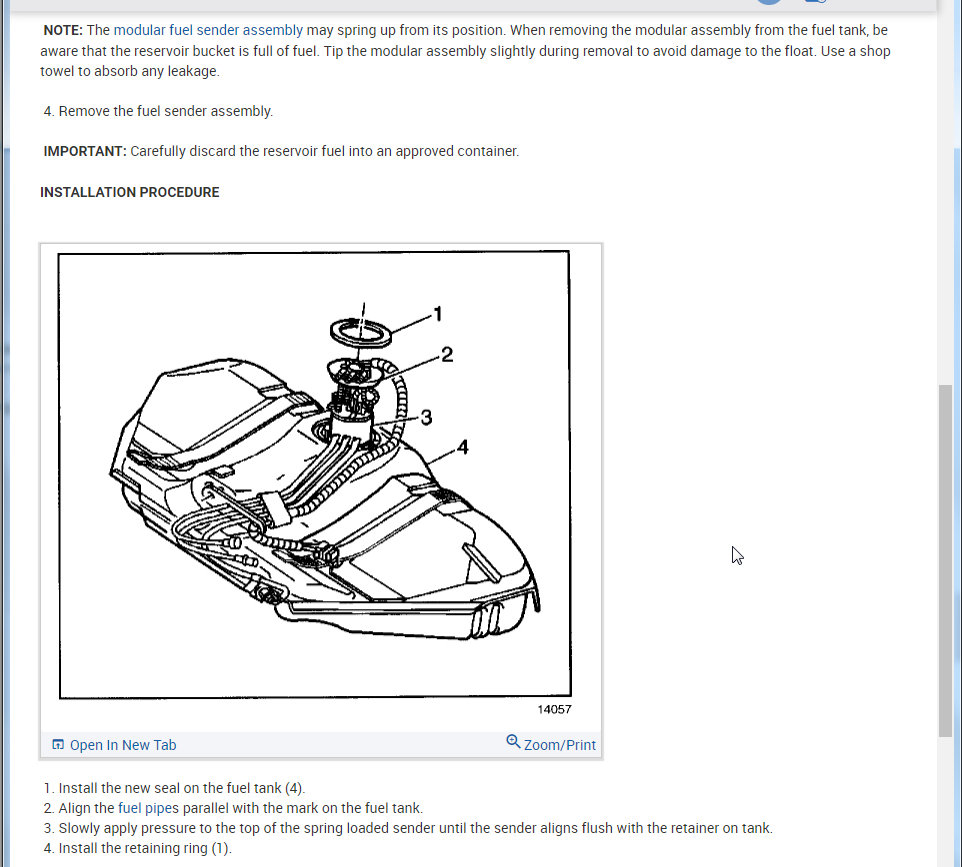

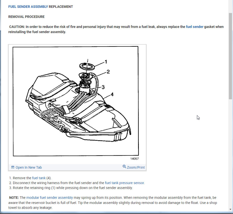

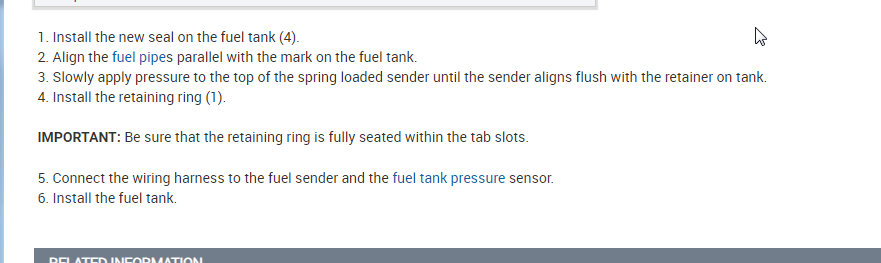

Were is the fuel pump is it under the back seat or in the tank
Saturday, November 29th, 2008 AT 6:17 PM
MECHANIC
18,907 POSTS
This is located in the tank and access by dropping the tank and I included the process from the manual on this.
Also, here is a more general guide that will help with this as well:
https://www.2carpros.com/articles/how-to-replace-an-electric-fuel-pump
Let us know what other questions you have. Thanks
