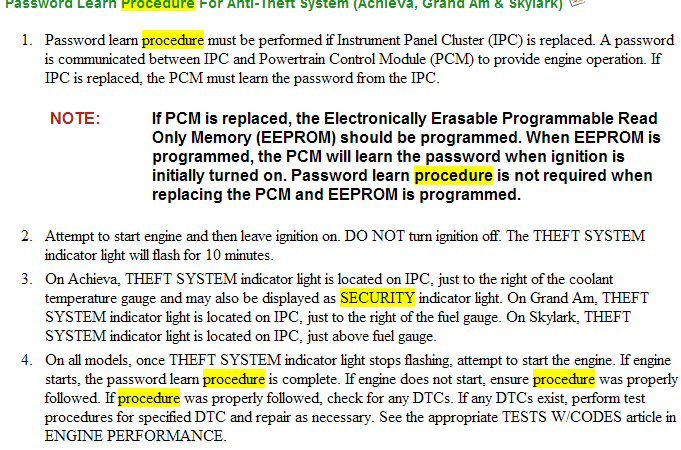

If the security light is flashing try the procedure below
https://www.2carpros.com/articles/how-to-reset-a-security-system

Suspect PassLock (security system) sensor problem in ignition . Due to heat related and cycling key. When it won't start see if there is injector pulse.

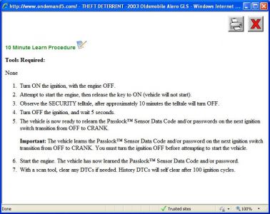

my wife drove the car friday,and saturday it would not start. it crank over but will not start .

First of all thank you so much for your donation.Does the security light stay on or flash on the dash?Have you checked for spark or what the fuel pressure is?Let me know.

the security light flashes,

https://images.2carpros.com/forum/automotive_pictures/416332_2003_oldsmobile_alero_passlock_sensor_relearn_1.jpg
Alright that why your car won't start your security system is keeping it from starting.When the security system is activated it shuts down your fuel injectors no no gas get's into your engine.Does your key less entry work with the remote's?Here's the problem though your going to have code's in your body control module and to get those code's you need a expensive scanner to read them.The cheaper more common scanner's only read your engine and transmission code's not your body control module code's.Let's do this follow that passlock relearn procedure i posted and see if it start's if it does then you can at least get it to a shop so they can read those code's.Let me know what you find.Also what model alero do you have?

lets start off by saying thank you. I did the securty method and the car started right up.I thought this was going to be some kind of scam . I was wrong. thank you again.

I figured it out.Just had to leave key turned to on position for 10 minutes,then turn off and start car.Was the passlock system.
