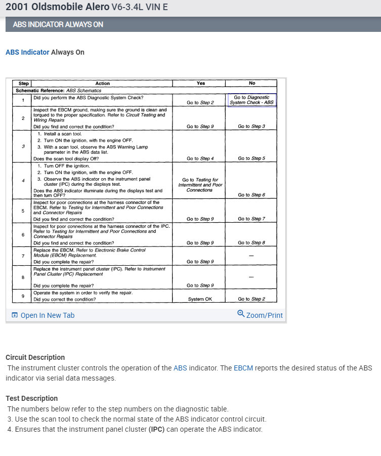

Service light, Antilock, track off light are on.
2001 OLDSMOBILE ALERO
140,000 MILES • 6 CYL • FWD • AUTOMATIC
LEPJMJM5
service light, Antilock, track off light are on. what is the problem

The ABS light gets illuminated when the on-board diagnostics detects any fault within the ABS system. The traction control system works as a part of the ABS components and both light typically gets triggered due to an issue with one or the other.
This could be due to bad sensor, faulty wiring or a defective module.
Have the vehicle scanned to retrieve the trouble codes for the ABS. This can help with the diagnostics.
Here is a helpful video of how to retrieve the code(s):
https://youtu.be/rTtAnsOlZU4
Also take a look at this guide it covers the typical issues with the ABS system:
https://www.2carpros.com/articles/abs-warning-light-on-easy-repair-guide
