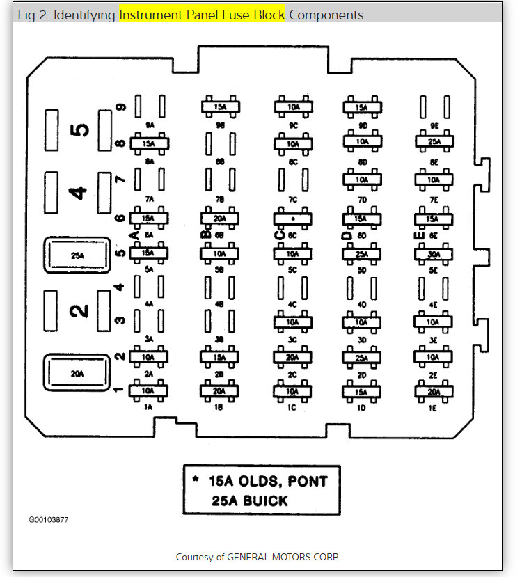

I need help finding my fuse for my blower motor for my defrost or heater, I don't have a owner manual and I have an 98 oldsmobile regency. When I push the button on my control panel I can hear it click but the blower doesn't work. I want to find the fuse first before I just replace the motor. Please help me.

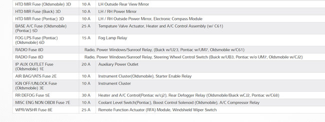

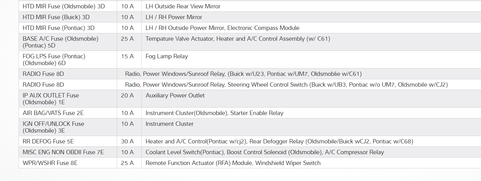

Here is a guide and the a/c 30 amp (RR DEFOG Fuse 5E) fuse location below to help you test the fuse.
