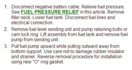

Do I have to drop the tank to change the fuel pump? And how long does this job take?
Friday, February 19th, 2010 AT 11:03 AM
JDL
  • 16,098 POSTS
Yes, you have to drop the tank. I looked at labor time on MOD, 2 hours. That time depends on how experienced you are, how fast you work, having the proper tools. I usually drain the tank, first.
https://www.2carpros.com/forum/automotive_pictures/170934_olds_fuel_pump_1.jpg
