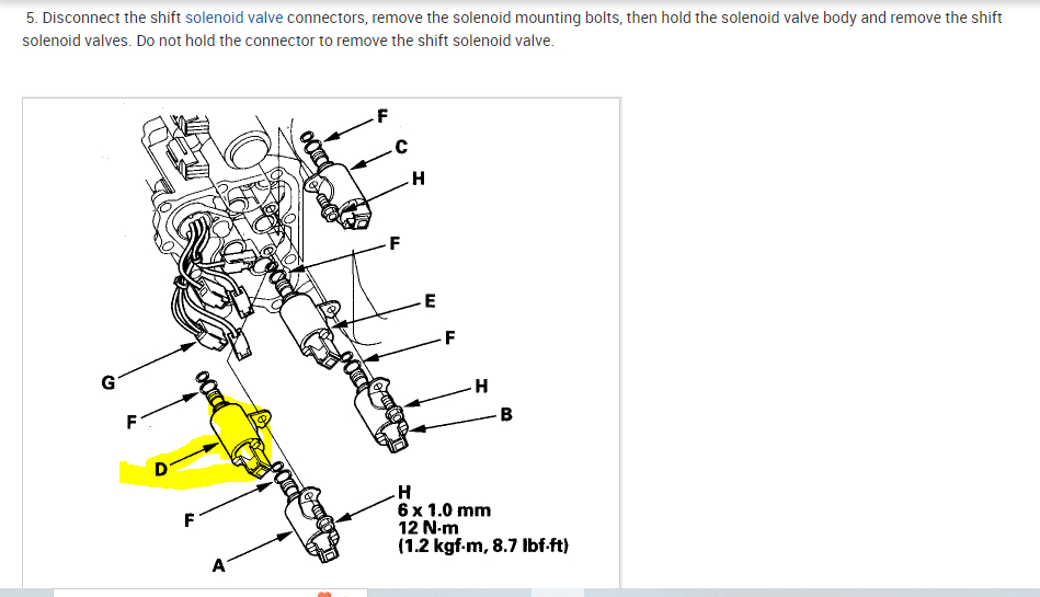

Code P0721, where is the output shaft speed sensor located?

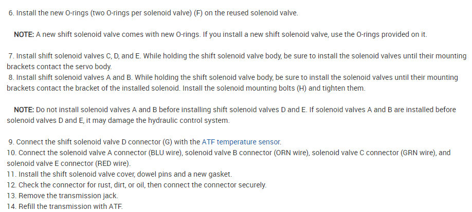

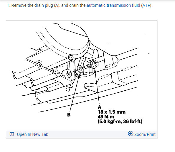

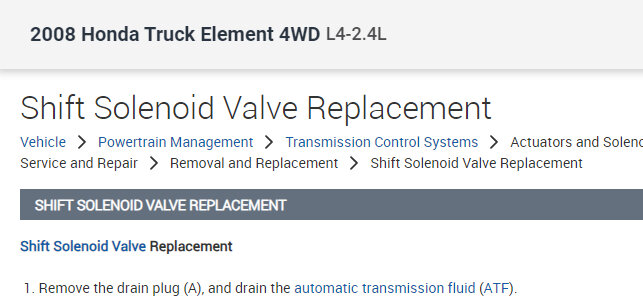

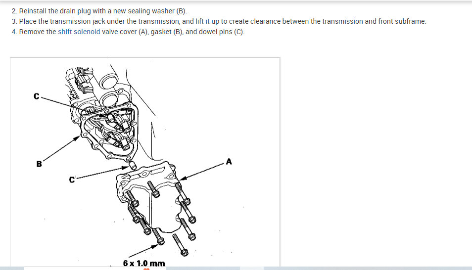

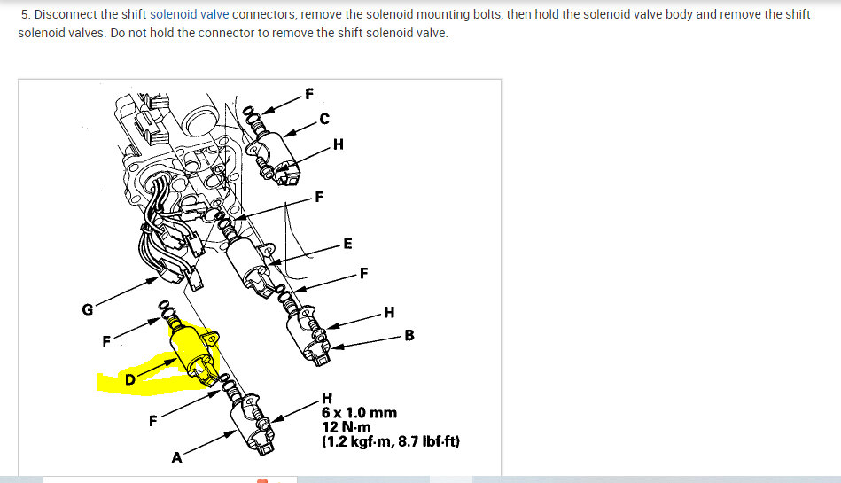

The solenoid is located inside the transmission. I attached the directions below for replacing them.
I highlighted solenoid D.
Let me know if this helps.
