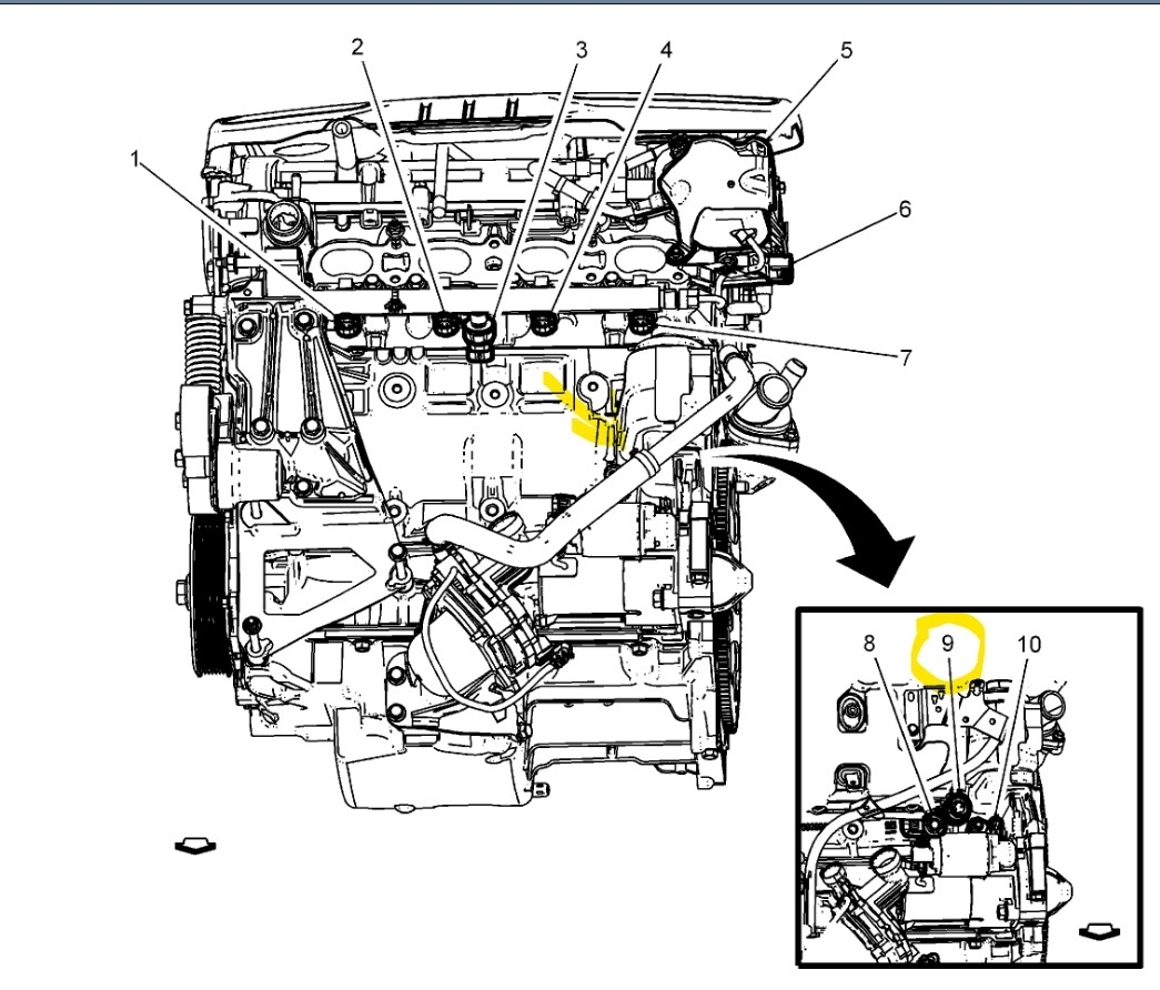

Where is the Oil sensor located for replacement?
2014 CHEVROLET IMPALA
114,000 MILES
JCENLEON
Need location of 2.4 liter oil sensor.
Dec 13, 2022 at 4:04 PM
STEVE W.
  • 15,200 POSTS
Open the hood and look at the oil filter housing on the front of the engine above the starter. The oil pressure switch is there on the lower section of the housing. You need the special socket to remove it and be careful tightening it as it is a taper thread and going too far can damage the engine block.
