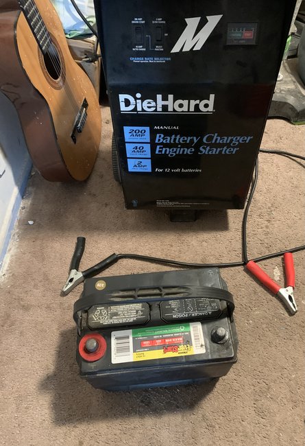

Thank you but I’m for sure running out, lol. I tried adjusting it but still can’t get it. I’m just going to bump the starter. The only problem now is that when I went to charge my battery, the cables got warm, so I took them off. My multimeter reads 11.63. Is that enough to bump the starter?
Friday, February 25th, 2022 AT 9:32 AM
  • 108,262 POSTS
Ariana,
Which cables got hot? Was it the ones on the charger or the vehicle? And yes, that voltage should allow you to bump it. However, moving the crankshaft pulley should do the same thing.

The battery wasn’t in my car when I was charging it. It was the cables on the charger.

If it was the charger cables, they may have been warm just from charging. That makes me feel a little better.

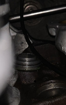

We are missing something simple with the pump. Nothing moved on the pump gear, correct? How far won't it seat for you? For example, 1/4th inch, more or less?
When you moved the intermediate shaft, did it feel excessively loose like it may not be attached on the opposite side?
Saturday, February 26th, 2022 AT 6:25 PM
ARIANADANIELLE5345
  • 310 POSTS
Should it have play at all? I mean it moves and it looked just like your picture. I will take a picture of how far I can get it in. The o ring is in so it’s almost there
Saturday, February 26th, 2022 AT 8:03 PM
  • 108,262 POSTS
It's close. Try putting the retainer on it and see if it pulls in that last bit. Don't force it, but it may just seat.

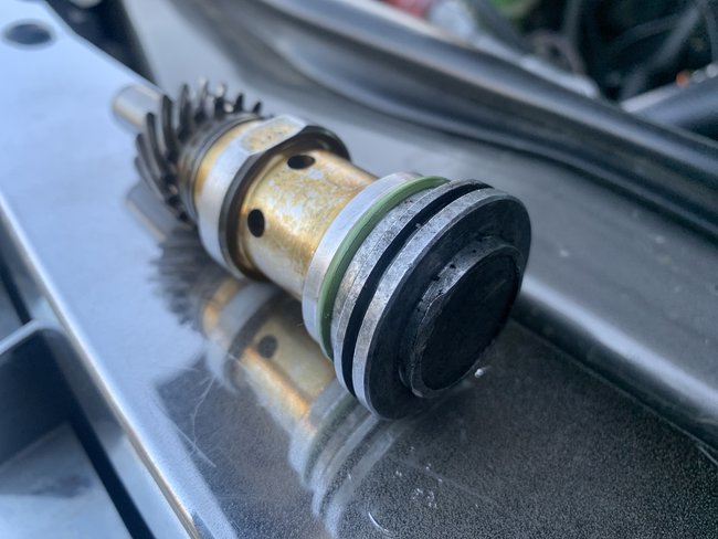

Maybe it’s the wrong o ring?
Friday, March 4th, 2022 AT 7:40 PM
  • 108,262 POSTS
Is this the same o-ring you removed with it, or have you installed a new one? Also, when you install it, are you lubricating the o-ring?
Friday, March 4th, 2022 AT 8:08 PM
ARIANADANIELLE5345
  • 310 POSTS
I thought it was the same one because it seems like it fits but maybe not. It’s green and pretty thick and yeah, I put clean oil on it.
Saturday, March 5th, 2022 AT 10:57 AM
  • 108,262 POSTS
If it's the same one, it should be fine. However, if it isn't the original, it can be causing a problem for you.
If possible, send me a pic of the o-ring. Also, do you have any laying around that may have been mixed up with the one you are using?
Saturday, March 5th, 2022 AT 6:01 PM

By the way, here is the o ring:
Monday, March 7th, 2022 AT 6:48 AM
  • 108,262 POSTS
That doesn't look too far off. Were you able to compare it to a new unit to confirm if it is correct?
Monday, March 7th, 2022 AT 6:50 AM
ARIANADANIELLE5345
  • 310 POSTS
New one comes on Tuesday. But I had an idea. Instead of taking the upper pan off and adjusting the shaft, I removed the o ring to see if the drive would fit because if it did then the problem is the o ring not the shaft and sure enough it fits perfectly. So, when I get the new one it should go right in.
