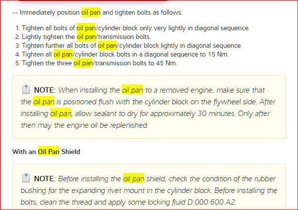

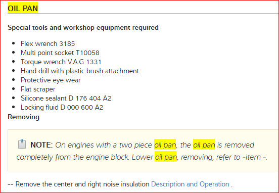

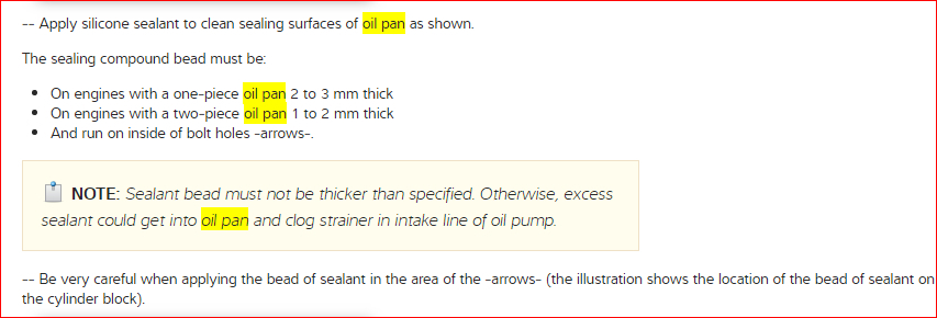

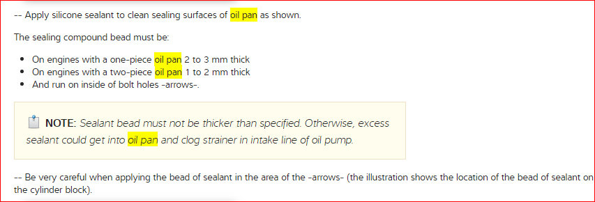

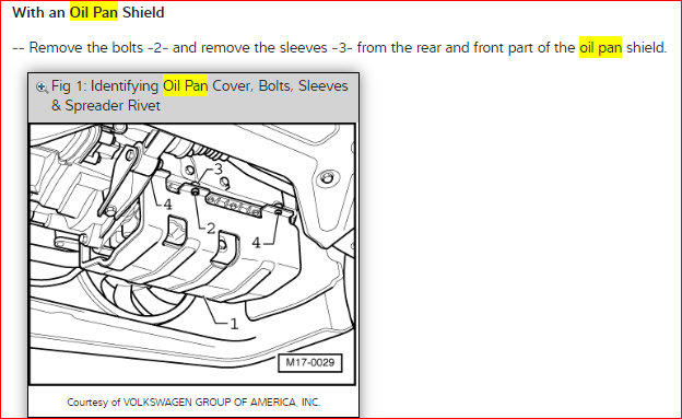

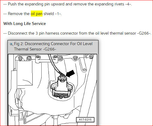

How can I replace my oil pan?
Sunday, December 30th, 2018 AT 2:44 AM
DANNY L
MECHANIC
5,648 POSTS

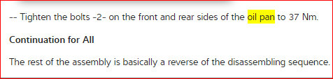

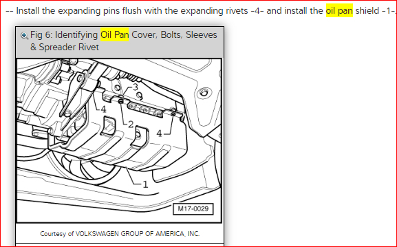

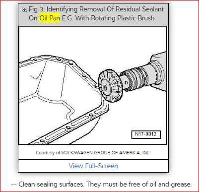

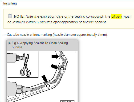

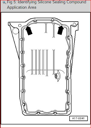

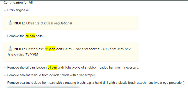

Hello, I'm Danny.
I've attached a series of picture step-by-step directions for the removal and installation of your cars oil pan. Here is a tutorial for you to view first:
https://www.2carpros.com/articles/engine-is-leaking-oil
Here are the pictures below.Hope this helps and thanks for using 2CarPros.
