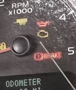

Should the oil light be on in dash with no start?
GLENN12345
  • 2006 HYUNDAI ELANTRA
  • 2.0L
  • 4 CYL
  • 2WD
  • 151,000 MILES
When I’m turning the motor only and or when I have key on. Thanks! Glenn
Sunday, January 1st, 2023 AT 10:33 AM
13 Replies
  • 110,194 POSTS
Yes, that is normal. Once the engine starts, oil pressure is built, and the light should turn off. Let me know if that is what is happening.

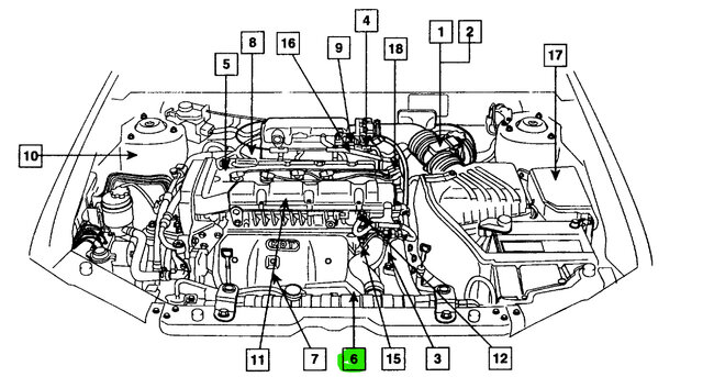

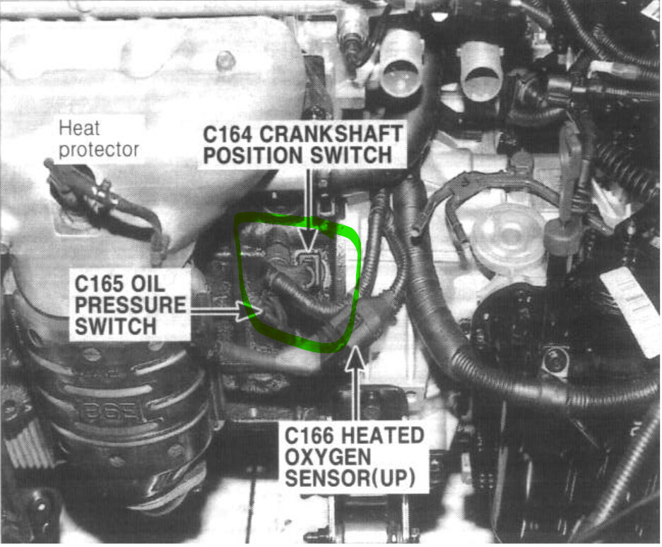

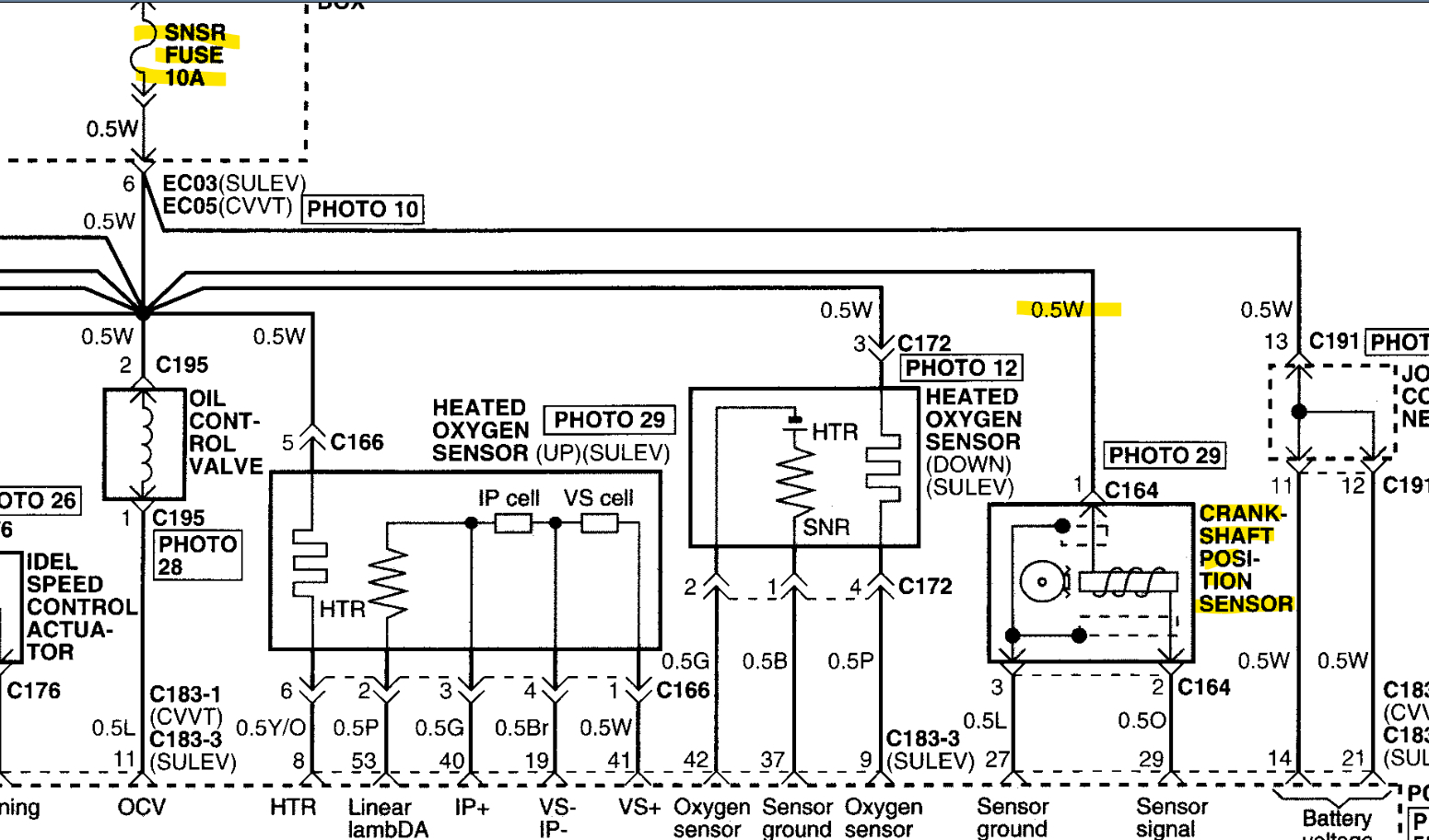

AL514
  • 5,596 POSTS

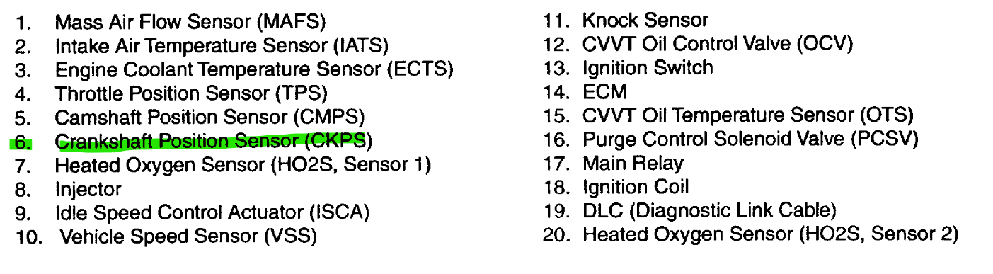

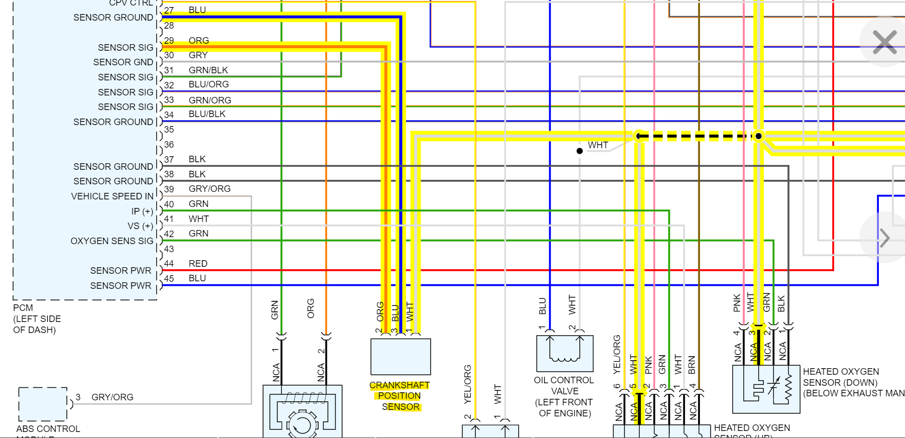

Hello, yes it should move a little bit, engine cranking speed is not as high as the idle speed, but it should jump a little. And that signal does come from the crankshaft position sensor. One other thing, if you're dealing with a crank no start, you should also watch for the check engine light, it should come on during the first Key On and go off when the engine starts. This indicates that the engine computer has powered up. If the crank sensor is faulty, you will also be missing ignition spark and most likely fuel injector pulse. Do you need the location of the crank sensor for your vehicle?
Here are the locations and diagrams for the crank sensor, it's best to check it for a 12-volt power feed and ground before replacing the sensor. Since this sensor grounds through the engine computer, you can check for power and ground with a basic multimeter set on a 20VDC setting, unplug the sensor and check across the White wire and the blue wire with the key "on". Reading 12-volts will verify power and ground with that one test.
