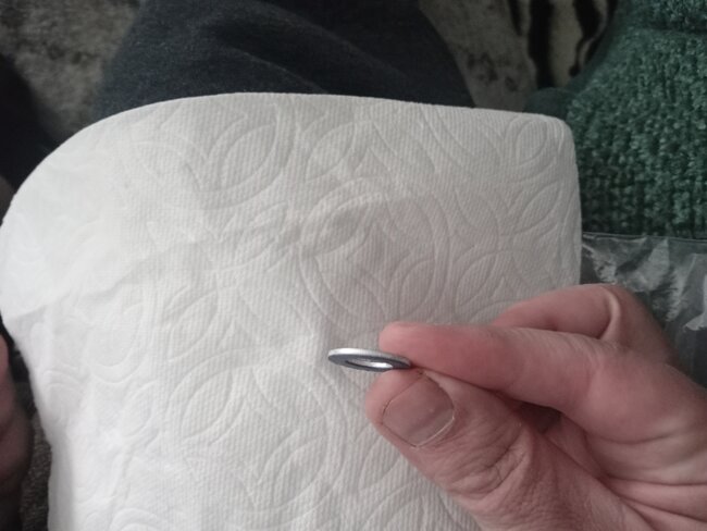

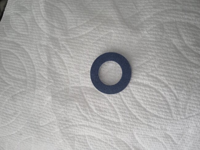

When I drain oil to do oil changes, I find always the oil pan drain plug loose. I already changed the oil drain plug and always torque it to 27 ft-lbs. I use Toyota blue plug. See picture.

Usually that means the threads in the oil pan are worn and the plug loosens up from the heat cycling. The common solution is to use a tap to create new threads in the pan that fits a slightly larger drain plug. There are self-tapping ones that will cut their own threads, you can use one of those and then replace it with one that doesn't cut new threads. The other option is to use a kit to install a threaded insert in the pan to replace the aluminum threads with steel. Both work. What I do with either is to pull the old drain plug, drain out the oil. Now do the repair and once done, dump the old oil back in. Now drain out the oil and that should also flush out any chips. With either method of repair you will want to coat the threads or tap with grease to catch chips as well. You can get both types of repairs at a parts store.

They might look good and still be worn. When you put the plug in can you rock it around in the hole? If yes, they are worn. You say the plug keeps getting loose. If you are tightening it to the proper torque with a nylon or copper washer and it loosens up, the threads are worn. Once torqued it should hold the torque value until removed.
Feb 6, 2025 at 10:08 AM
BENEFITS1976
  • 38 POSTS
the plug does not rock. I do not use nylon or copper washer I use those showed in picture. I will do next time and see.
Feb 6, 2025 at 11:29 AM
STEVE W.
  • 15,172 POSTS
That looks like aluminum. If torqued properly it shouldn't loosen up either but I prefer copper, then nylon, then aluminum.
