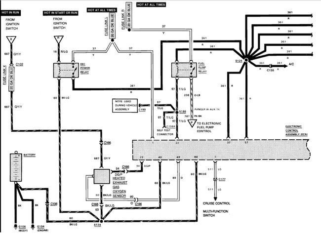

It sounds like you are losing power somewhere. Here is a guide to help you run the codes:
https://www.2carpros.com/articles/ford-lincoln-mercury-obd1-1995-and-earlier-diagnostic-trouble-code-definition-and-retrieval
Next lets make sure we have compression.
Check the ECC relay.
+1

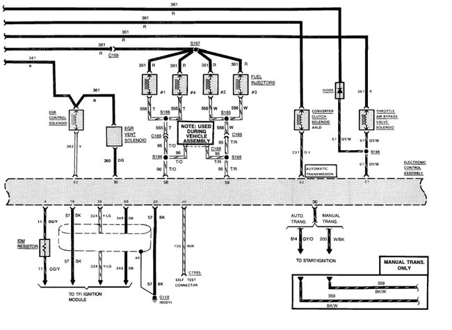

Did you ever check the ECC relay also can you check to see if the computer is getting power and has its grounds? Use the wiring diagrams above.
Monday, May 14th, 2018 AT 11:22 AM
WINFRED
  • 10 POSTS
I checked the ECC it is powered up all the way through followed all the instructions it is good found out that my number two on. My fuel pump relay is not reading correctly I have.76 on voltage. I am going to borrow Antonio to find where the wire goes try and find where the break is hopefully I will be able to I will let you know something. I do appreciate your guidance!

I checked out the easy sheet it is all good. I went to their fuel relay and it has a box of wanted to drop or number three pan and a half hours a week, lied on number one Penn. I am getting closer to watch wrong it was not doing this before but so off I go chasing. Do you have any ideas on where to go and see where the power drop? We also checked my key and I get a 10% let’s see it is 1230 both ditch with the key off and it drops off. 40 after I turn the key on.
Monday, May 21st, 2018 AT 6:48 PM
KEN L
  • MASTER CERTIFIED MECHANIC
  • 55,538 POSTS
Did you install the new PCM? It sounds like you, did but I want to make sure. If so you will need to check all power and grounds to the unit.
