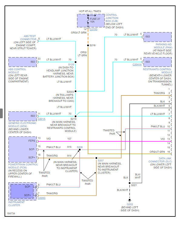

I know it's not the cigarette lighter and more than likely it's fuse 27 or 23.
Monday, August 29th, 2022 AT 9:34 AM
KEN L
MASTER CERTIFIED MECHANIC
55,281 POSTS

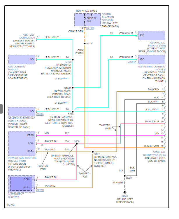

It is fuse #27.
Here is a guide to help you test it for power and I have included the ALDL connector wiring diagrams so you can see how the system works:
