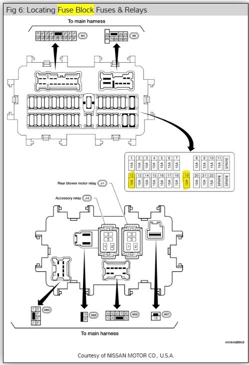

There is no power going to OBD 2 connector?
2012 NISSAN ARMADA
152,000 MILES • V8 • 2WD • AUTOMATIC
WJENN5
I can't find which fuse it's paired with.

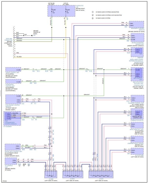

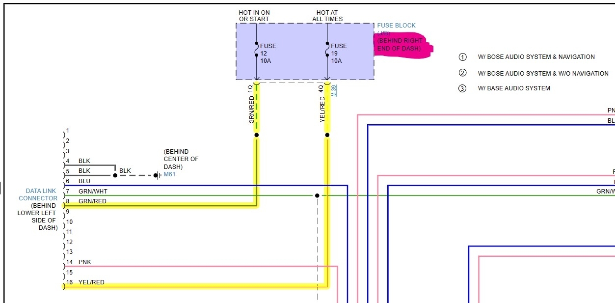

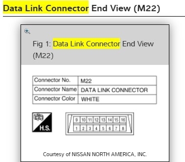

I am also attaching a wiring diagram for the OBD 2 connector and the connector end view.
On the connector itself it looks like 8 and 16 should have power. You can use the test light to check for power at those terminals while referencing the connector end view image I have included and connecting to a known good ground.

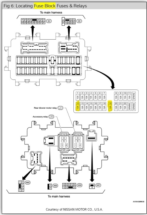

I have also sent a diagram of the fuse box and highlighted the fuses that give power to that connector according to my info.
My information is telling me the fuse box for the OBD 2 connector is in the vehicle behind the right end of the dash. Let me know if you can find it because my information isn't telling me a more exact location. I will continue to look for you though.
