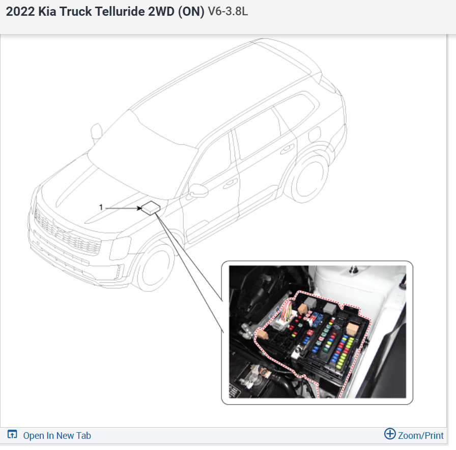

OBD Port not working, need fuse location?
2022 KIA TELLURIDE
55,000 MILES
GIRLDAD12121

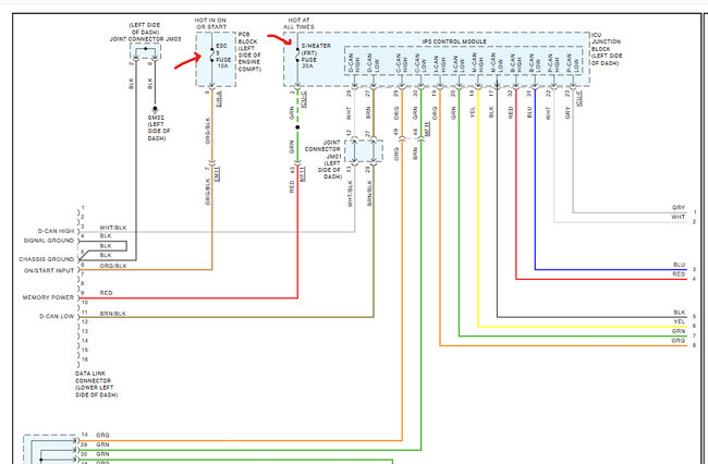

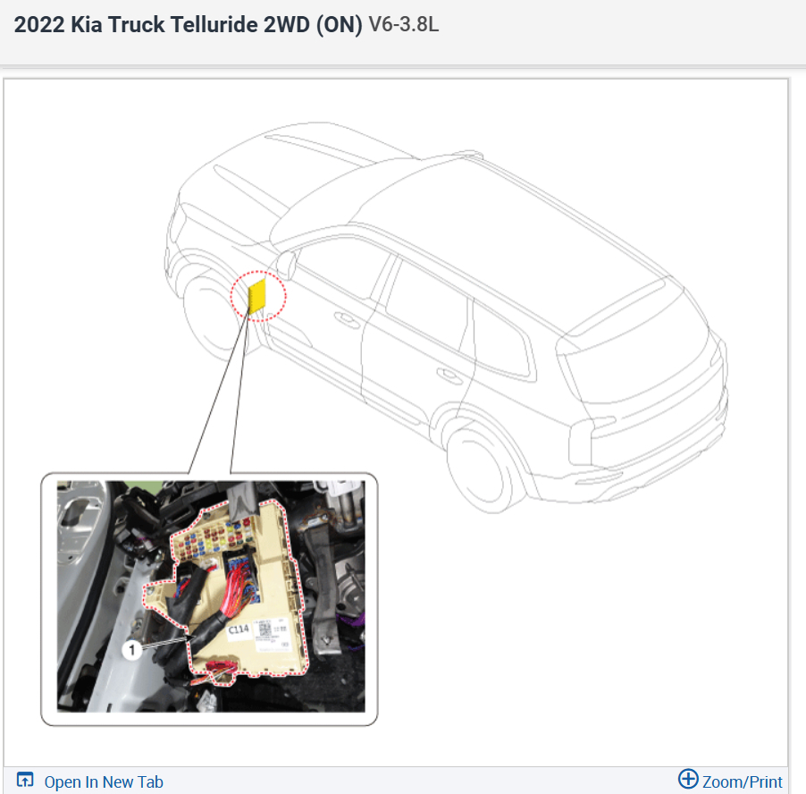

I saw your video regarding the OBD port not working/changing the fuse. That is precisely the problem I’m having, but I cannot find anything that provides the fuse location - I’ve checked the interior fuse panel as well as the engine compartment fuse panel, nothing referencing OBD. Please help! $20 to your site if you can find the answer!

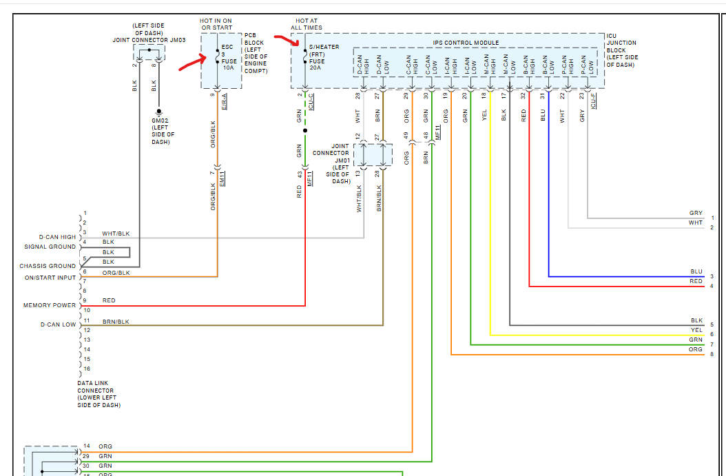

Thank you, I would check to make sure the scanner works in others cars, there are two fuses that run the data port, ESC fuse on the left side of the engine compartment, and the s/heater fuse which is at the fuse panel on the left side of the dash. Here is a guide to help test them and the wiring diagrams for the data port so you can see how it works:
https://gofund.me/c7d318ad or https://www.paypal.com/ncp/payment/VTBAJSABCQ2CN
Check out the images (below). Let us know if you need anything else.
