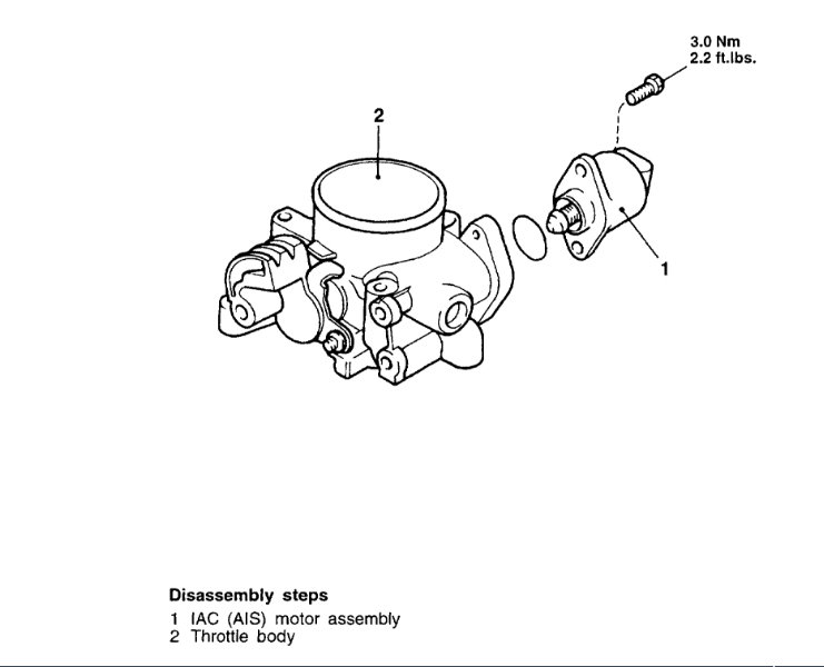

Picture attached.

The opening for the throttle is facing away from the firewall and not up. Is that just the placement of the picture?
Friday, June 29th, 2018 AT 5:49 PM
  • 52,797 POSTS
Yes, just for reference.
Friday, June 29th, 2018 AT 6:00 PM
MAGSENTONE
  • 85 POSTS
Yeah, it is sandwiched between throttle body and firewall. Kind of hard to get to or get a tool to take it off. Any ideas and does it need to be cleaned or is the throttle plate and walls enough?
Friday, June 29th, 2018 AT 6:08 PM
  • 52,797 POSTS
Throttle body definitely needs to be cleaned. The IAC should be removed and the passages cleaned out. You cannot clean the idle air control valve.
Friday, June 29th, 2018 AT 6:13 PM
MAGSENTONE
  • 85 POSTS
Yes, I meant the passages and not the part itself. Thank you so much. Roy!
