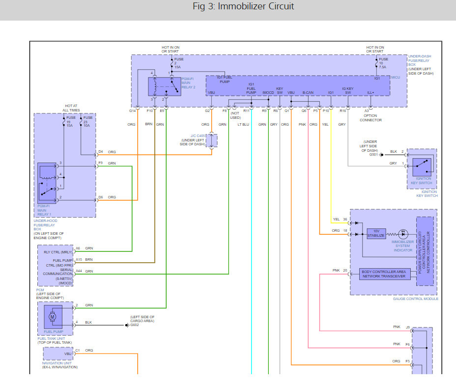

Hi, the vehicle listed above is an EX model. The Immobilizer loses chip and key fob recognition when it is freezing cold repeatedly. I reset by unplugging the negative battery cable for 30 seconds and it starts working as normal. Any suggestions I replaced immobilizer ignition ring ignition switch and starter relay already works great except that, dealer have checked module and wiring for short they got vehicle for a month already.

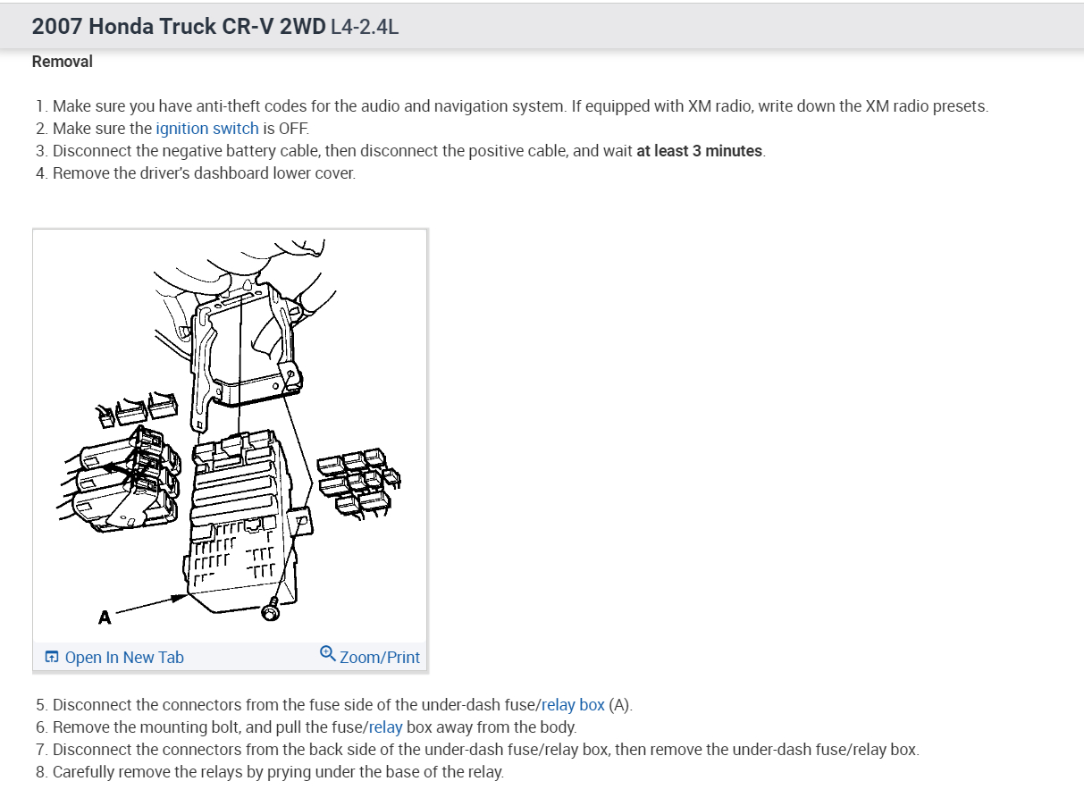

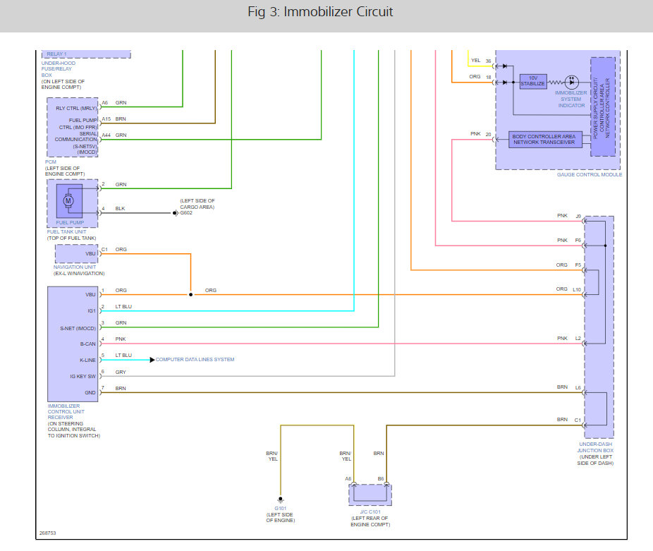

Yep, the cold can cause the electronics to go out. I have seen the MICU go out which is a part of the fuse panel. Here are the wiring diagrams for the immobilizer system so you can see how the system works. There is an outside chance the dash cluster is bad as well, but I am leaning toward the MICU. Here is how to replace the unit so you can see what needs to be done. Check out the images (below). Please let us know what happens.

Good info. I am sourcing Micu How much Shop time will it take to swap and reprogram Key fob.
