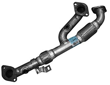

I am having trouble locating both oxygen sensors on bank 2 for my car. can you point me in the right direction?

Should be one on each bank before the converters, then two in the crossover pipe that connects the two converters to the pipe feeding the rear converter, it is not monitored. You can see the ports in this picture.
