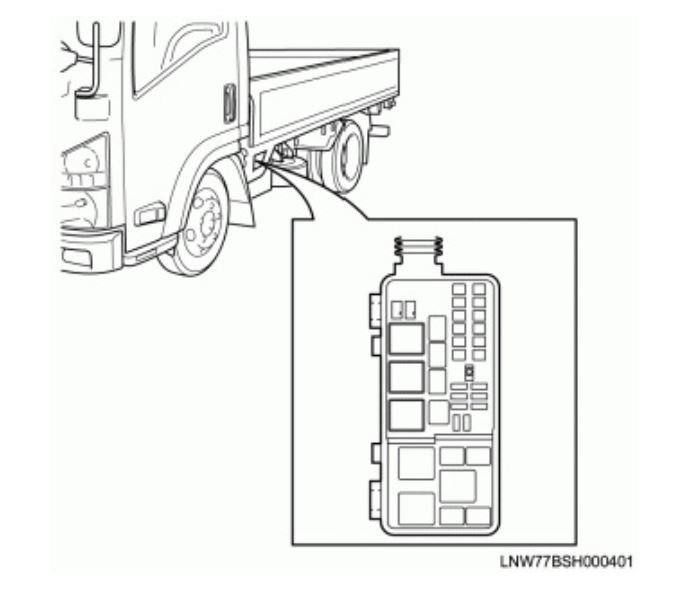

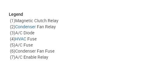

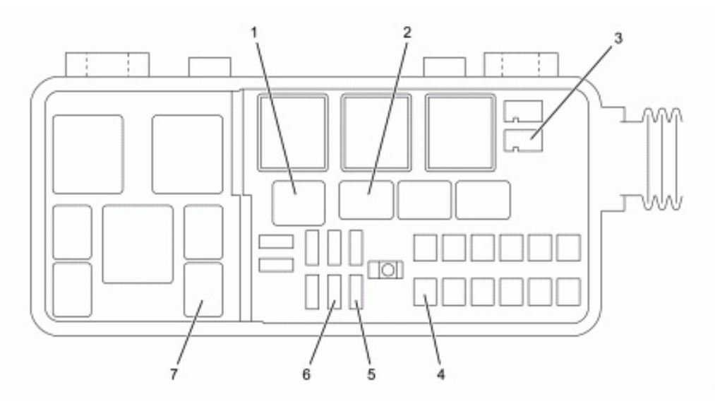

I am looking for the relay for my air conditioner in my vehicle listed above NPR 200 Model.
Tuesday, January 28th, 2020 AT 11:42 PM

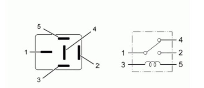

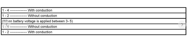

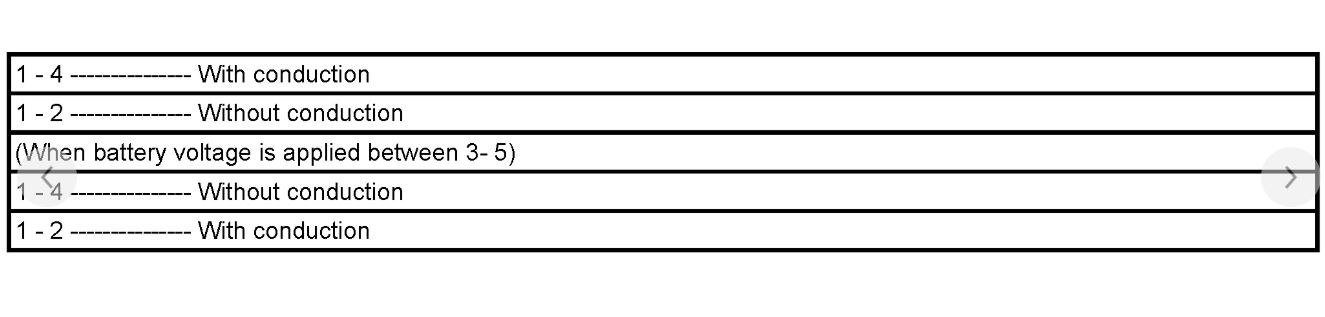

Good morning, I attached the location of the relay #7 for you as well as the legend for the fuse block of the other relays. This guide will help you test it
Let us know if you have any other questions. Check out the diagrams (Below). Please let us know what happens.
