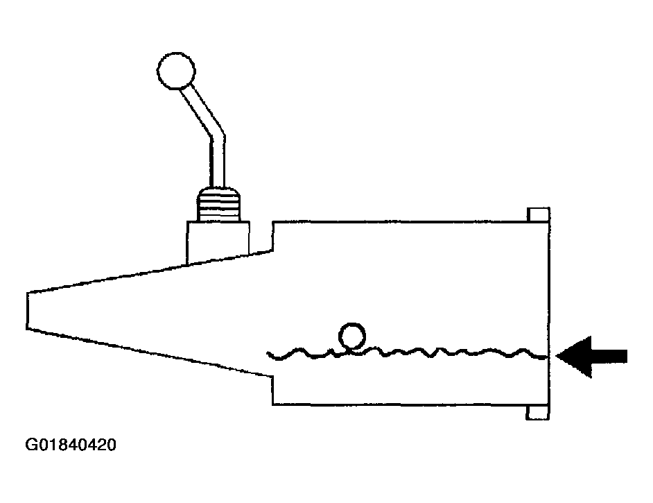

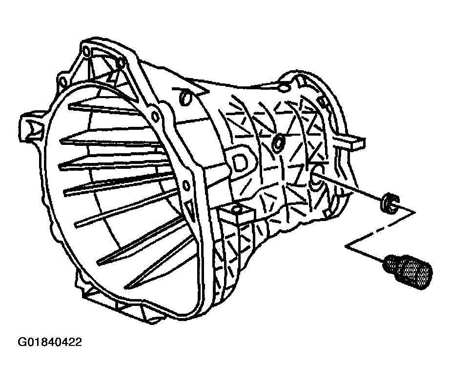

I have an '01 chevy s10 2.2L 5-speed, and Im desperately needing to check the transmission fluid, however, I dnt know how to. It does not have a dipstick and I dnt know where to look on the transmission.

It has a plug in the side of the transmission. You remove the plug and stick your finger in and see if you can touch the fluid.

Level ground--fill with CORRECT FLUID--auto parts store will know what type!
Fill until it will hold no more, and starts coming out fill hole.
Pic 1) There were several choices, I grabbed one, without further specifics on your rig!----Location of fill hole is on the side(drain is probably on the bottom)
pic 2) Fluid level inside the tranny

Plug on right side of trans remove oil will run out if full. Adding is a little tricky squeeze bottle and hose etc.

There are two large allen head drain and fill plugs onside of transmission. The lower plug is the drain The upper one is the fill. When filling wih fluid pump fluid in top till it starts coming out the top. Then install plug.
