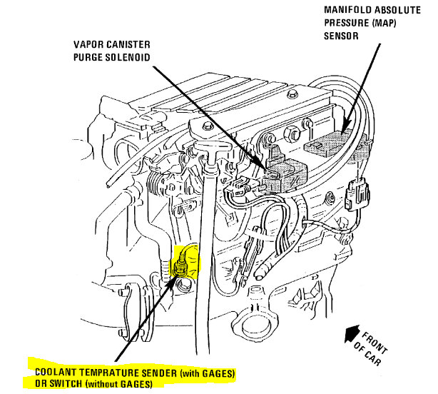

Code 14 is related to the engine coolant temp sensor. I suspect that is the problem.
In this case, it indicates the coolant is 275 degrees F. Is it overheating? If not, replace the sensor. It is causing the fuel mixture to be too lean.
I attached a pic below showing the location.
Also, the other code is for an O2 sensor. That one could be the result of the lean fuel mixture being caused by the ECT.
Let me know if that takes care of the problem.
joe
See pic below.

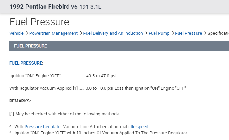

I’ve checked it with a fuel pressure gauge, and it seems to hold well. I’ve even tried starter fluid and it doesn’t seem to help. I have to crank it 7 to 12 times before it will try and run.
Wednesday, July 5th, 2023 AT 7:54 AM
  • 110,192 POSTS
What pressure did you get when tested? See pic below. Also, if you remove the vacuum hose from the regulator, is there any evidence of fuel being drawn through the vacuum hose?
See pic below.
Thursday, July 6th, 2023 AT 8:36 PM
LUKE2004
  • 9 POSTS
It would hold right around 41 psi. I grounded the fan out so that it would run when the ignition switch being turned on. I was able to get it started and let it run for about 20 to 30 minutes. The temperature stayed cool right around 185 to 190 the car seemed to be running fine and idling fine, so I drove it about a mile down the road and when I went to put it in park it started to try and shut off again. I drove it the rest of the way home but when I let off the gas for it to idle it would sputter and shut off.

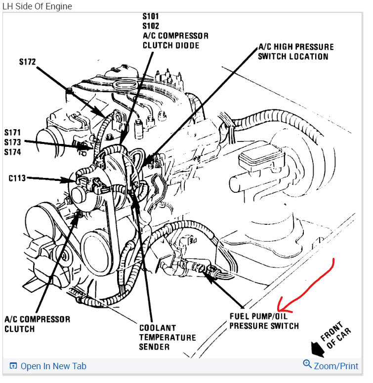

I have seen code 13 which I have seen them short out when hot and cause the problem you are describing. Also, when the engine cuts off does it have spark?
This guide can help:
https://www.2carpros.com/articles/how-to-check-for-ignition-spark
13 - Oxygen sensor circuit open.
14 - Coolant sensor high resistance or shorted.
Also, there is a fuel pump oil pressure switch I have seen go bad and cut the fuel pump off until the pressure returns in the sensor. So, let's make sure the engine oil is clean and full. Check out the images (below). Please let us know how it goes.
