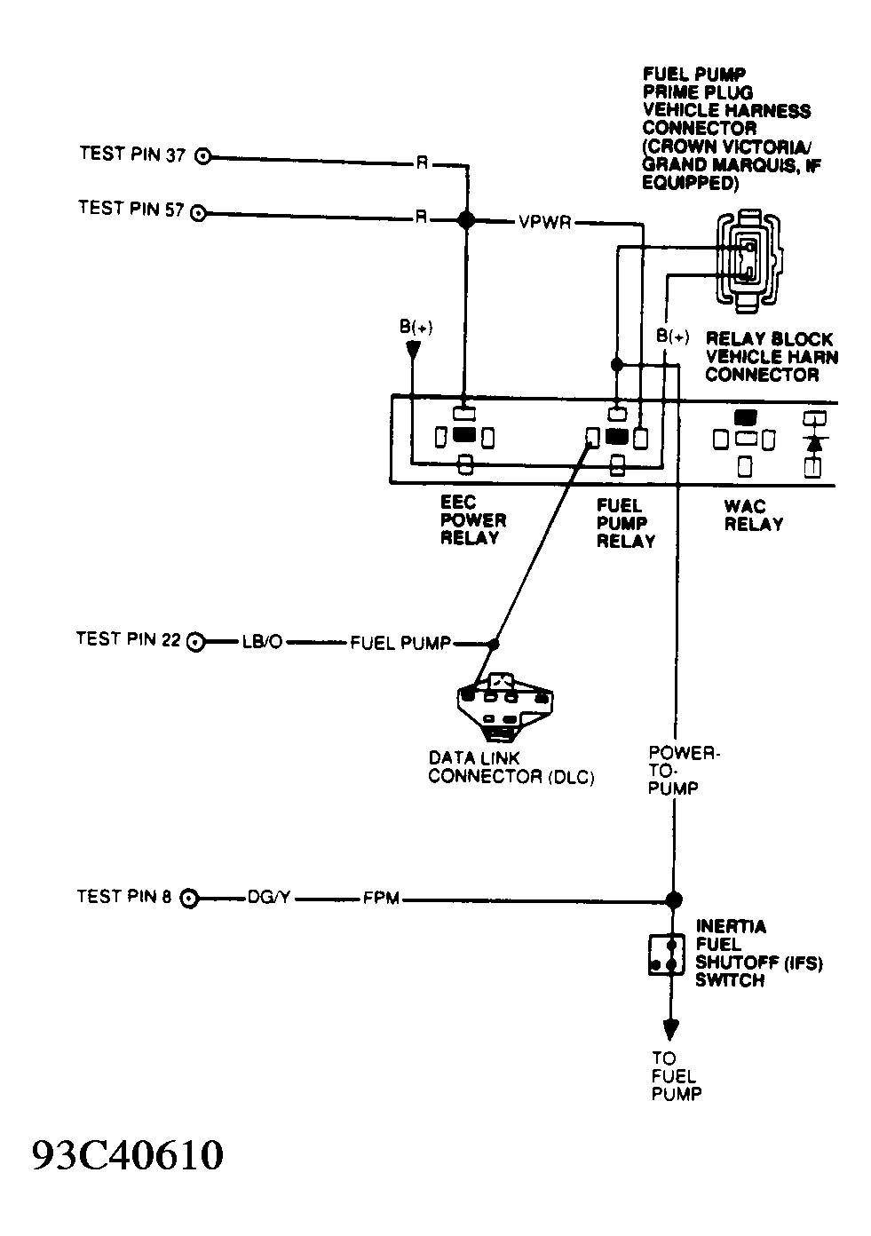

Was driving down the road and engine just shut off no warning. Car has spark so changed the fuel pump, filter, and oil pressure switch. I checked the relays and the relay switch in trunk all good. Not sure where to go from here please any help is good thanks.

Ok, your not getting spark so you changed fuel components? If it isnt your security system that has caused the problem (if equipped). Is there a transponder on the key? I would most likely suspect a crank position sensor. When they go bad you will lose spark and injector pulse. Do you know if you have injector pulse?

Dont have secruity or a transponder I am getting spark just no fuel to the engine and yes changed fuel pump and filter not sure if I have injector pulse when I turn the car over im not getting the fuel pump to prime or turn on

Ok, You need to check to see if your getting power to the pump when the key is turned on. Get a test light and check for power at the connector immediately after they key is turned on.

Im getting 11.5 to the pump but nothing when I turn the key over or crank it

Does this car have an inertia switch? I think it may be in the truck on the side behind the carpet. See if there is one and make sure the button is pushed down.

I check that switch even switched it with one that was working thats all good

Have you tried using a jumper wire at the fuel pump relay terminals to see if you can manually get the fuel pump to turn on?

Here is a photo of a wiring diagram

No have not tried that not sure on how to do that but I did fuel pump relay with the ac relay they are both the same and still nothing

Do you know where your data link connector is (OBDI)? Take a paper clip or wire and jump the pin 1 and pin 4 of the data link connector and see if you hear the pump turn on.
