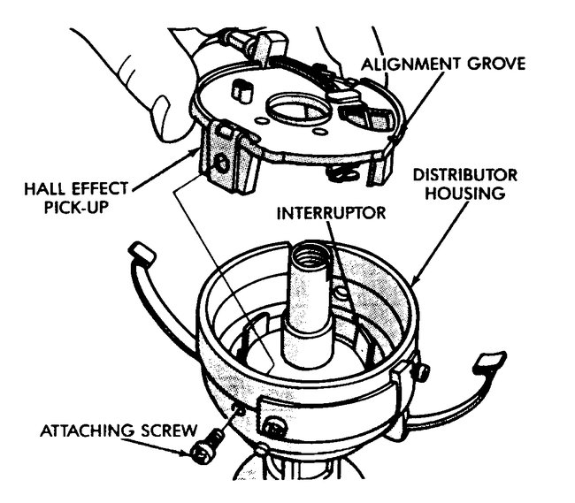

I have fire going to the coil but no fire going to distributor. If I put a test light coming out of the coil that lights up but if I put the coil wire to something that is not sparking.

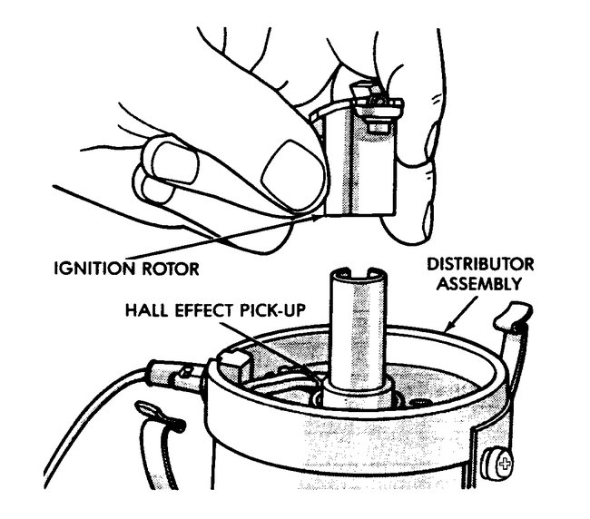

If you have no spark but there is power at the coil, it sounds like the pick-up coil is bad. Here are directions for replacement. It is in the distributor and takes about fifteen minutes to replace.
_
HALL EFFECT PICK-UP ASSEMBLY REPLACEMENT (3.9L Engine)
REMOVAL
1. Remove distributor cap. See Distributor Removal and Installation 3.9L Engine.
See: Distributor, Ignition > Procedures > Distributor - 3.9L Engine
Ignition Rotor Removal And Installation - 3.9L Engine
2. Remove ignition rotor from distributor shaft.
Hall Effect Pick-Up Assembly Removal And Installation - 3.9L Engine
3. Remove two hall effect pick-up attaching screws on opposite sides of the distributor housing and carefully lift the hall effect pick-up assembly from the distributor housing.
INSTALLATION
1. To reinstall hall effect pick-up assembly, follow the preceding procedure in reverse
order.
