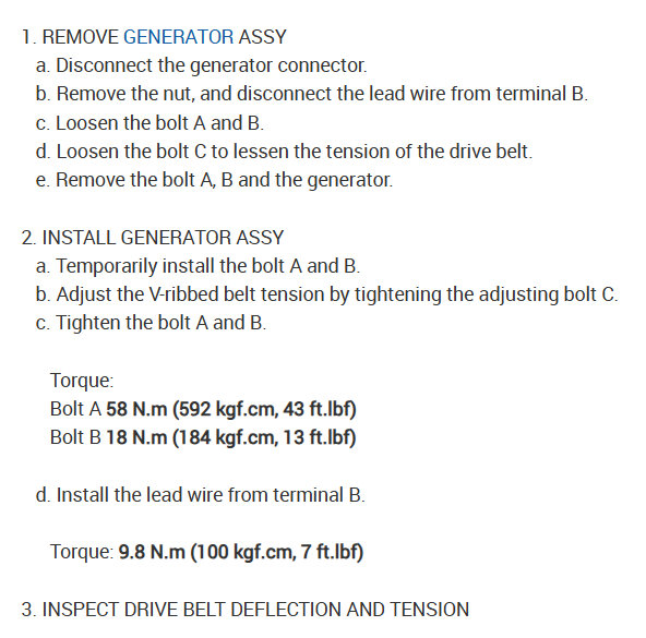

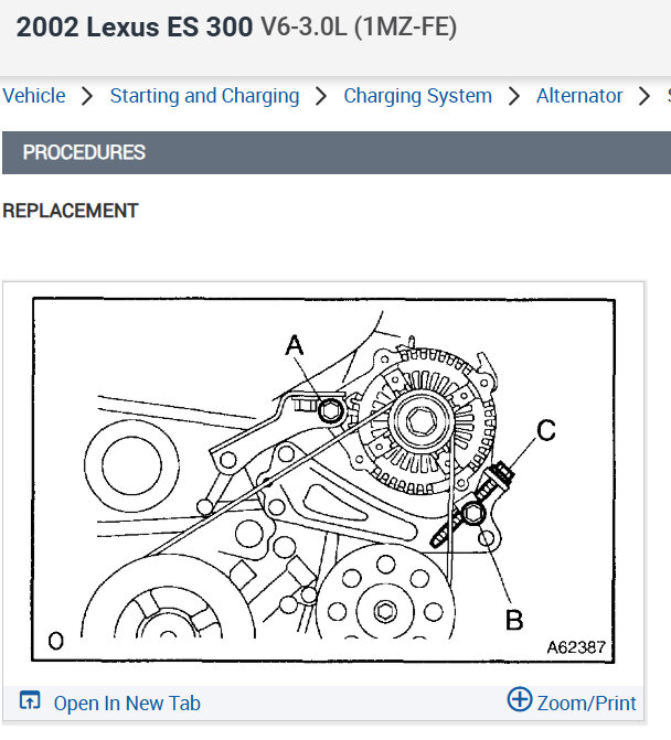

I was losing power going down road so order another alternator, but it still loses power under load it seems to start and idle good at first but then if you turn on enough things started losing power. I'm pretty sure I got the manual tensioner right there is good tension on the belt I'm not sure what to check next.
Feb 25, 2025 at 7:44 PM
  • CAR REPAIR CONTRIBUTOR
  • 54,193 POSTS
Is the battery warning light on while you drive? When the engine is running let's check the alternator voltage output, here is how:
If the alternator fails the test, then it needs to be replaced, here is how. Make sure the belt is tight as well. Check out the images (below). Please let us know what happens.

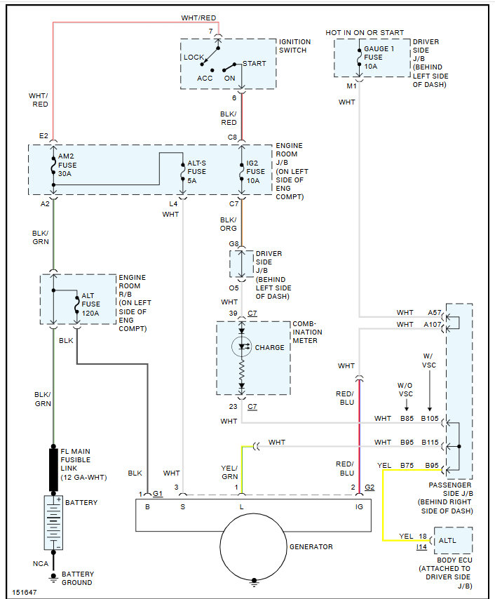

If the engine cranks okay chances are the battery is okay, but with the engine running and you get 11.43 volts this a problem, I would check the fuses: Gauge 1, ALT, AM2, ALT-s and the IG2.
This guide can help:
Here are the wiring diagrams for the charging system so you can see how it works. Check out the images (below). Please let us know what happens.

Fuses all look good.
Mar 4, 2025 at 5:54 AM
  • 54,193 POSTS
I am sorry to hear that, glad you are okay. Does the battery warning light come on when the key is on, engine not running? The system sounds like it is still not charging. If the fuses are good and the battery warning light comes on it sounds like you have a defective alternator. Once you swap out the alt, start the engine and use the voltmeter to check the charging voltage, (engine running).
