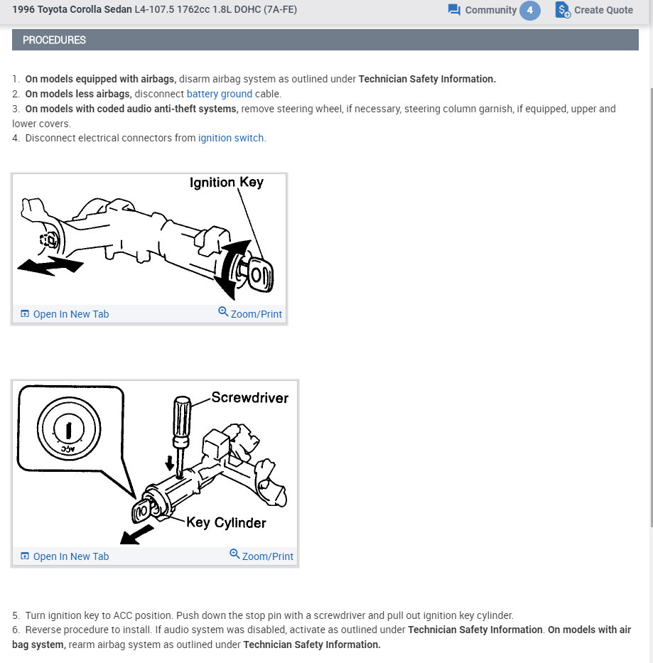

Car will not start immediately, turning the key makes a clicking sound. Started not working with spare key. Started using the heavier original key, work for a while. Now same thing. Turn the key 10 to 20 times and it starts. Replaced the cylinder lock with new key, did not work. Has to be a electrical issue. Once started it keeps running, so the starter switch is not the problem, right(?)

Hi RSRNFL,
Just to confirm, you replaced the ignition switch shown below?
Also, when this happens, you said it clicks. So the starter clicks every time you turn the key until it finally starts?
If you replaced this, then I suspect you do have an electrical issue but at the starter. I think changing keys may have been a coincidence (assume the ignition switch is new).
Next time this happens, try putting jumper cables or a jump box on it just to rule out a voltage issue.
The most likely thing if you battery, ignition switch, and wire connection at the starter are okay, is the starter itself.
Let me know what you find and we can go from there. Thanks
