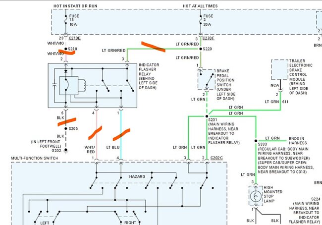

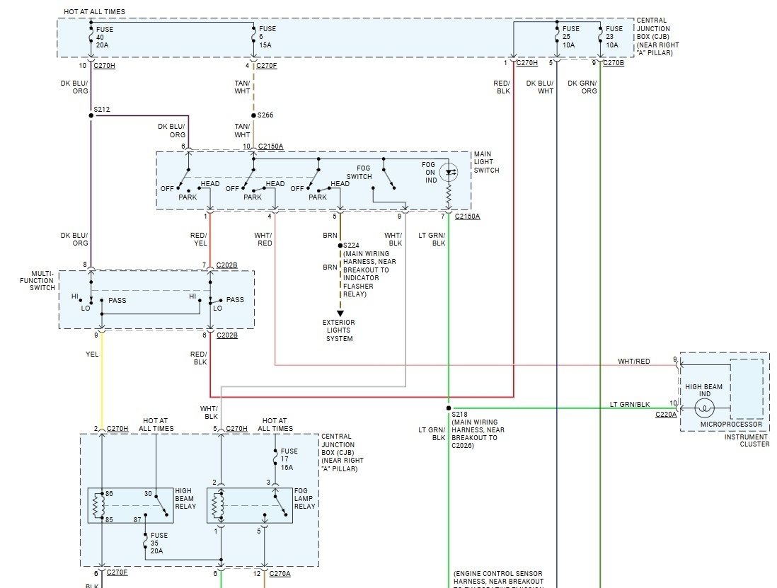

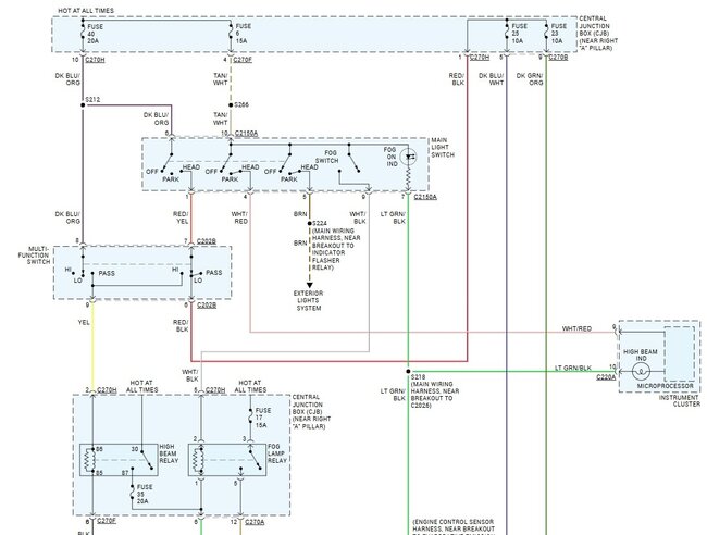

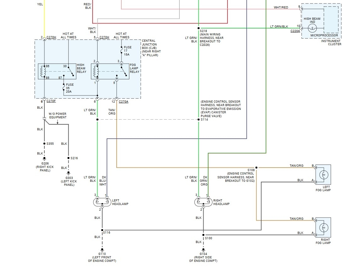

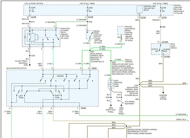

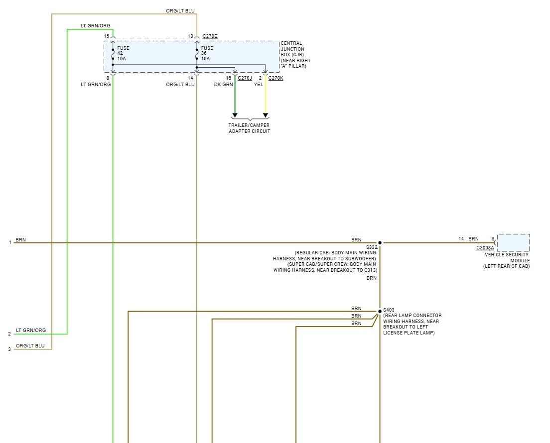

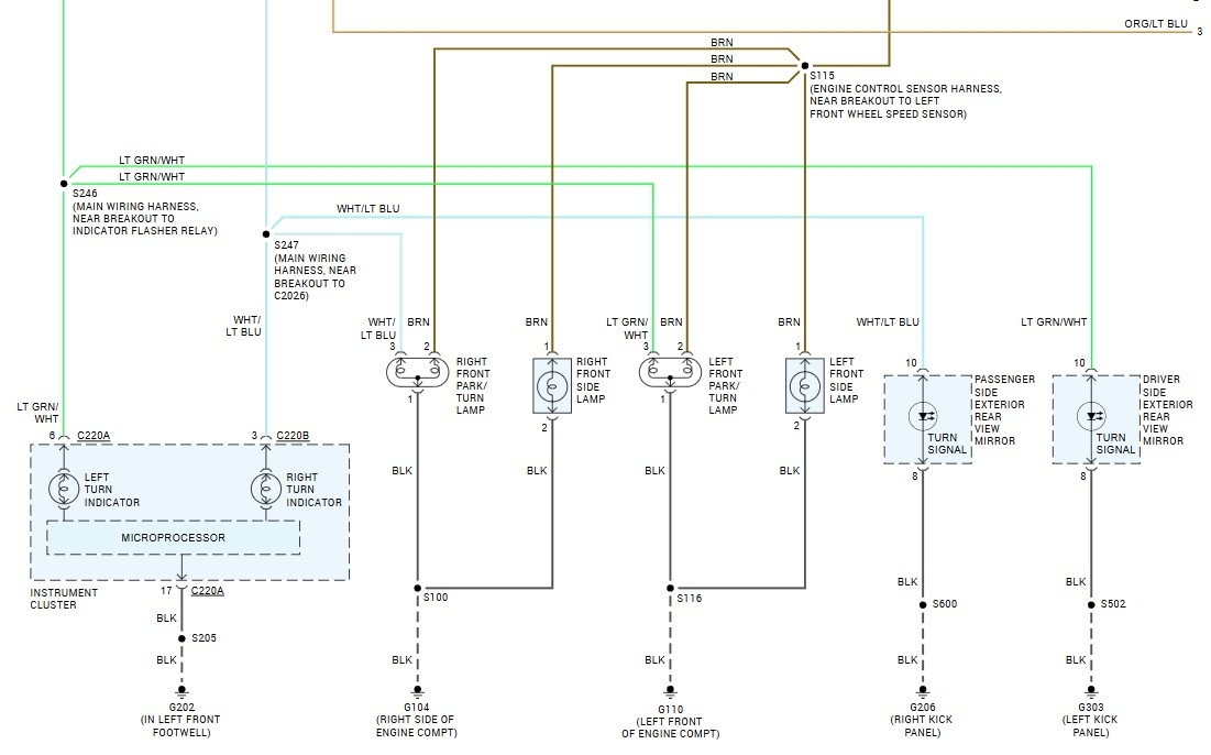

Okay, the lack of DRL and auto-lights should make it a bit easier. This does have all stock lights correct? Have seen some of the LED parts cause problems. Attached is the full diagram for the marker and turn lights as well as the headlights. The issue with the dash indicators being on as soon as the key is suggests there is power feeding back into them from somewhere, but none of the circuits should have power in them without the lights being on because the indicators should only be powered when the switch for turn or hazard is on. As much of a pain that it is you might try to narrow down where that is coming from by pulling fuses. Get it so the lights are on then pull Fuse 2, 6, 13, 23, 25, 36 40 and 42 one at a time to see which is feeding voltage back.

Yes, they are all stock bulbs. The fuse layout was very helpful, thank you and when I get back down there, I'll try this. Maybe Sunday, weather dependent here in SE Wisconsin.

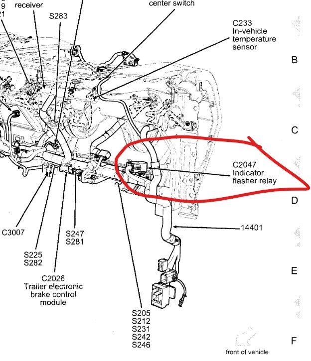

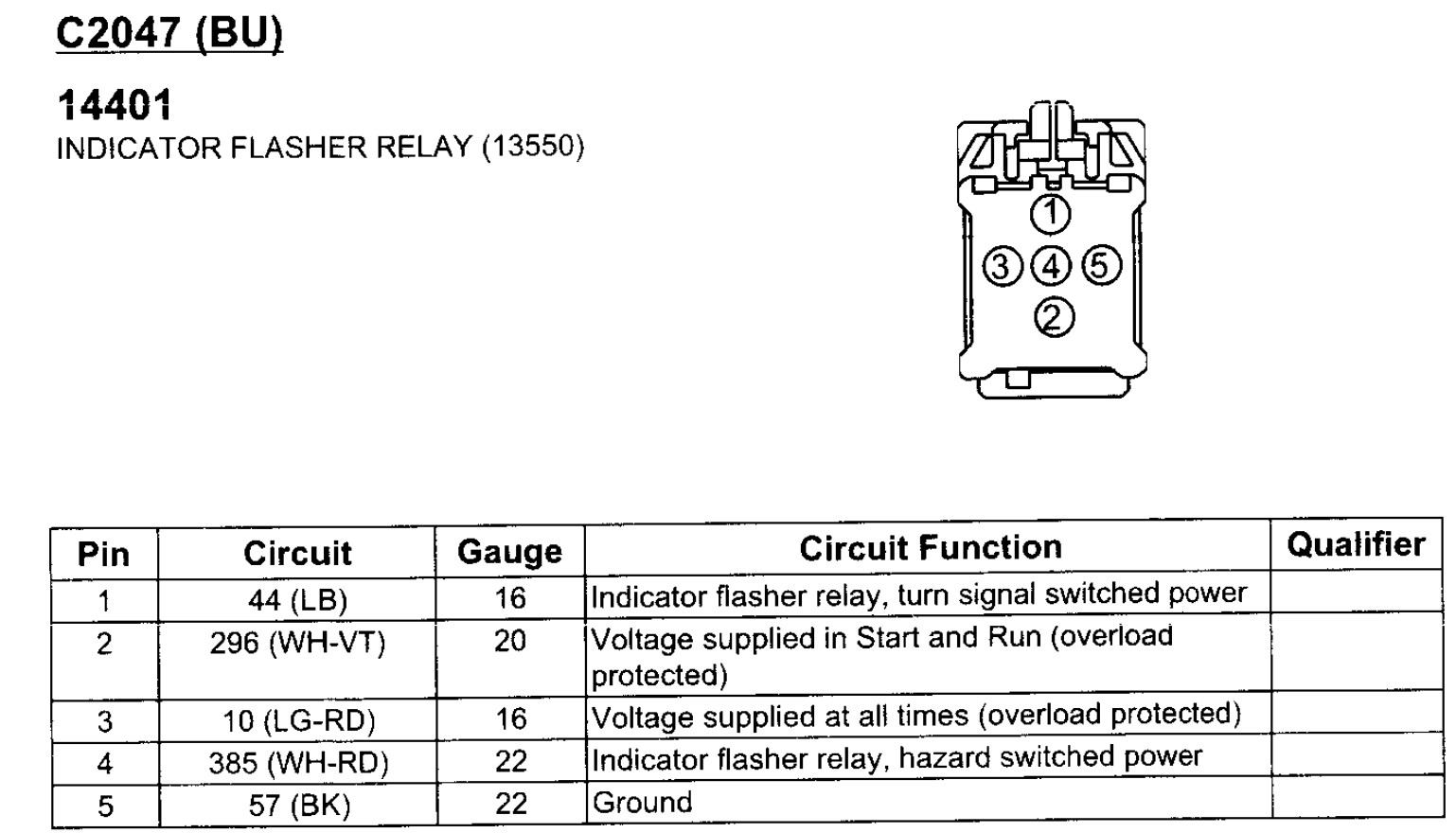

Okay, fuse 13 powers only the flasher relay. The most likely item would be if the flasher relay has failed as a switch failure causing this type of issue would be very odd but not impossible. To test if it's the switch would be to find the flasher relay, remove it and then apply power to pins 1 and 4 and see if either one lights up the indicators. If it does, then move the switch and see if the lights change. If not, then it's the switch. If however, the switch actually turns on the correct lights, then it's the flasher.

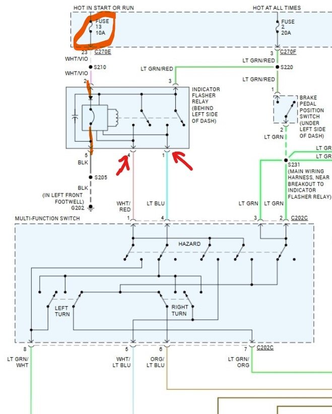

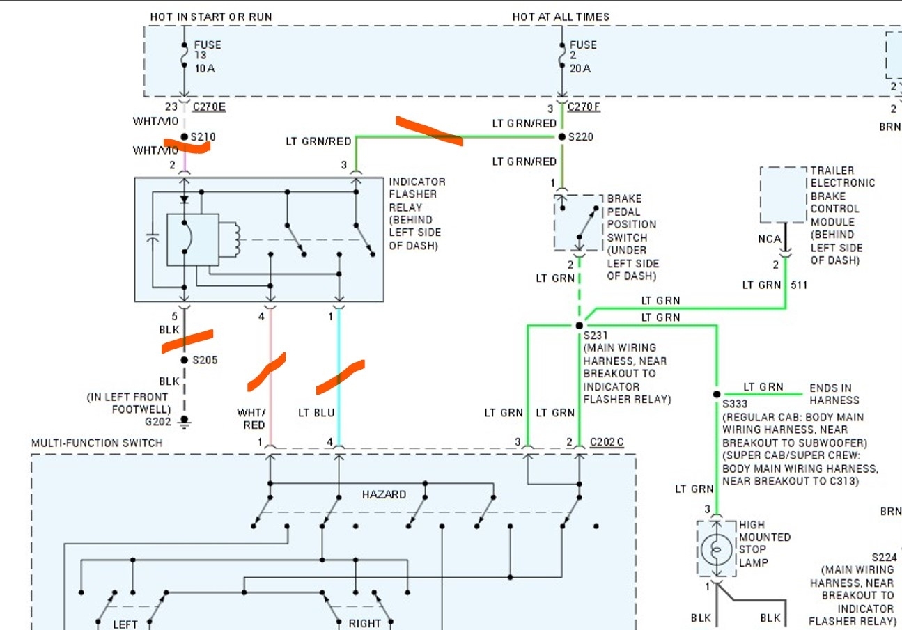

I want to clarify the test. Ignition on, relay out, power to which wire for the turn signals? I don't own a power probe yet so I'm running a wire from the positive battery terminal. I'll have to rerun the test as I was only looking at the dash indicators, not the actual outside bulbs. Am I powering the white/red wire or the lt.blue? Sorry but electrical is not my forte.
Jan 30, 2025 at 7:41 PM
STEVE W.
  • 15,172 POSTS
Should be the blue wire but you can test with both.

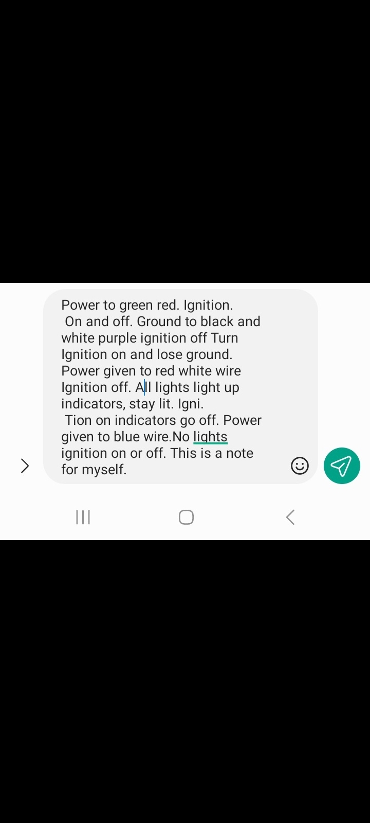

Here's a breakdown of the testing I did today. One time when I applied direct power to the blue wire the front and back turn signal bulbs lit and I could manually flash them with the switch. I couldn't repeat this. Fuse #2 has power in and out, but I can't locate or trace the wire from the back. Could this be an ignition switch issue? I'm currently at a loss.

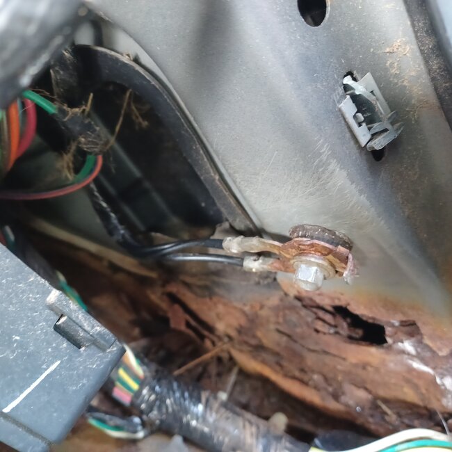

All fixed. Fuse block showed ground but wasn't grounded. I relocated these two ground wires.
Mar 10, 2025 at 7:06 PM
STEVE W.
  • 15,172 POSTS
OOF, just a bit of rust. Looks like a NY vehicle..

The crazy thing is those wires initially showed ground.
Mar 11, 2025 at 5:40 PM
STEVE W.
  • 15,172 POSTS
The fun part of electrical diagnosis. I suspect that it was showing a ground through the other wiring.
