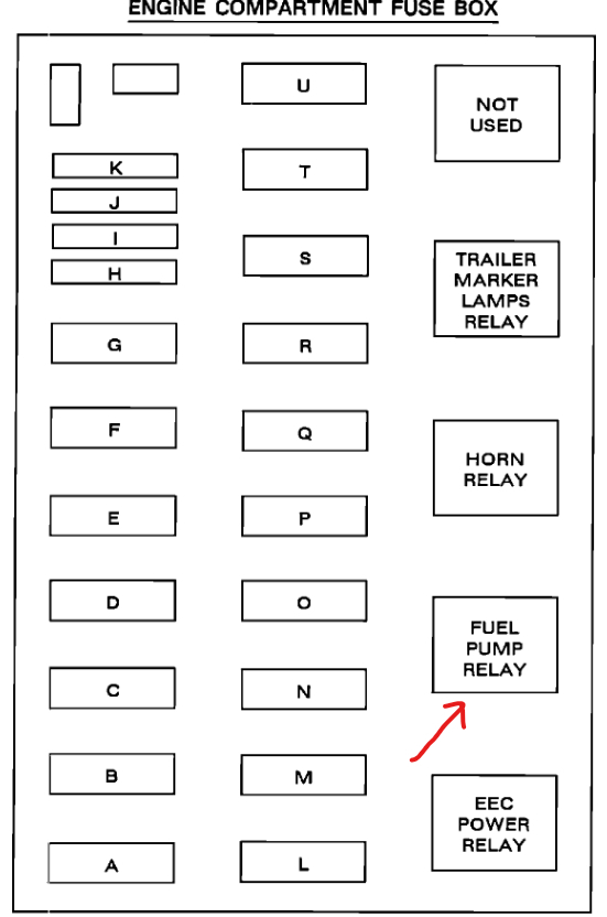

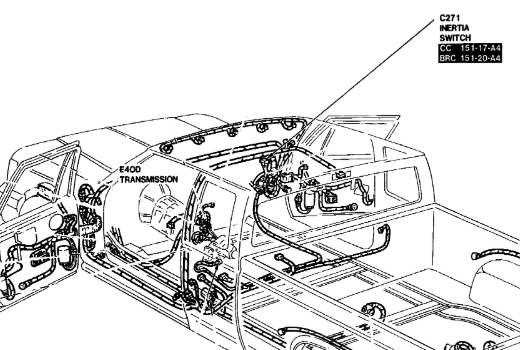

I can help you get it running NP. 6 Volts to the pump is a problem, you must get 12 volts, there is a inertia switch and the fuel pump control relay that must be checked first. Here is the locations, also, make sure the battery has 12 volts as well with the headlights on. This guide can help.

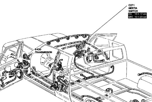

The inertia switch is up by the firewall on the passengers side, this may need to be reset or it just went bad, please check for 12 volts here as well, (one wire), test with the switch unplugged. Here is the fuel pump relay location so you can swap it out. Check out the images (below). Please upload pictures or videos in your response of any problems so we can see what to help you with.
